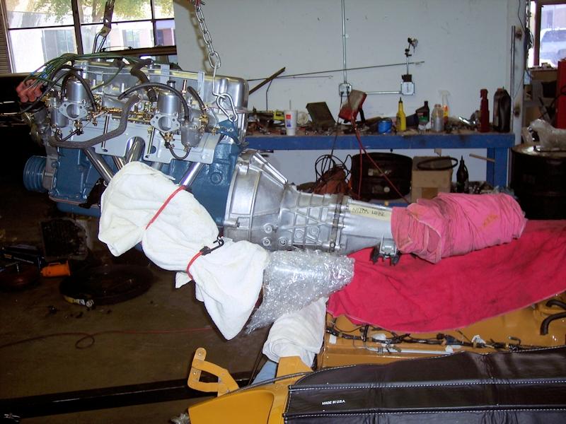

Yes but use lots of packing blankets to protect the paint AND use one of those engine levelers to help make it easier.

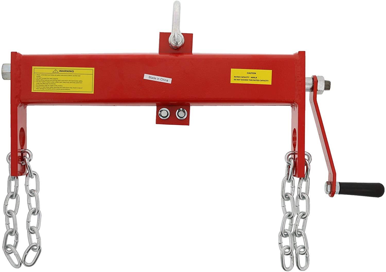

You can do it, no problem if you take your time.  I also used one of these to tilt the engine as it's installed.
I use one of those but I took the handle off and use an impact gun to move the load around
....and make sure the handle end is towards the front of the car. I know a guy that screwed that part up... [emoji51]
Just did that !
