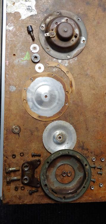

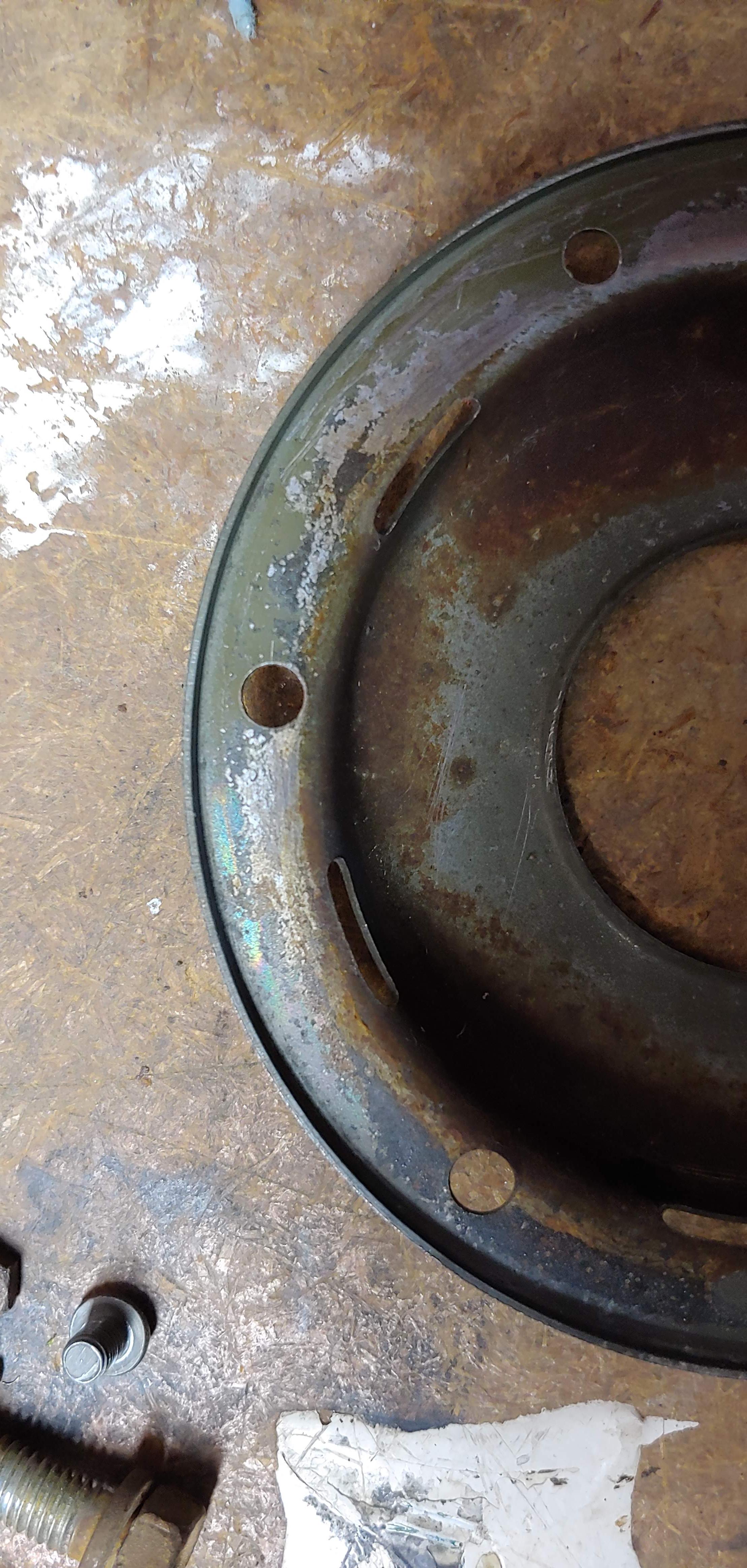

I am in the process of restoring a 6/70 car.  I am curious if anyone remembers what color the factory horns were.  The car was factory white but it was rattle canned white later in life. That is why the overspray in the first pic.  It looks to me as if it was painted black at the same time as the radiator support.  But when I tore it apart, the insides looked like an olive color zinc plating of some kind.  See the second photo at about the 4 o'clock position behind the gasket. Any ideas?

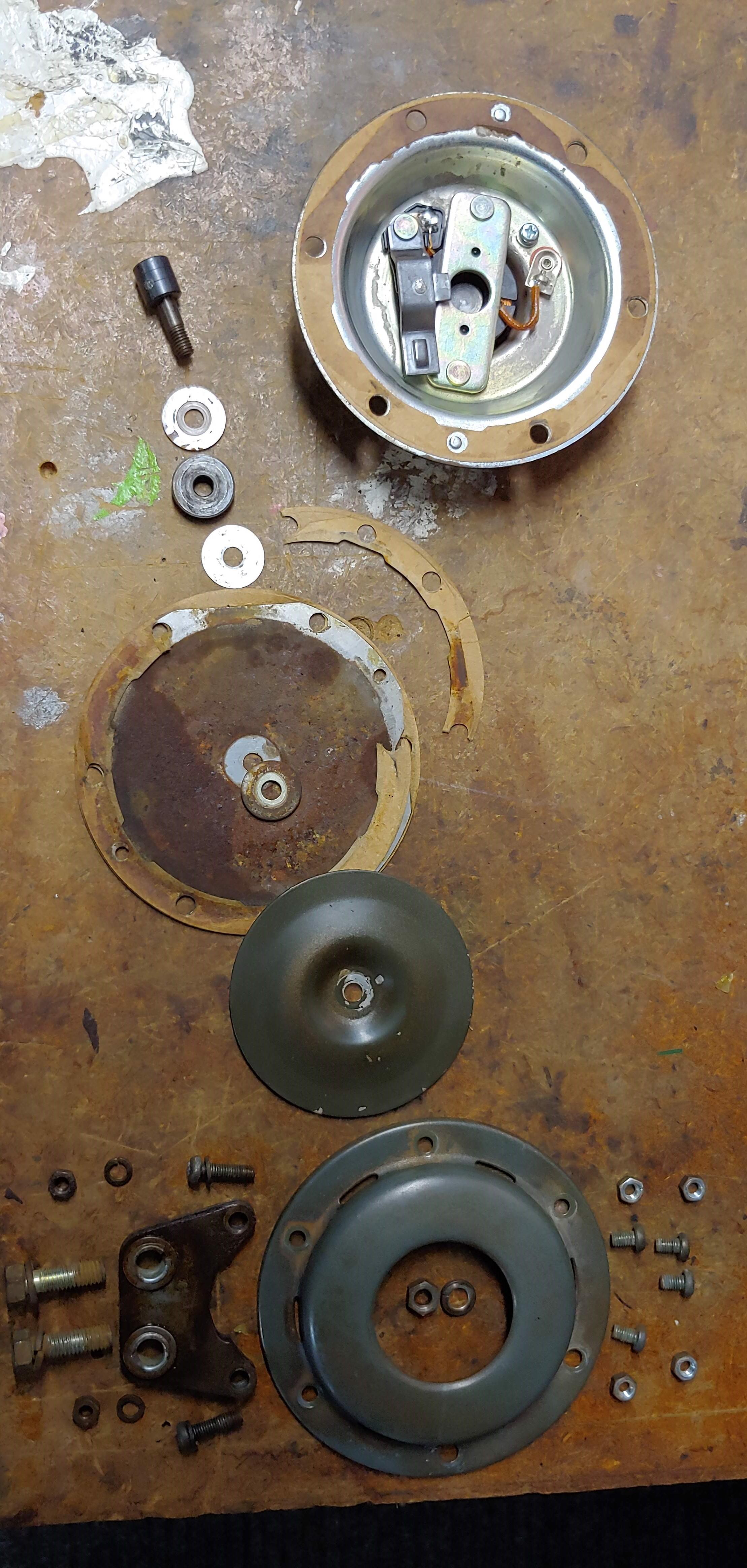

Thanks everyone.  That was helpful. The front, including the disk inside was plated olive green.  So was the nut in the center.  The screws were probably also plated olive green.  The back and the base were clear.

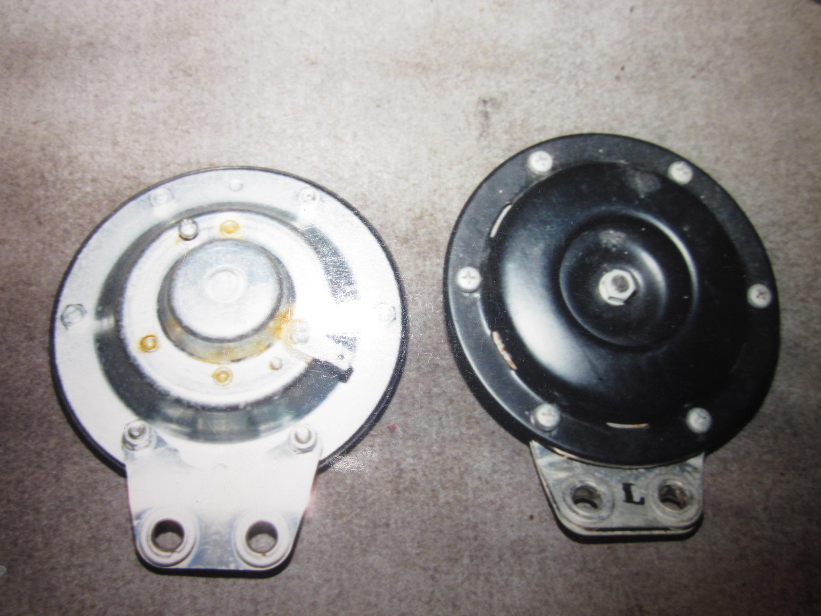

At my shop in my restoration "Bible" I have front and rear pictures I took many years ago of a set of virgin NOS 240 horns. I'll write myself a note to take pixs and post them tomorrow.

I just disassembled one on the horns on my7/70 car. All of the olive green coating is paint over clear zinc plating. The outer front cover has only a very light coat of the olive green paint on the inside and the center disc is painted on the outside only. The center nut and small screws have olive green paint over clear zinc plating. The attached pictures show both sides of all parts as I found them.  The paint seems to sand or scrape off with minimal effort, leaving the clear plating.  The back is clear zinc plated with no paint, and the inside plating has a slight yellow tint.

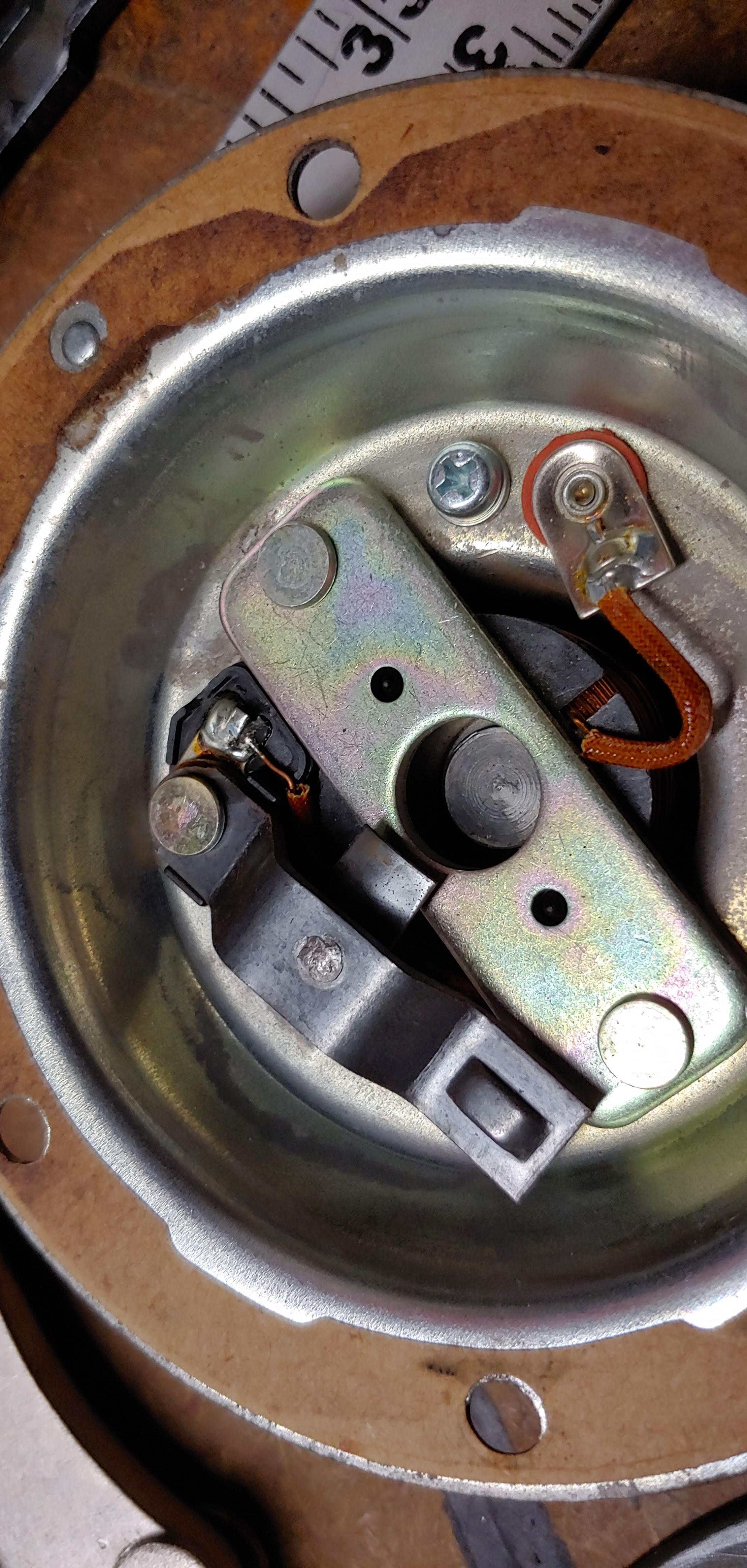

 You may not be able to see it in my photos but on the inside of the front cover where the gasket was, there is a rainbow effect as if it is plating rather than paint.  It is at about the 4:00 position in my second photo.  The outside looks more like paint but mine is in terrible condition.  So it is difficult for me to tell for sure.
I do agree that it is plating, but from what I can see I think it is clear plating, with a slight yellow tint that has the rainbow effect and then olive green paint and overspray on top.  Here are a couple of close up pictures, notice the rainbow areas don't look olive green.  The picture the inside of the back shows the clear plating on the flat areas near the gasket and a light yellowish tint on the curved surfaces and internal parts with some rainbow effect. I believe that all of the horn parts were plated in that manner with some surfaces being painted olive green as a top coat. Just my opinion.

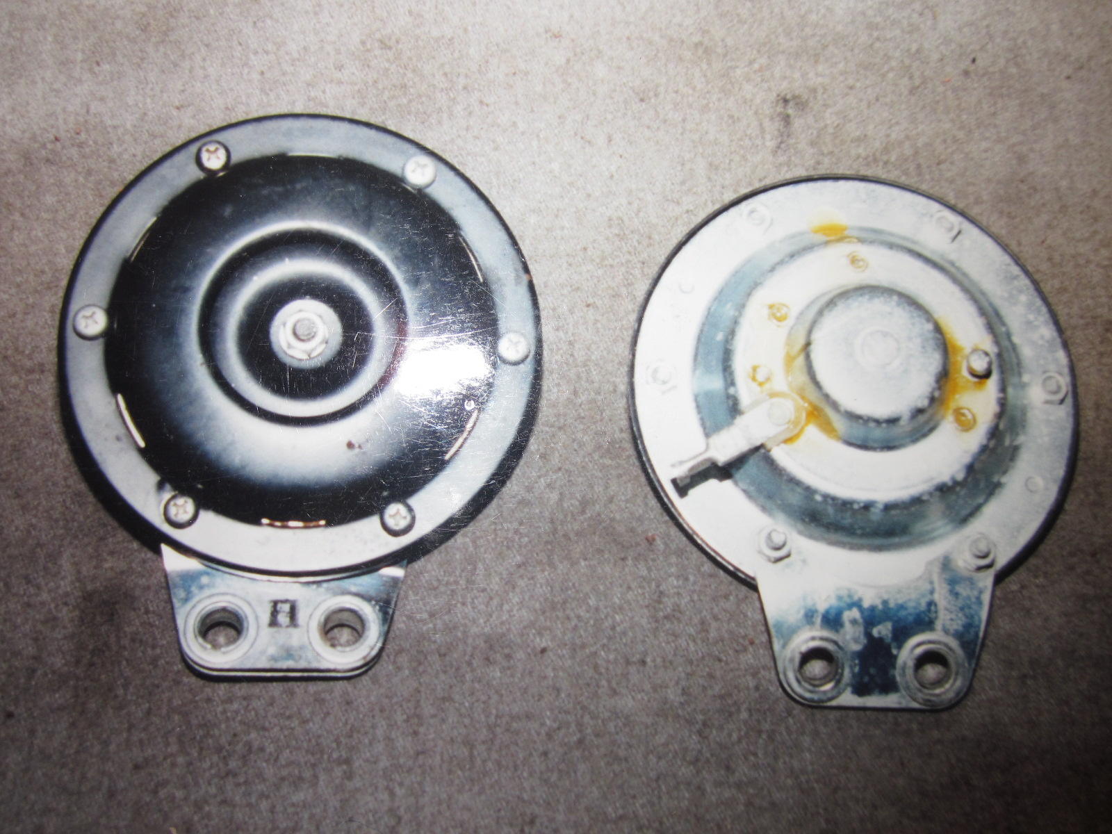

As promised, here are the pictures of a pair of virgin NOS 240 horns. Sorry about the quality, they are a picture of a picture. The shiny stuff is clear zinc and the color is satin black. The yellowy bits are actually poorly applied glue used to secure fasteners.

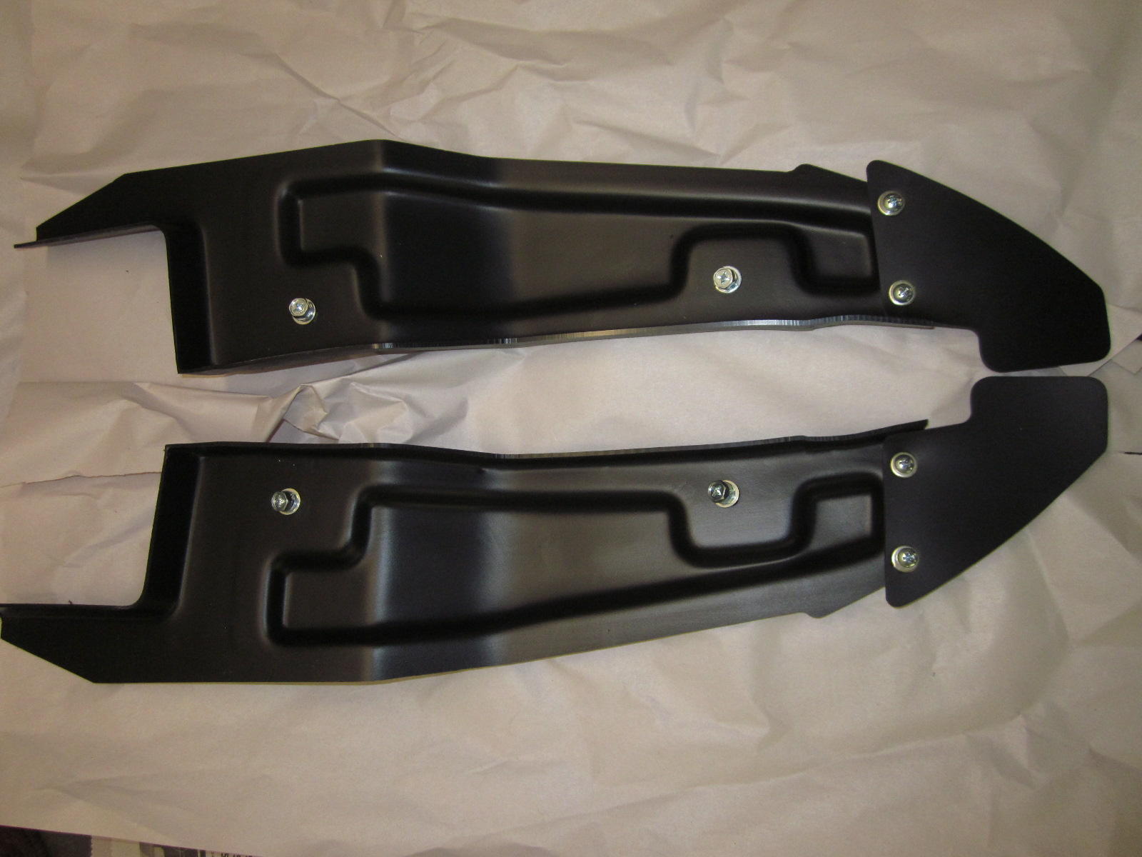

Couldn't help but throw in a snap of my newest product just picked up this am from the manufacturer in beautiful Hollywood, MD. They are a pair of rearmost front inner fender liners for 260/early 280.
