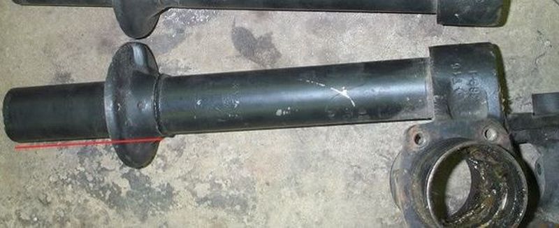

Unfortunately that way of measuring does not tell the whole picture. You can have two strut casings that have the same overall length measurement with the exact same springs and top insulators but still have one side of the car dramatically higher than the other.
How?  It is the height positioning of the lower spring perch on the strut casing that affects ride height. And Late 260z and 280Z spring perches are NOT located in the same place as 240Z spring perches.
Think of a Coil over. The spring perch is on a threaded sleeve. You can crank one side  up or down and that raises or lowers that corresponding corner. You will only notice this when the suspension is LOADED with the weight of the car on the suspension. The " over-all " length of the strut housing may be them same, but depending on where the lower spring perch is adjusted that will affect ride height
Measure both rear struts from the lower spindle pin center-line to the weld mark on the lower spring perch.  That distance should be exactly the same. It does vary on different struts housing. I suspect that when you make this measurement, you may find that you have two different strut housings. You can have two strut housing that have the same " over-all length", and yet the lower spring perch is welded on at a different height.
While you have things apart. Physically remove the top insulators and measure them for thickness. Also examine the inner structure and make sure that the rubber has not separated. I think people have already asked you to do this and it must be checked. Do not " assume " they are correct, even if they are brand new. Parts get mislabeled or can be defective even when brand new.
And lets be clear on naming convention. Shock absorbers are not struts.... they are shocks. The shock absorber goes inside the strut or strut housing. This will avoid confusion.
So, please measure both strut housings from the center of the spindle pin to the weld mark on the lower spring perch. post that dimension. Then measure from the center of the spindle pin to the top of the strut housing where the gland nut threads in. Post that dimension. Both strut housing should measure up exactly the same when you measure it that way.
