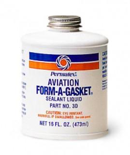

Dry is fine but other options that are also fine are:
  • Aviation Form a Gasket ( @siteunseen)
  • Copper Spray a Gasket (My fav)
  • Silver Paint
  • Anti-seize brushed on
They seal and allow for easy removal.
