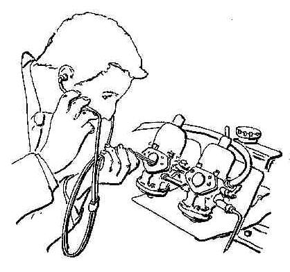

Chickenman Posted March 31, 2017 Share #12 Posted March 31, 2017 (edited) Edit: Dang Capitano Obvious beat me to it while I was downloading fancy pictures. I concur with CO. What happens when you Rev the engine rapidly? Does the rear piston lift and the engine respond halfway decent? You may just have the front and rear carbs really out of balance. Throttle blade wise. Rear throttle blade closed at idle...= no airflow = no fuel draw = no idle difference when piston lifted manually. happens all the time on Triples and happens on SU's as well. Do you have a Carb balancing tool? Edited March 31, 2017 by Chickenman Link to comment Share on other sites More sharing options...
