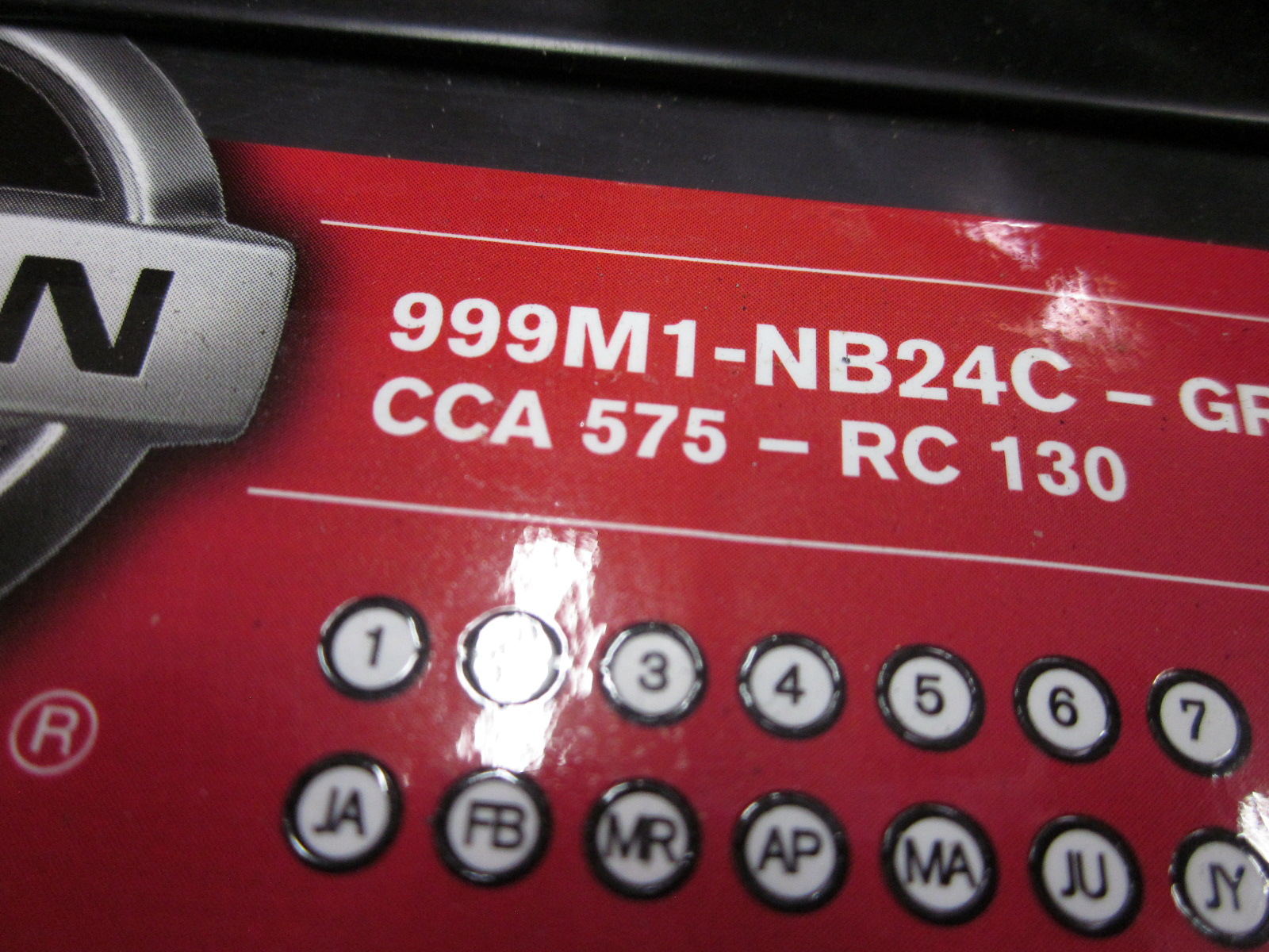

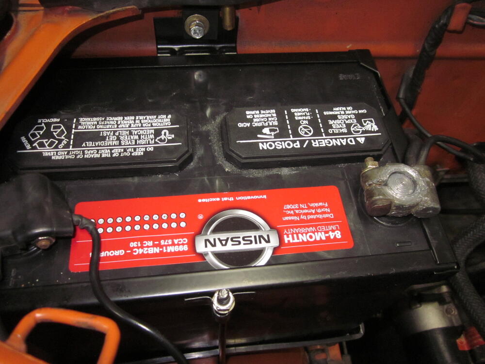

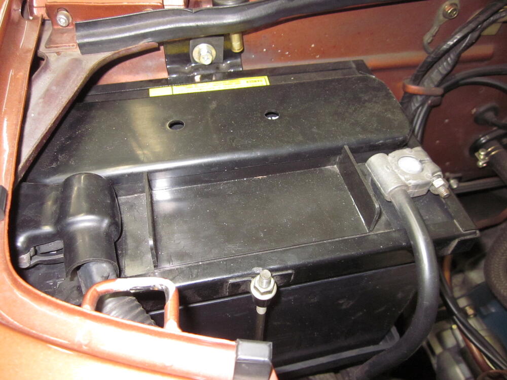

zspert Posted September 11, 2021 Share #5 Posted September 11, 2021 Come Mon I'll take a picture that will include the Nissan part # and show the fit using the correct factory hardware. Link to comment Share on other sites More sharing options...

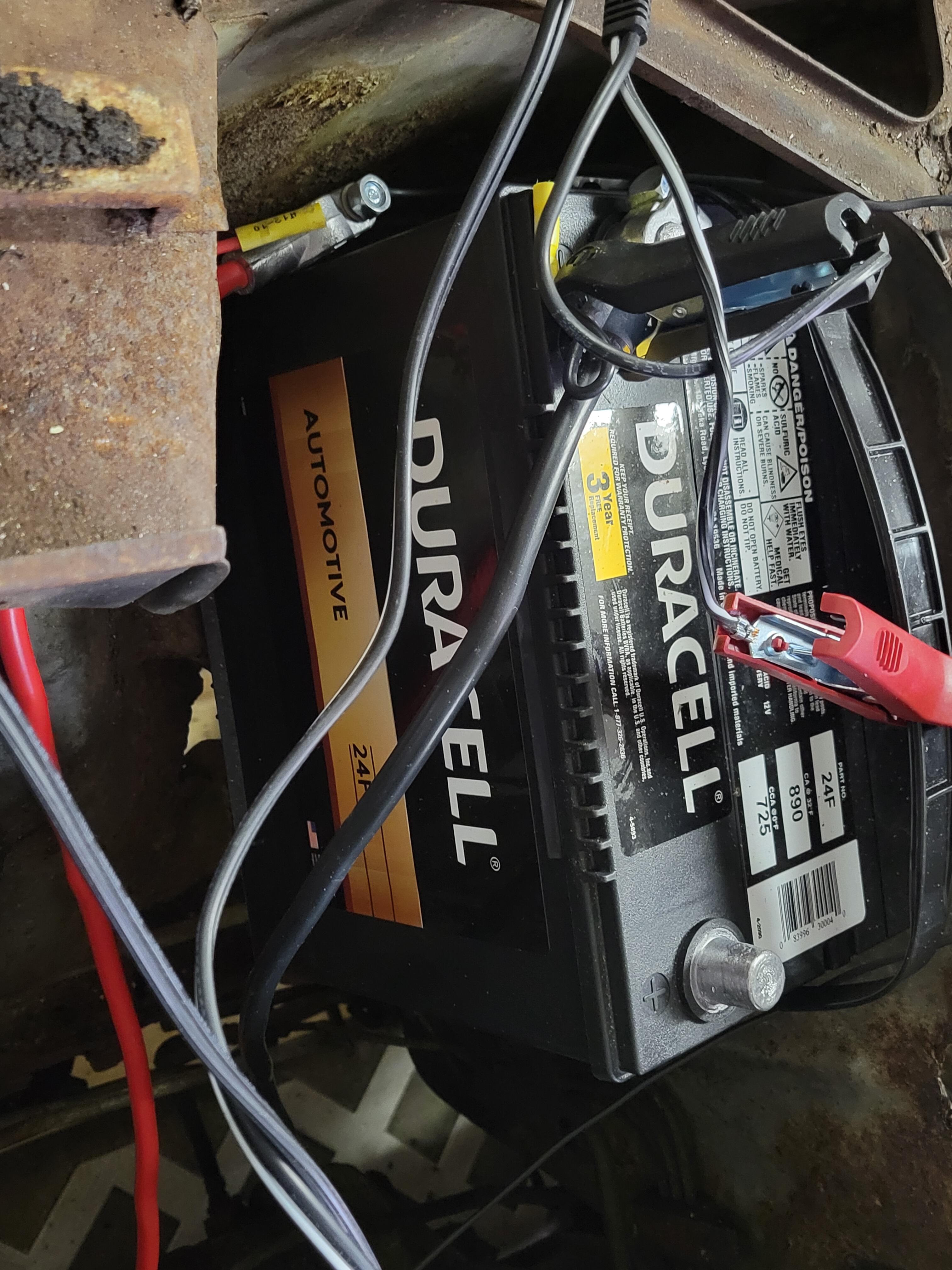

ennisdavis Posted September 12, 2021 Author Share #8 Posted September 12, 2021 The battery i bought is a group 24, 8 1/2" to top of plastic on battery. Its sitting on the steel tray. Still looks really close to chassis. Link to comment Share on other sites More sharing options...
ennisdavis Posted September 12, 2021 Author Share #9 Posted September 12, 2021 Link to comment Share on other sites More sharing options...
zspert Posted September 14, 2021 Share #10 Posted September 14, 2021 If you want to have the latest in battery technology regardless of fit or if you're satisfied with the hold down parts you bought at your local auto parts store what I'm writing won't be of interest to you. If, however, authenticity is paramount then the following will, I hope, help you reach your goal. The correct Nissan battery for your 240/260/280 is still available from your local dealer for not much more than you would pay at your local Auto Parts Inc. Yes, you will have to saw off the brackets that secure the plastic lifting handle, a 3 minute job. Afterwards the battery will conform comfortable with all the correct factory hold down parts, also still available from Nissan. That is, save the firewall insulator and related fastener. Those are available from Banzai Motorworks. Of course I'm not including the Holy Grail battery covers. 2878 - 1972 240 2879 - 1978 280 1 Link to comment Share on other sites More sharing options...
Zed Head Posted September 14, 2021 Share #11 Posted September 14, 2021 On 9/12/2021 at 4:23 PM, ennisdavis said: The battery you have has a common change that people make. You have swapped polarity on your terminals. Negative close to the chassis is not an electrical issue just a convenience issue. The factory setup has positive right next to the chassis for the occasional spark adventure. Some people even switch to side-posts screw type terminals. So you're off-spec. already anyway. But if you're worried about sparks from that close terminal it's not a concern. That's the negative terminal, it's already grounded. Link to comment Share on other sites More sharing options...
SteveJ Posted September 15, 2021 Share #12 Posted September 15, 2021 On 9/13/2021 at 10:57 PM, Zed Head said: The battery you have has a common change that people make. You have swapped polarity on your terminals. Negative close to the chassis is not an electrical issue just a convenience issue. The factory setup has positive right next to the chassis for the occasional spark adventure. Some people even switch to side-posts screw type terminals. So you're off-spec. already anyway. But if you're worried about sparks from that close terminal it's not a concern. That's the negative terminal, it's already grounded. Actually, I had a 24F in my 240Z a long time ago and made the mistake of driving it without having the battery fully secured. When I made a right turn, the battery moved left, and the positive post contacted the engine. Fortunately, I put out the electrical fire before the car burned up. I am all for using the 24 instead of the 24F based upon my personal experience. 1 1 Link to comment Share on other sites More sharing options...
