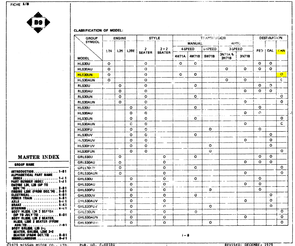

Early Canadian market 240Z's had no vapor tank either, until about 9/70 I believe. They were known as non-emissions models, HLS30UN. Here are a couple of pictures of my 7/70 Canadian car showing the original vent hose routing without a vapor tank. The hose tee's off the tank vent hose going straight up and then loops back down going through a hole in the floor behind the plastic trim panel.

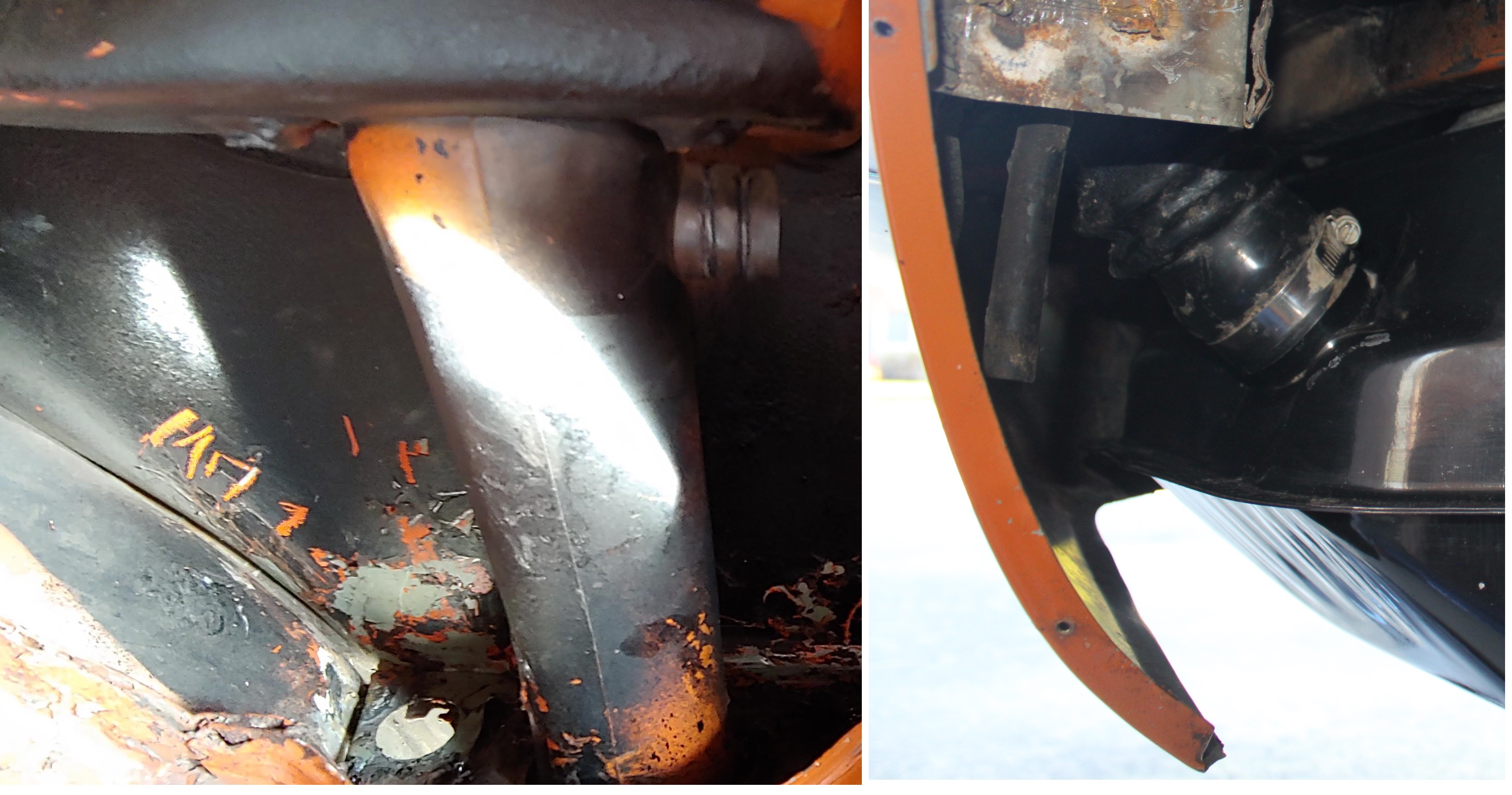

Getting rid of the tank seems to be pretty simple, too bad everything else needs to be plugged off.
The hose that broke off is the one used to T into the filler neck (It's the largest one of the 3).
The hose that vents outside looks to be a larger diameter than the existing line.
I would have to cap off the outlet at the far end of the tank and the one above the fuel level sensor.
The existing hose is in ok condition so I wont have to deal with the 180 bend.
I think I need to get a 3/4" to 5/8" barbed fitting to go into the filler neck.
5/8" is too small for the filler neck as shown here.
Then I would need a 5/8" T for the existing line and the new line that would go outside.
To plug off the existing lines. I was thinking of just going the easy/non permanent route, and plug the ends of the hoses inside the car.
A threaded brass plug with a clamp is what I was thinking.
