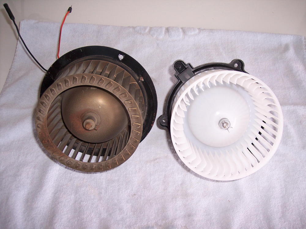

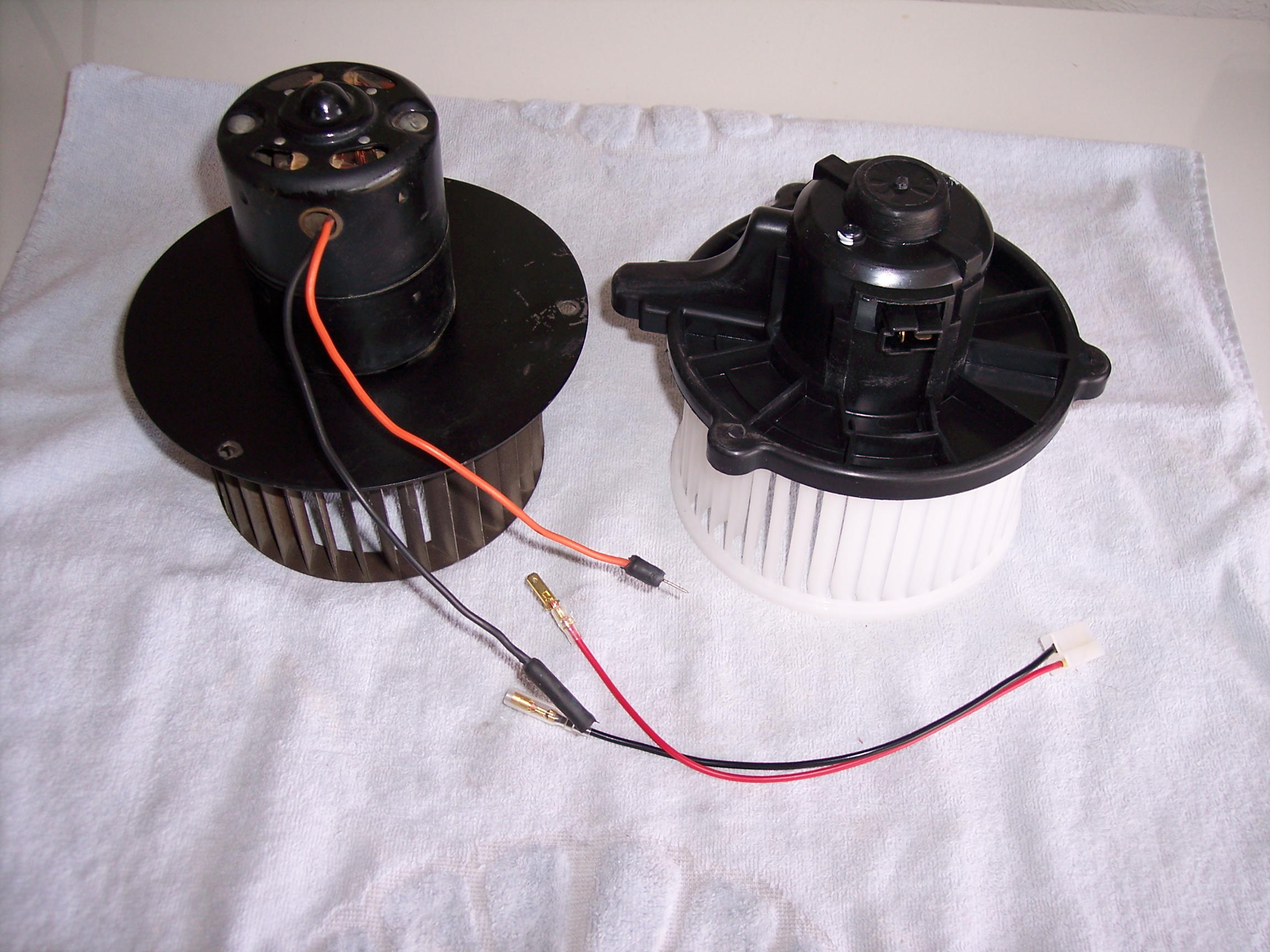

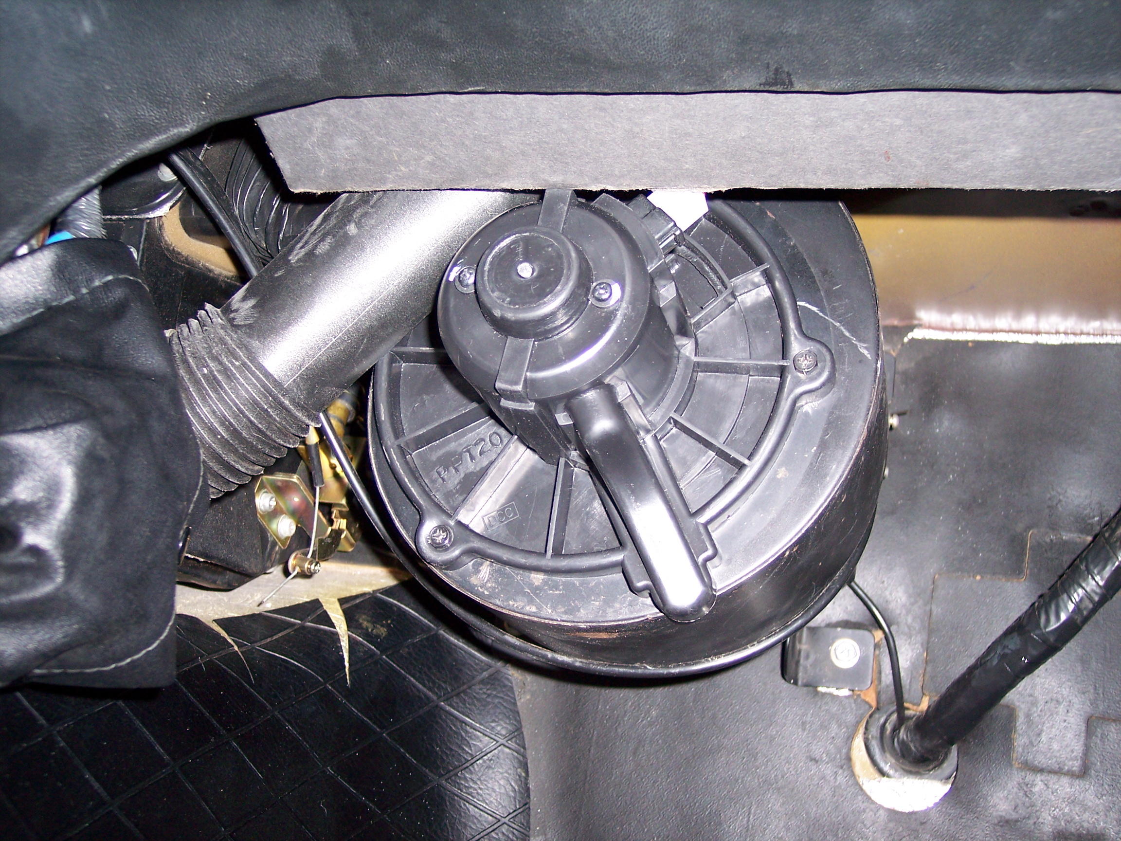

A good buddy @chaseincats put me onto this upgrade last year, he originally found it over on HybridZ.  The replacement motor and fan comes from one of our favorite donor cars - a '99 Kia Sportage.  He pulled one from a salvage car and installed it into his 280Z. Yes, the housing needs a 1/16th trim all around the opening but that is the only mod.  His electrical plug was a direct fit.  For my 240Z, the OE motor is hardwired  with a spade and bullet fitting.  Another buddy recently did the same upgrade for his '72 resto project and he put together a jumper for me with the correct plug for the motor and the spade and bullet for my harness.  Grinding out the housing with everything still in the car is a bit of a PITA (I'm getting too old for this crawling around!), but everything came together well.  The new fan puts out lots of air and is super quiet.  A new motor with fan is available at Rockauto for $35 if you not inclined to hit a salvage yard, as in my case.

The blower works/fits all s30s.  If you have a 280z, the power connector is plug and play (but with series 1 240s, the connector to the blower motor needs the adapter @jfa.series1 fabricated).
While the 280z's blower motor is beefier than the 240's, the sportage motor handily eclipses both.  In my '78 280 for example, the level 5 fan speed setting with the original motor is roughly equivalent to level 3 using the sportage motor.  These things move A LOT more air and are way quieter like Jim was saying.
