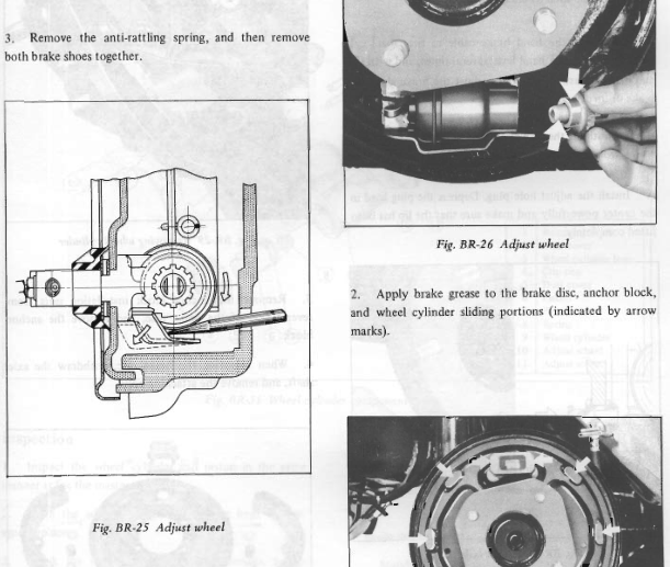

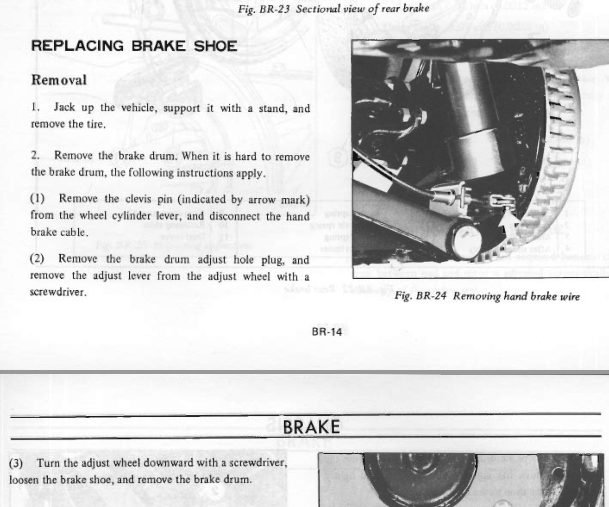

Can you get to and turn the adjusters?
You might be out there beating, burning, and torturing things but make sure you do what Patcon suggested first,

As @Patcon suggested work on the adjusters and try to make sure they are retracted.
Keep it up with the block of hardwood and big f'in hammer. They can be a bear to remove, but should eventually break free. I hope you don't damage the fins--the finned cast aluminum drums are another neat aspect of our Z's.
I got one off. Now the other side.  Do you access the adjuster through the hole in the front of the wheel?

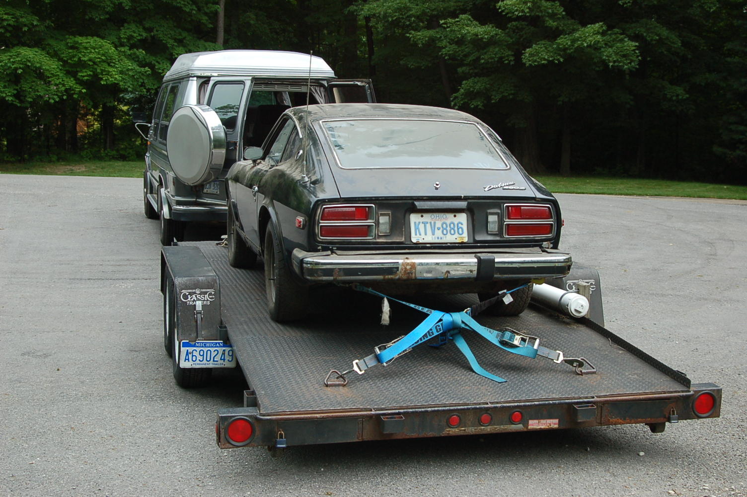

LOL.  I bought the car in 1992 for $500 as a beater/parts car and drove it for about six months before parking it in my dad's garage.  Over the years, the garage roof rotted and leaked near where the car was parked so the garage was really damp all the time.  He built a nice new pole barn in about 2001 and the car was dragged (due to the locked rear brakes) into the new garage at that time.  I decided to retrieve the car in 2009 as a donor car for my race car build.  We stripped the good parts and cut the car up for scrap metal a few weeks after these pics were taken.  When we cut the car up, the RH side of the firewall was so rotten that we didn't even have to cut it.  The car literally had no good metal from the windshield to behind the seat on the RH side.

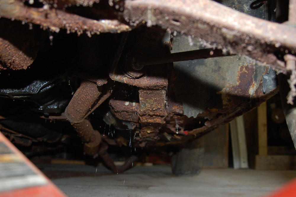

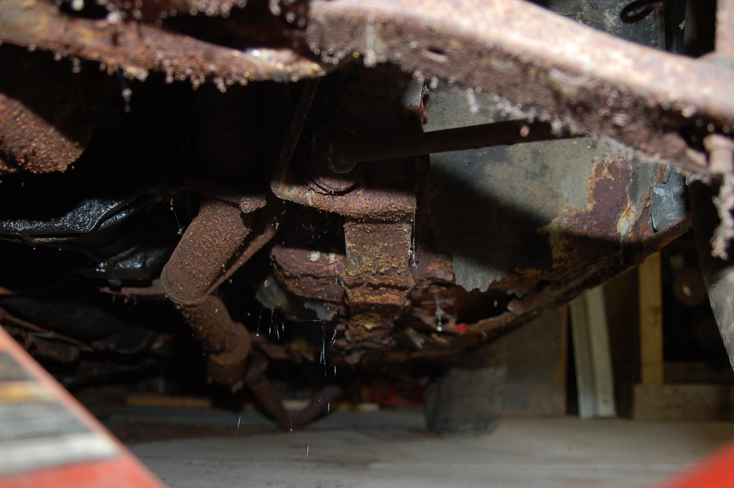

Here's how bad the rot actually was in the car.  From the outside, it didn't look all that bad, but the underside looked like it had been on the Titanic.
