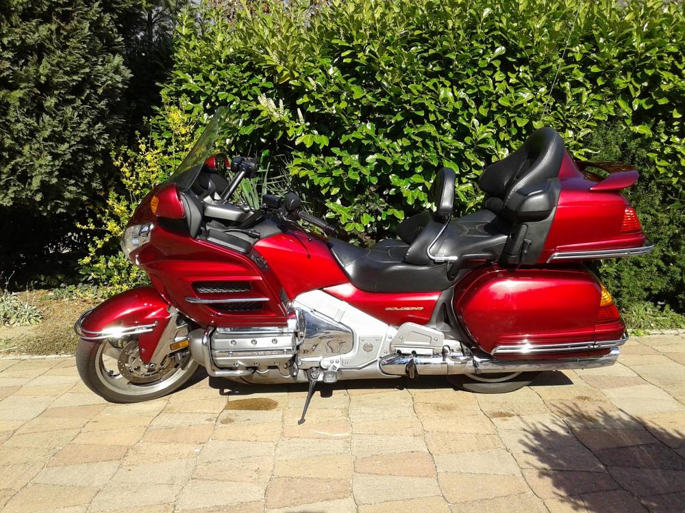

dutchzcarguy Posted November 7, 2020 Share #97 Posted November 7, 2020 18 hours ago, Racer X said: I would use a bike lift for bikes, much easier to securely and safely raise a bike for repairs and maintenance. Uhm.. I don't have the space in my garage for another machine.. i got a GoldWing of over 900 Lbs.. (410-425Kg) !! And a 4 post is ideal for service on a GoldWing.. 18 hours ago, Racer X said: 4 post lift isn’t big enough to lift my Dodge Ram 3500 dually, Would that dodge fit on my 4 post? it's over 5,5 ,mtr long. (that's over 18 foot long.. ) But i'm sure the roof would get in the way because i always lift low sportscars! Link to comment Share on other sites More sharing options...

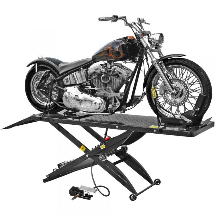

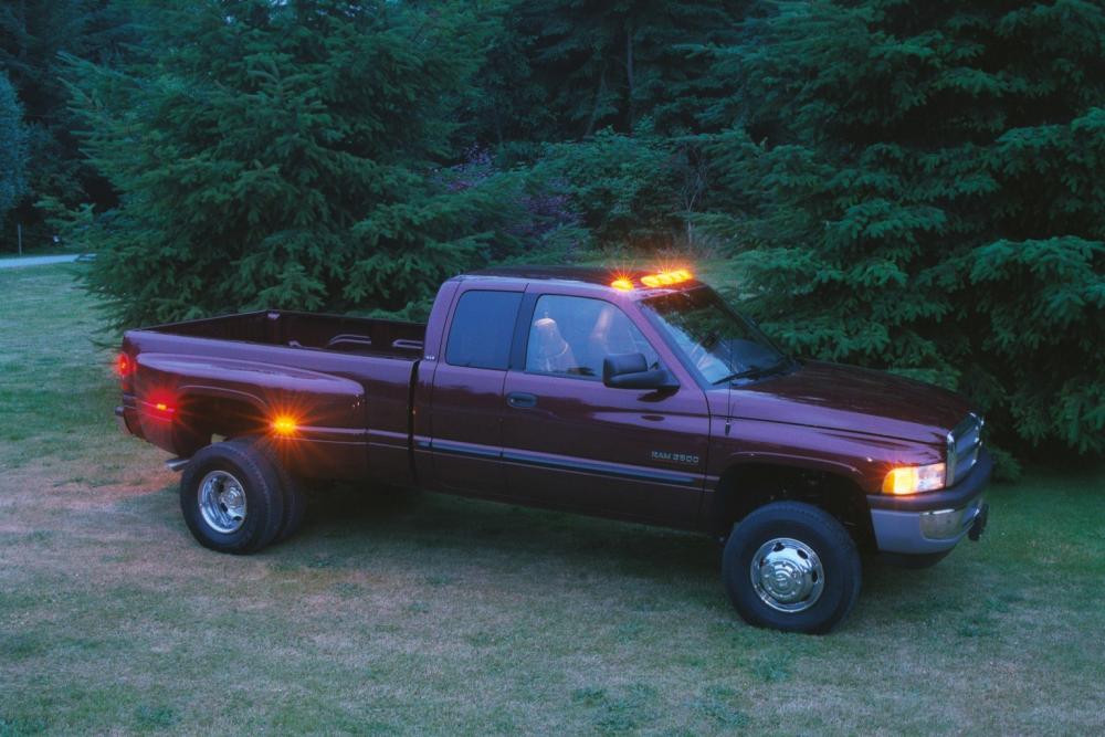

Racer X Posted November 7, 2020 Share #98 Posted November 7, 2020 (edited) 1 hour ago, dutchzcarguy said: Uhm.. I don't have the space in my garage for another machine.. i got a GoldWing of over 900 Lbs.. (410-425Kg) !! And a 4 post is ideal for service on a GoldWing.. Would that dodge fit on my 4 post? it's over 5,5 ,mtr long. (that's over 18 foot long.. ) But i'm sure the roof would get in the way because i always lift low sportscars! Nice bike. A dedicated bike lift is about 3 feet wide, and about as long as your Goldwing. It with also have a place for the front wheel to hold the bike securely, something a 4 post car lift doesn't have. Something like this: My Ram weighs around 8,000lbs or so empty, so I would need at least a 10,000lb lift, and a minimum ceiling height of 12 feet. My 4 post lift is too narrow, not long enough, and doesn't have the lifting capacity for the weight of the pickup. New Ram by Racer, on Flickr Edited November 7, 2020 by Racer X 2 Link to comment Share on other sites More sharing options...

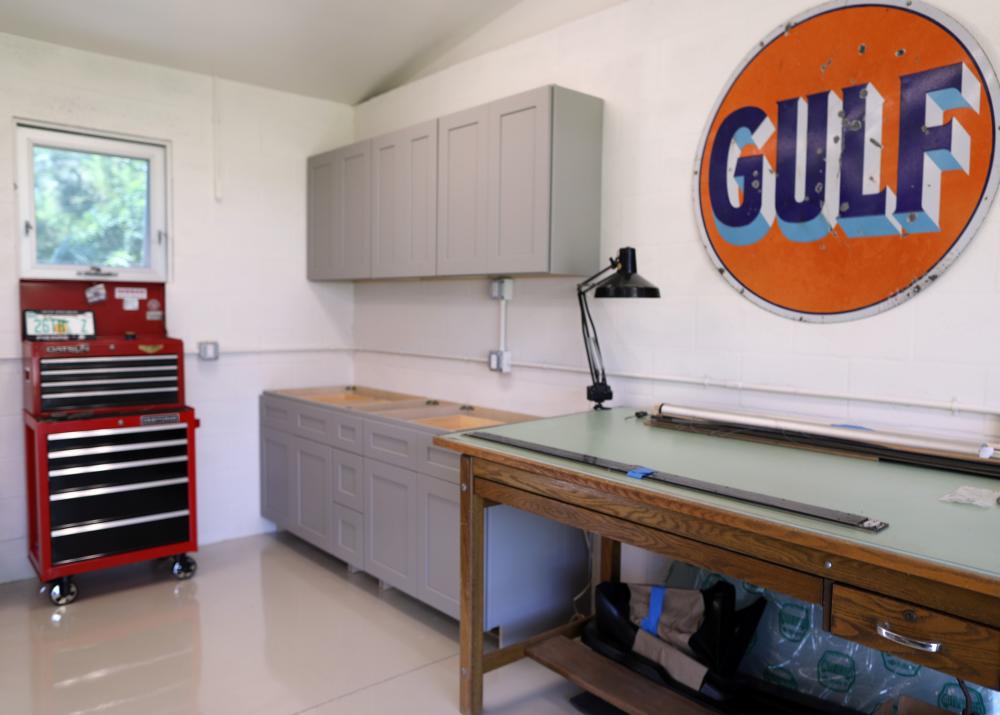

Popular Post 26th-Z Posted May 15, 2021 Popular Post Share #102 Posted May 15, 2021 Installed cabinets this morning. My old work bench frames got trashed and I got a great deal on these all plywood cabinets. 7 linear feet of uppers and lowers. Will make a great work bench. I still have to install the tops which are Corian. The epoxy floor is holding up very well, however it will scratch and it doesn't protect from hard scrapes and jabs that would mark any concrete floor. Because of the light color, dirt shows up easily but I wanted that to know that the place was clean. 5 Link to comment Share on other sites More sharing options...
Racer X Posted May 15, 2021 Share #103 Posted May 15, 2021 14 minutes ago, 26th-Z said: Installed cabinets this morning. My old work bench frames got trashed and I got a great deal on these all plywood cabinets. 7 linear feet of uppers and lowers. Will make a great work bench. I still have to install the tops which are Corian. The epoxy floor is holding up very well, however it will scratch and it doesn't protect from hard scrapes and jabs that would mark any concrete floor. Because of the light color, dirt shows up easily but I wanted that to know that the place was clean. A drafting table! Nice. I worked as a draftsman back in the days when the only computer was my HP33c scientific calculator with reverse polish notation (no equals button). Link to comment Share on other sites More sharing options...
26th-Z Posted May 15, 2021 Share #104 Posted May 15, 2021 (edited) Thanks. That's my pride Mayline oak table that I've had for twenty years or so. I also have a matching 10 drawer flat file. Edited May 15, 2021 by 26th-Z 2 Link to comment Share on other sites More sharing options...

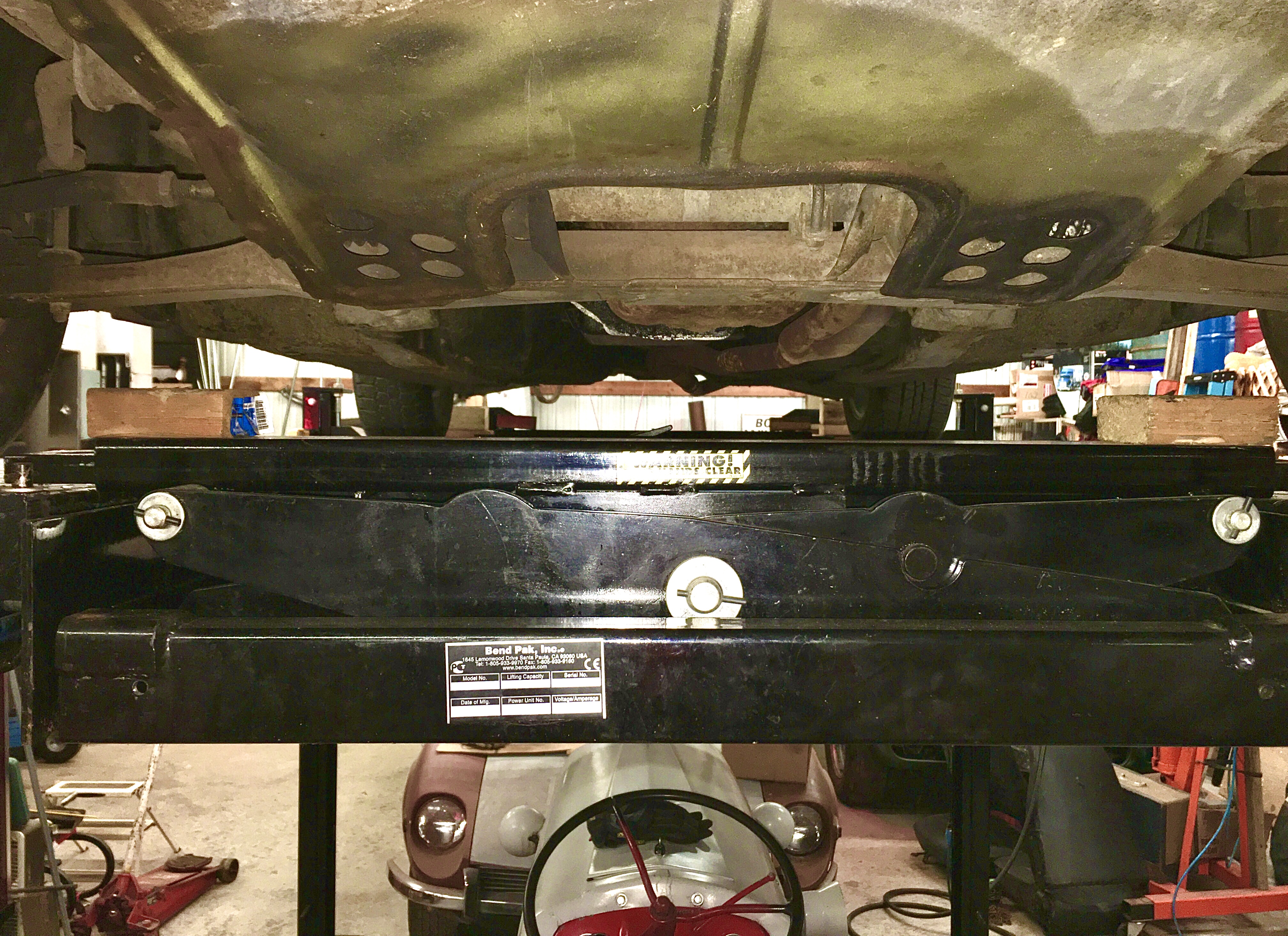

Racer X Posted May 16, 2021 Share #105 Posted May 16, 2021 On 11/6/2020 at 6:22 AM, Marty Rogan said: What brand is your lift, and do you like it? Sorry I took so long to reply. The lift is sold by Bend Pak, but isn’t branded. I added jacks that roll forward and backward to allow wheel end work. It is great for maintenance and service work, I also have a transmission jack for doing transmission and clutch work. Link to comment Share on other sites More sharing options...

Jeff G 78 Posted May 17, 2021 Share #108 Posted May 17, 2021 On 5/15/2021 at 9:47 AM, 26th-Z said: Installed cabinets this morning. My old work bench frames got trashed and I got a great deal on these all plywood cabinets. 7 linear feet of uppers and lowers. Will make a great work bench. I still have to install the tops which are Corian. The epoxy floor is holding up very well, however it will scratch and it doesn't protect from hard scrapes and jabs that would mark any concrete floor. Because of the light color, dirt shows up easily but I wanted that to know that the place was clean. Your cabinets look just like the uppers I put in my garage this weekend. The garage in the house I just bought only has one outlet and I have three workbenches that wrap around four walls. I like what you did with the exposed conduit. I might have to do something very similar. With a slab on grade house, all power is under the house, so grabbing more power from the panel is much harder than I'm used to. I like the drafting table too. I grew up drafting and I still love doing manual drawings. 1 Link to comment Share on other sites More sharing options...
