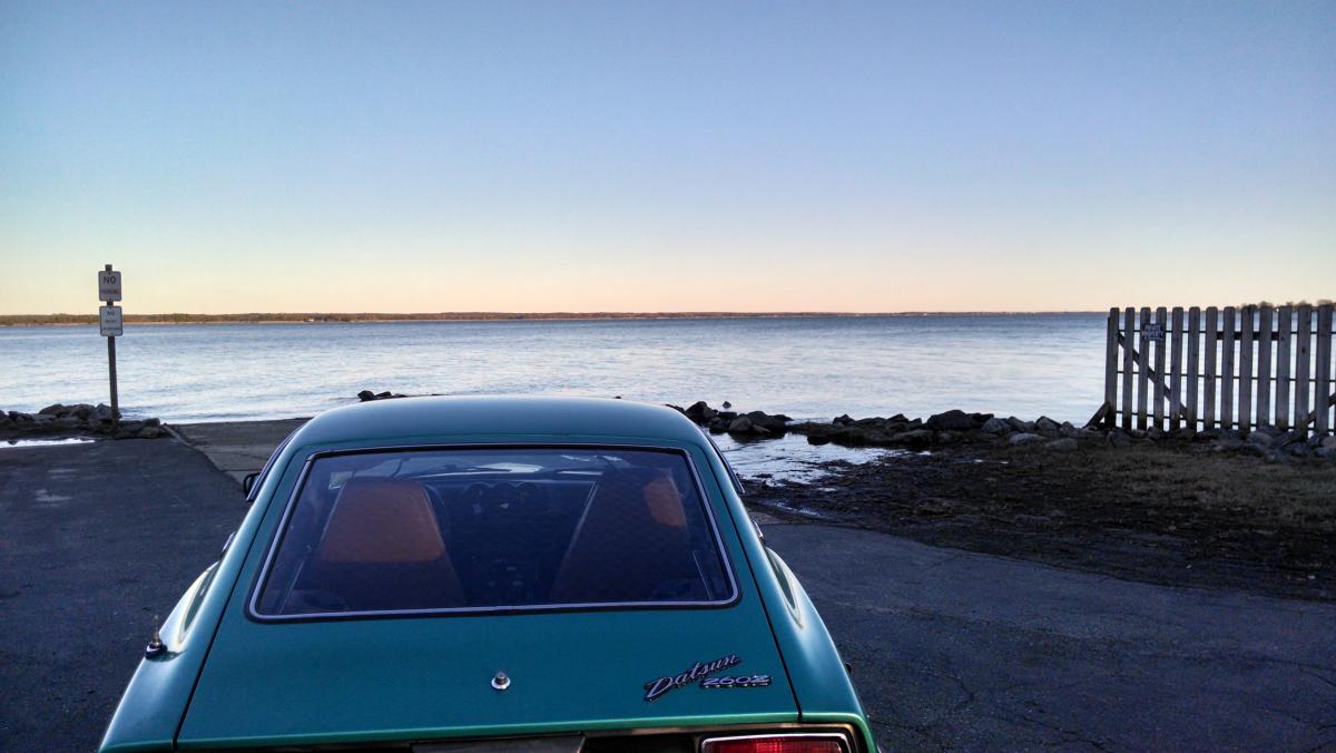

after a 3-year absence my 260 is now off the lift and back on the road with a fresh rebuild of the motor and carbs.
any thoughts on what mpg numbers i should be seeing?
stock 2.8L, bored .020
Round-tops
5-speed
