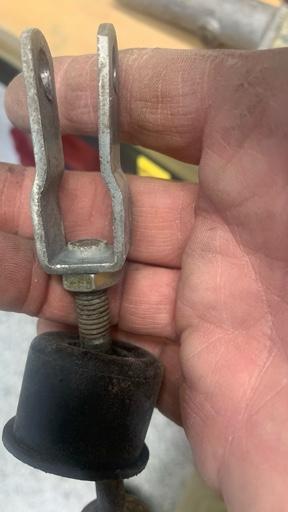

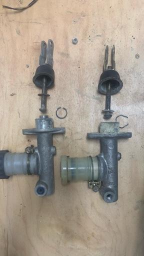

So digging through my bins of parts that came with the car I found two old Clutch Master Cylinders. This car has gone few several over its life it seams.
I took some pics of them and I’ve come up with an idea for an easier install. You see that the shaft that connects to the pedal is easily removed with the a retaining collar. I can use the shaft in the car now and just take the new one off the new master. If there is sufficient room to get the collar on it would negate the Jiu-Jitsu maneuvering under the pedal. All I need to verify is the shaft length is correct. The Clovis pin is pretty new so that’s not going be be worn.
Option 2, would be to unscrew the shaft from the u-shaped bracket that goes around pedal. I could spin the entire assembly until it’s at the proper length and then bolt the master to the firewall. I think this was one of Captain Obvious’ idea.
See pics, bottom one is an OEM Nabco. Still have to remove one from the car.
Another thing that I found that works on both the clutch and the brake is that you can use a pair of pliers to spin the rod without removing the clevis pin.  Just loosen the lock nut, grab the rod with the pliers and spin it a quarter turn at a time.  The end in the booster or clutch master is free to spin.  You can gauge proper tightness by how the clevis pin wiggles in the hole.  I just adjusted mine up until it was almost tight, to give maximum travel, and no pedal play.  Much simpler than taking measurements, taking the pin out, and spinning the clevis.
