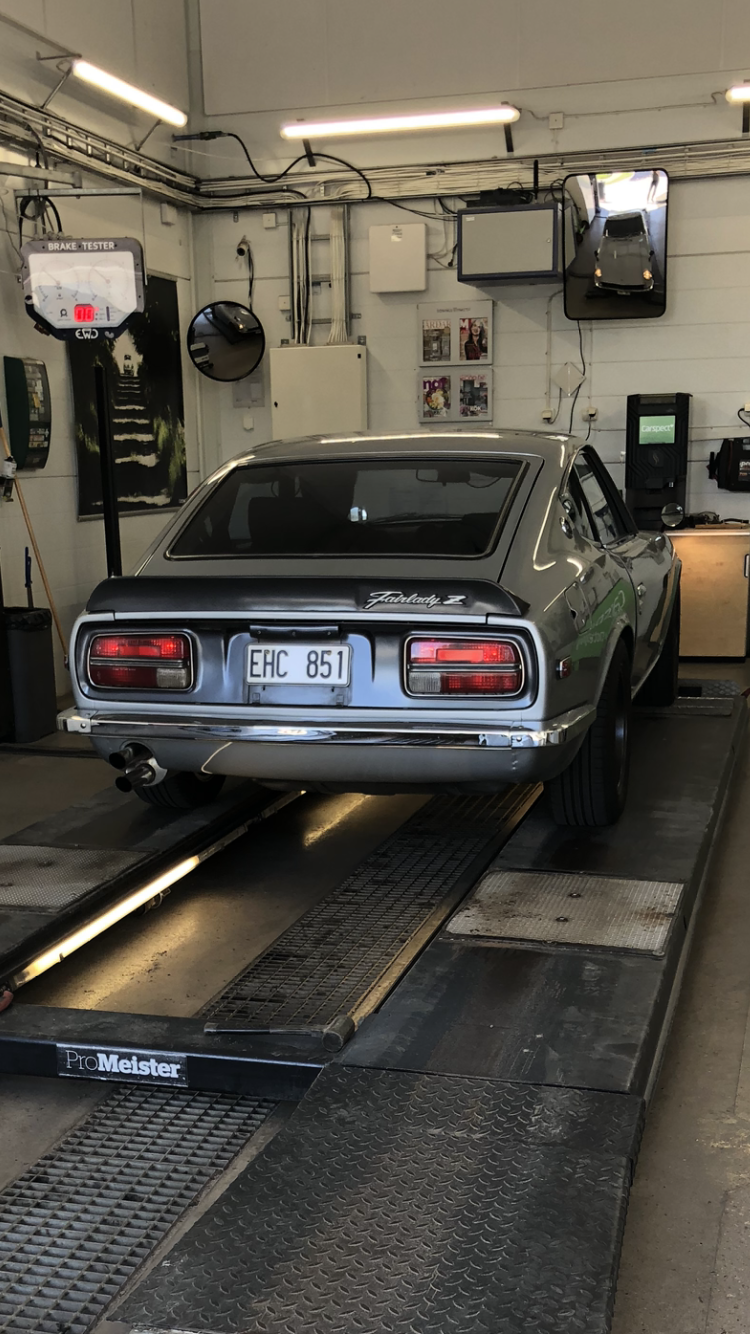

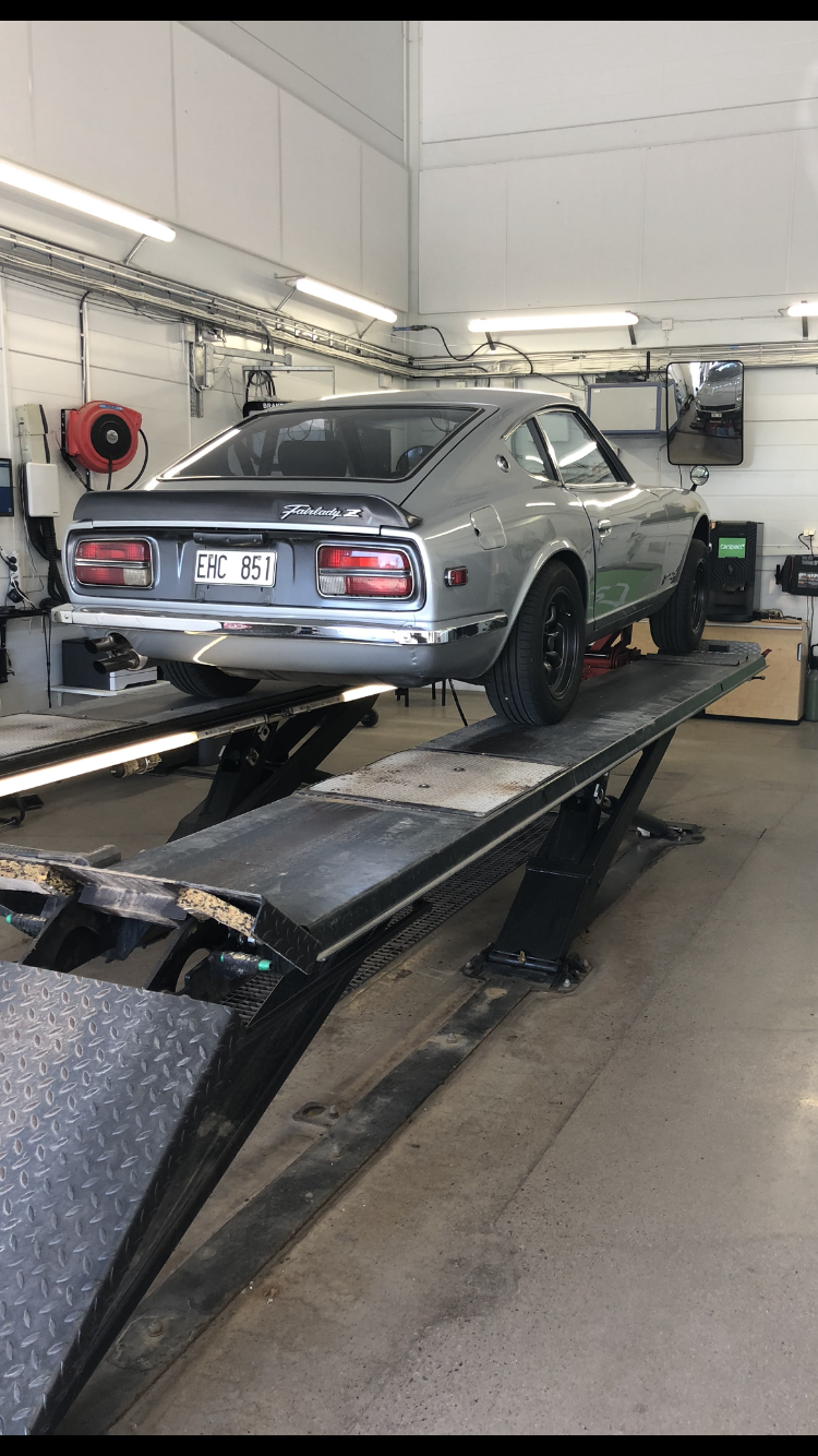

May 21, 20213 yr comment_621923 Past inspection with flying colors, a tad high CO but I was allowed to tune the carbs a bit so no problem. No more inspection needed here in Sweden for this car 1973 so that’s good. Link to comment https://www.classiczcars.com/forums/topic/64911-2021-what-did-you-do-towith-your-z-today/?&page=3#findComment-621923 Share on other sites More sharing options...
May 21, 20213 yr comment_621927 You need to put that next inspection on your calendar 1/1/2099! Link to comment https://www.classiczcars.com/forums/topic/64911-2021-what-did-you-do-towith-your-z-today/?&page=3#findComment-621927 Share on other sites More sharing options...
May 21, 20213 yr comment_621930 1 hour ago, Patcon said: You need to put that next inspection on your calendar 1/1/2099! Yes, Wouldn’t wanna miss that😅 Link to comment https://www.classiczcars.com/forums/topic/64911-2021-what-did-you-do-towith-your-z-today/?&page=3#findComment-621930 Share on other sites More sharing options...

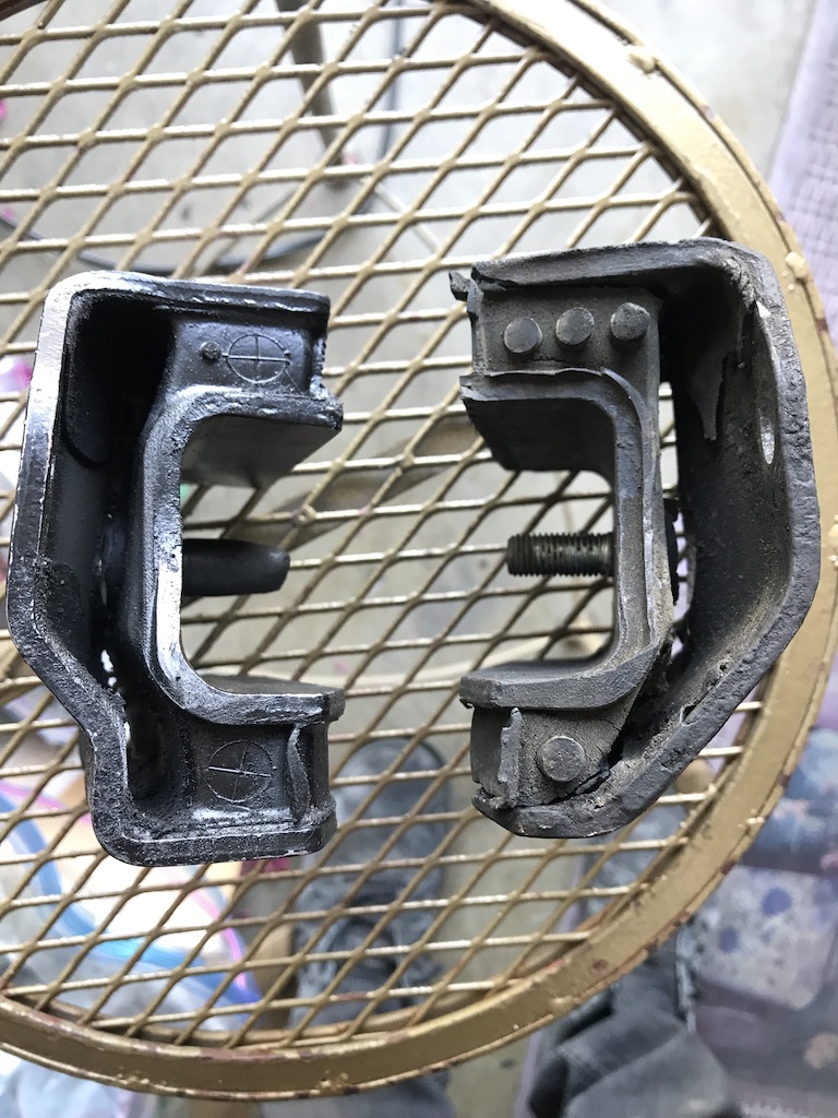

May 23, 20213 yr comment_622004 I've been trying to track down some resonant vibrations in the car that happen at ~62-68 MPH. It feels like the hatch vibrating away on something, maybe its the precision seal thats not letting the hatch sit? I dont see any wear marks. Only feel the resonance on the hatch panel. I replaced the diff fluid, went from 75w-90 to some 80w-90 that i had in the shed. I pulled the driver side axle to inspect the u-joints, i removed the u-joints to inspect for any binding, reinstalled the u-joints. I then sat around and though about what else could be the problem and realized I had a new diff mount in my parts pile, so i replaced that as well. The resonance has somewhat been reduced, but its still present...😞  Link to comment https://www.classiczcars.com/forums/topic/64911-2021-what-did-you-do-towith-your-z-today/?&page=3#findComment-622004 Share on other sites More sharing options...
May 23, 20213 yr Popular Post comment_622012  I chased a resonance problem years ago. I started by replacing all the u-joints. No luck. The half shafts didn't spin fast enough to produce my vibration. I had the drive shaft balance checked and they found it was slightly bent. They re-tubed the drive shaft and the vibration disappeared. Link to comment https://www.classiczcars.com/forums/topic/64911-2021-what-did-you-do-towith-your-z-today/?&page=3#findComment-622012 Share on other sites More sharing options...

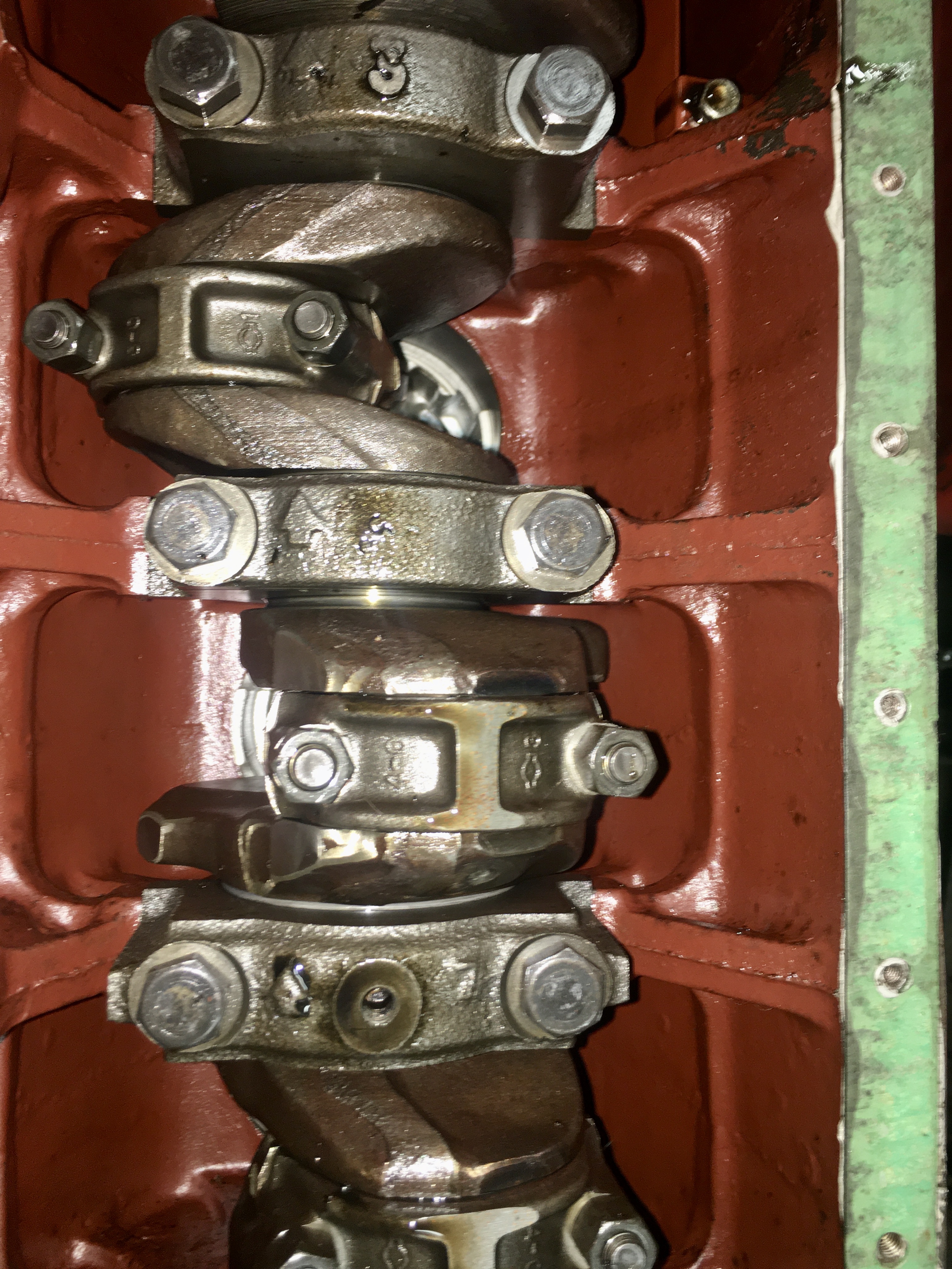

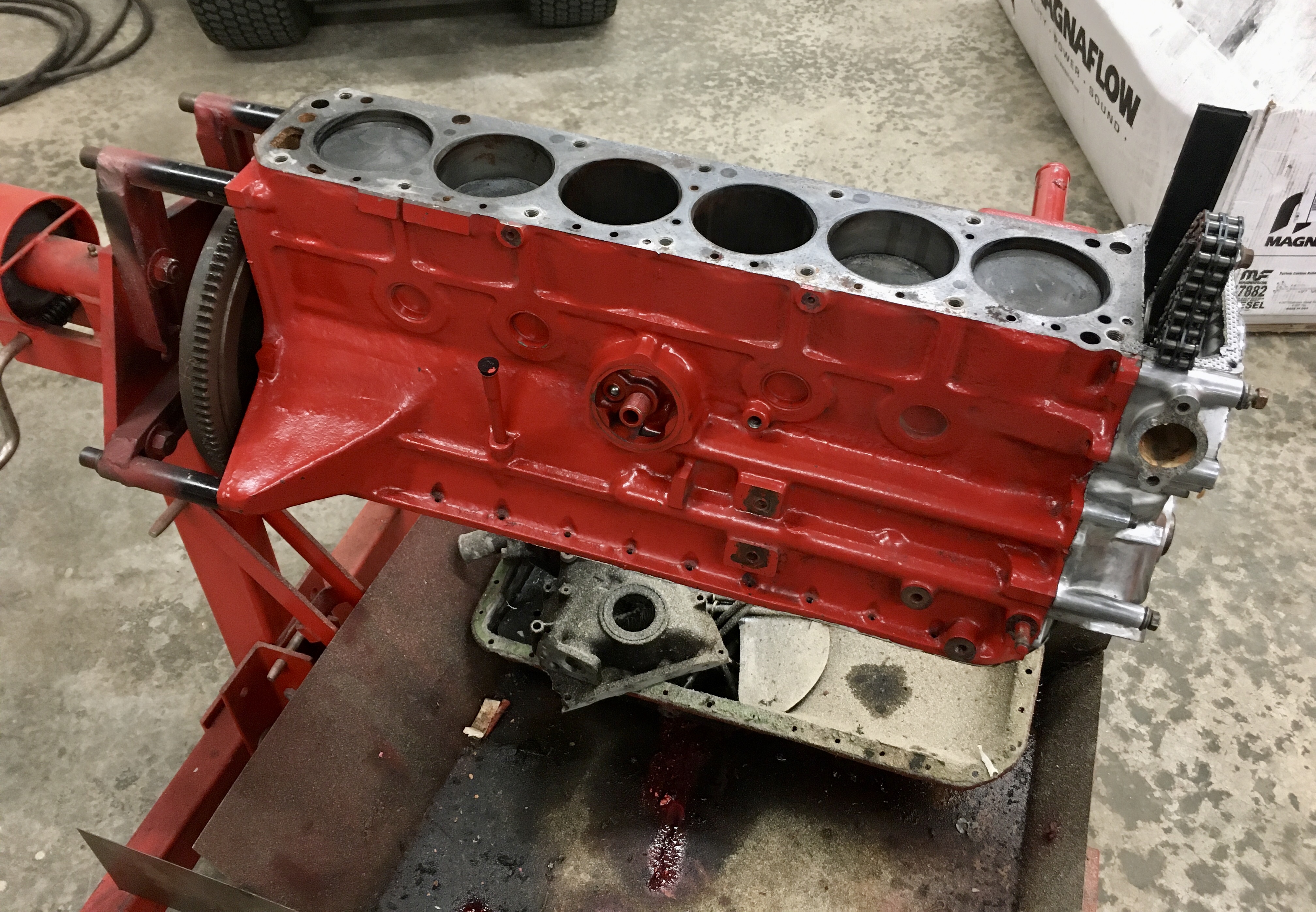

June 1, 20213 yr comment_622499 Took a different look at what to do so I can get my brown 72 in driving condition for the summer. I was building this engine for the car when I was married to Mrs. Racer 1.0. The bottom end was done and I had started on a head for it when we split up. Right after that I was at Portland with the race Z for an ICSCC meet and had a crankshaft break. I was leading the points in my class, and the next meet was Pacific Raceways the following week. I didn’t have time to build another bottom end, so I swapped the head and other stuff and ran it for one weekend. Took the head and other stuff off a couple weeks later and put it all and a fresh race prepped bottom end. That was about 24 years ago. It is an L24 P30 block, bored 0.030 over. The cylinders are eyebrow clearanced. The crankcase was smoothed and sealed with Glyptal. The head, intake and exhaust from my race car have already been on it once, so they would feel right at home.  I don’t plan on returning to the class I ran the race Z in again, so that setup is available. Stay tuned, eh?   Link to comment https://www.classiczcars.com/forums/topic/64911-2021-what-did-you-do-towith-your-z-today/?&page=3#findComment-622499 Share on other sites More sharing options...
