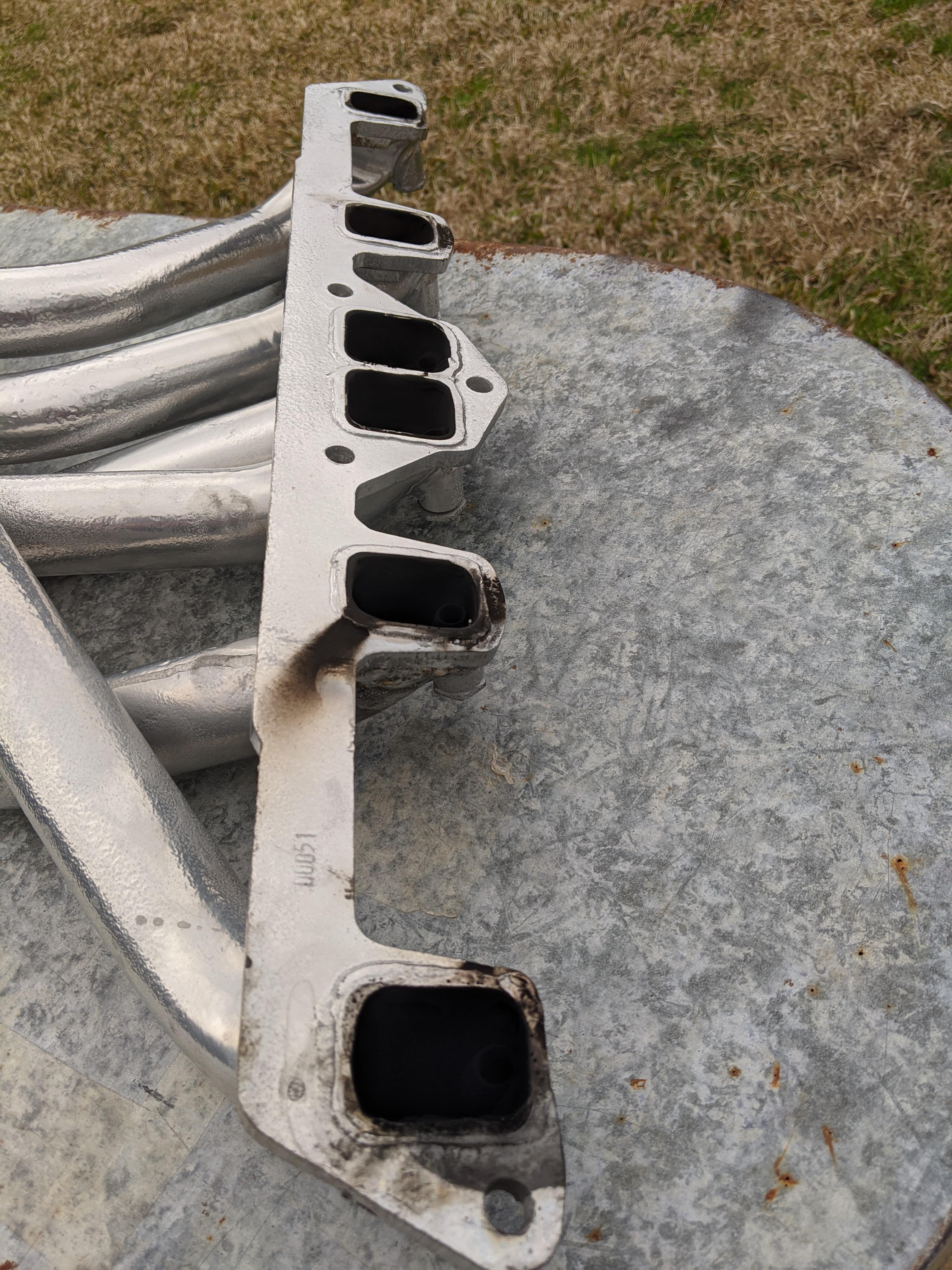

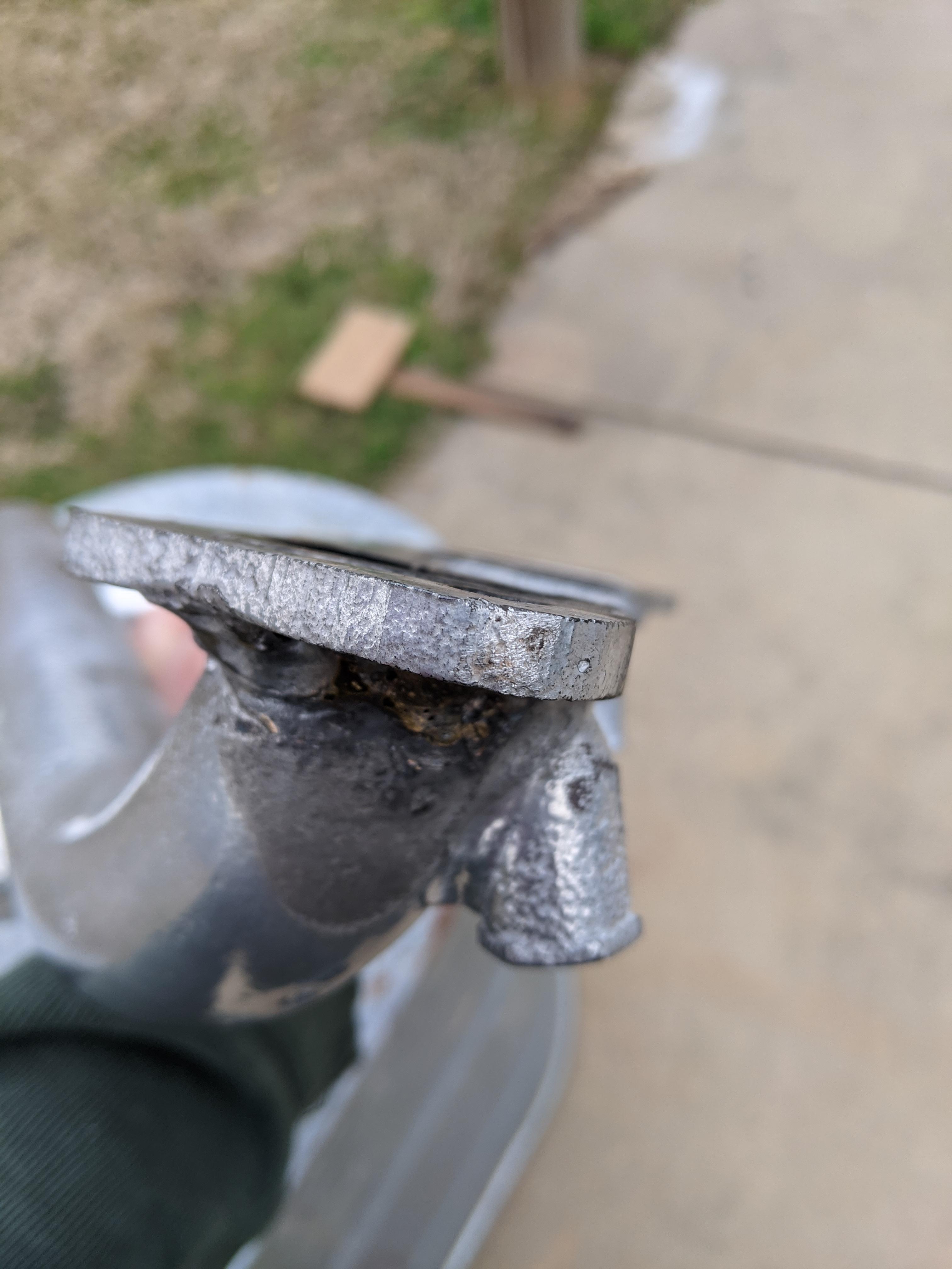

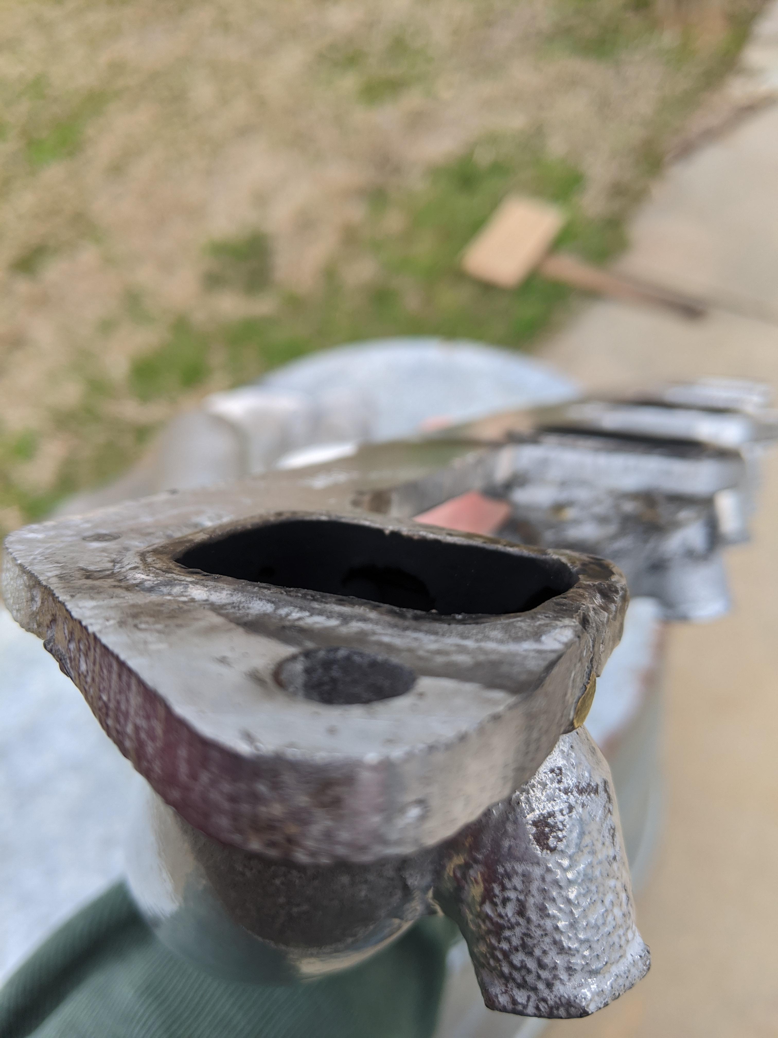

Dadsun Posted February 8, 2021 Author Share #109 Posted February 8, 2021 On 1/24/2021 at 7:35 PM, Racer X said: I forgot to mention, check the header and manifold mating surfaces for flatness. Using a straightedge with a ground flat edge check that all surfaces are flat, and square. Anything more than .002” or .003” off will be difficult to get sealed and kept tight. Well, Racer mentioned it and now that it's off the car, the header does have some significant issues on the flatness from one end to the other. In particular the front most exhaust flange is pretty much worn away. I could have my friend braze another lip around it and then try to grind appropriately, but I don't think I'll get it within tolerance that way. Or could have a competent machinist, but that'd probably be a lot more hassle and maybe even higher cost than just buying a new header. Ugh. Wish I would have known what to check before paying to have it ceramic coated. I think one of you highly recommended a 6-to-1 header upgrade? Btw, someone said it looks like the header has been leaking for a while. No, that's just how much carbon has built up in the engine. I've had the header back on a month and probably have <1 hour of run time, almost all of it in my garage while I was tuning the carbs. 1 Link to comment Share on other sites More sharing options...

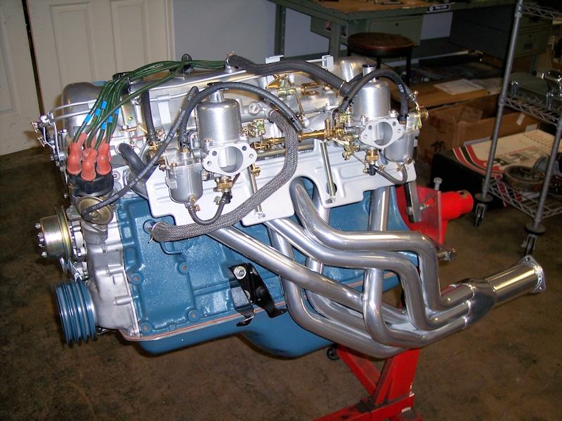

jfa.series1 Posted February 9, 2021 Share #111 Posted February 9, 2021 Here's the MSA 6-1 header installed on my engine. The flange thickness is a perfect match for the intake manifolds. 3 Link to comment Share on other sites More sharing options...
Racer X Posted February 9, 2021 Share #112 Posted February 9, 2021 2 hours ago, Dadsun said: Well, Racer mentioned it and now that it's off the car, the header does have some significant issues on the flatness from one end to the other. In particular the front most exhaust flange is pretty much worn away. I could have my friend braze another lip around it and then try to grind appropriately, but I don't think I'll get it within tolerance that way. Or could have a competent machinist, but that'd probably be a lot more hassle and maybe even higher cost than just buying a new header. Ugh. Wish I would have known what to check before paying to have it ceramic coated. I think one of you highly recommended a 6-to-1 header upgrade? Btw, someone said it looks like the header has been leaking for a while. No, that's just how much carbon has built up in the engine. I've had the header back on a month and probably have <1 hour of run time, almost all of it in my garage while I was tuning the carbs. Interesting how the one flange looks flush where the tubing comes through, rather than protruding and then ground to make a flat ridge around the port (which aids sealing). Sure, you could pay a competent machinist to repair it, and spend more money, but is it really worth it? I see it has emissions bungs, that are not being used. Getting a header that doesn't have them makes more sense if you aren't using the AIR system. Having tubular exhaust is all about maximizing air flow through the engine, and the flow past the unused bungs will be disrupted some. As for what header, consider the engine as a whole, and choose accordingly. Personally I am considering a full stainless steel system from that guy in France. His systems look nicely done, and can be tailored to the engine build and intended use. I just need to save the cash. Link to comment Share on other sites More sharing options...

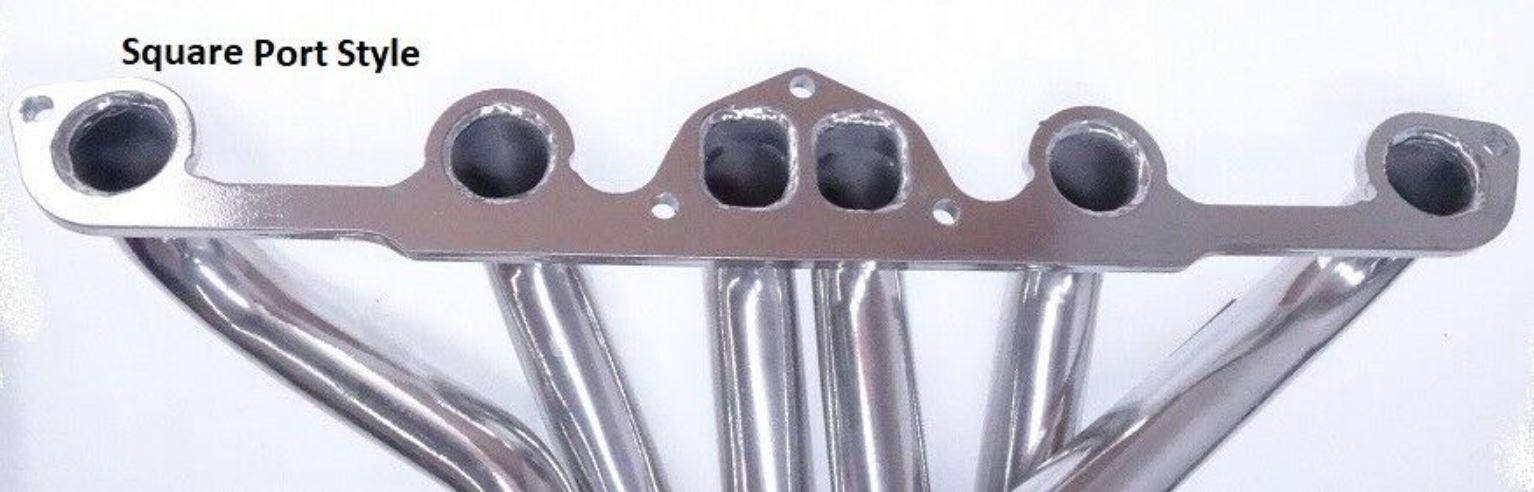

Dadsun Posted February 10, 2021 Author Share #118 Posted February 10, 2021 (edited) So, with MSA now telling me they are on back-order indefinitely for ceramic coated headers, I'm a bit stuck. Anyone have other avenues they'd recommend? I could buy the uncoated for $300 then pay about $240 to get them coated, but that is just too painful on the wallet. I've been looking through eBay, but don't trust a lot of what I see. Does this (see pic) make sense as a "square port style?": Also, the MSA website description of their headers say: "The thick exhaust flange is flat machined to promote a consistent seal. It also prevents warping and eliminates the need for spacer height modifications." Does this mean it will not have the raise lip around the square ports as my current one has? (see pic#2) Edited February 10, 2021 by Dadsun Link to comment Share on other sites More sharing options...
Racer X Posted February 10, 2021 Share #119 Posted February 10, 2021 9 minutes ago, Dadsun said: I've been looking through eBay, but don't trust a lot of what I see. Does this (see pic) make sense as a "square port style?": The outer 4 ports in the picture look pretty round to me. Compare it to the ports on your header. 1 Link to comment Share on other sites More sharing options...
Zed Head Posted February 10, 2021 Share #120 Posted February 10, 2021 35 minutes ago, Dadsun said: Also, the MSA website description of their headers say: "The thick exhaust flange is flat machined to promote a consistent seal. It also prevents warping and eliminates the need for spacer height modifications." Does this mean it will not have the raise lip around the square ports as my current one has? (see pic#2) "Machined" suggests that there will be no raised lip. Many headers out there for the L engines have a flange that is thinner than the intake manifold flange. So the yokes don't sit flat and you can have sealing problems. Sounds like MSA has addressed the problems. Those eBay headers look sketchy. Four round and two square, not right. 1 Link to comment Share on other sites More sharing options...
