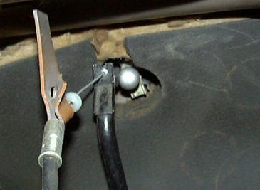

Another component to the hand throttle is the gas pedal arm.  The cable from the lever goes to a ball and socket on the gas pedal.

Yes the correct pedal is part of the whole set up. In all the cars I've seen, the pedal with the extra tab were left in the cars. No need to change that out when they removed the cable and lever assembly. Later models do not have the tab. My car had the bracket fixed under the dash where the cable sheath locks into place. From there the ball end of the cable hooks to the pedal tab, pulling above the fulcrum engaging the throttle.

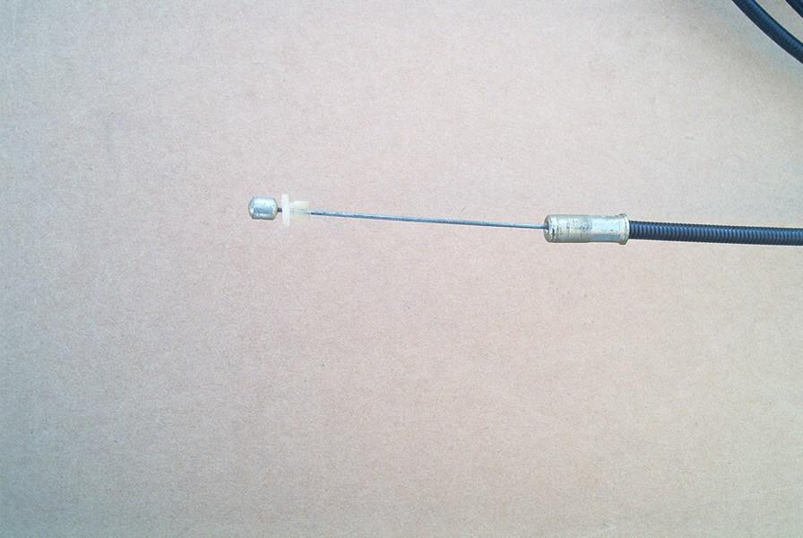

Does anyone have any pictures of how the cable attaches to the pedal?
I’ll dig through my photos from years ago. But here is how I would describe it.
The inner wire of the cable has a medal button attached to it at the very end. In front of it is a nylon looking grommet shaped to snap into the back side of the tab at the top of the gas petal. That grommet allow the gas petal to ride on the inner wire and allows the gas petal to move freely until the lever pulls the wire to make contact. When the lever is pulled back it holds the gas petal at that position.
Works good for holding a higher RPM at cold start without using the choke. Aids in warming a cold engine. It could be used for increasing idle speed for sync the carbs but SUs have a screw for that.

here is the end of the cable
