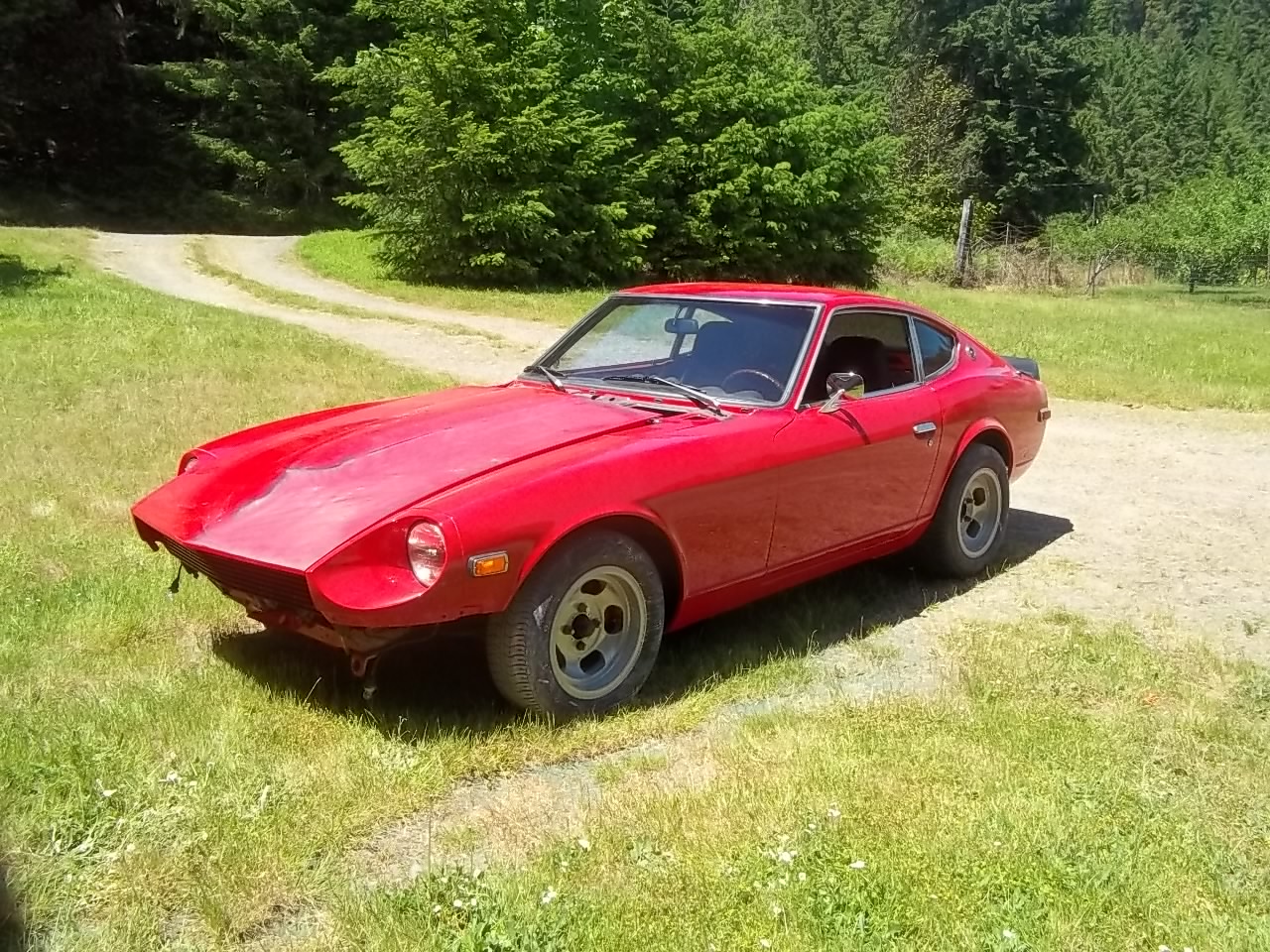

i have this one. it works well. downside, no instructions at all, and, you dont know what parts they are when you need replacements.100_1672.JPG
and, 14" wheels do fit, but there is very little extra room. IIRC i had to remove the wheel weights. i also have the toyota front calipers, but not these wheels now

That looks like the maxima caliper.  So they are 1984 Nissan Maxima calipers.  This is the same swap I am doing.  I found the bracket online for like 65.  Then I bought the rebuilt calipers, bolts right on.  You keep the E brake.
