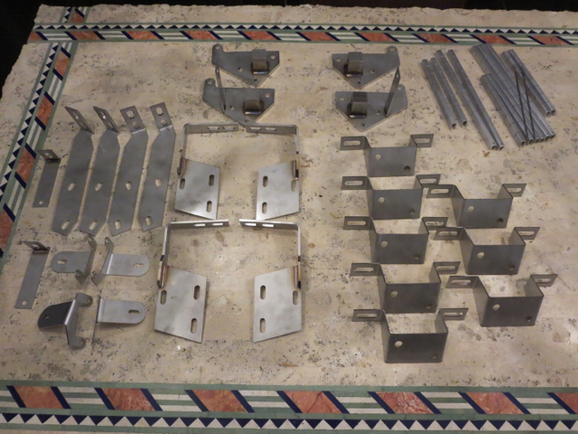

Finally we made these brackets that DOES NOT require any cutting or modification to fit 240Z bumpers.
In Japan, all the cars made between 1969-1978 have early 240Z bumpers. However for US market, Nissan did heavy body modification to clear strict "5 mile-bumper" rule and fitted bog bumpers.
These kit give those who wants to have JDM/Euro look to their car an option!
Precision cut, bend, and drilled by latest technology using OEM gauge metal.
http://jdm-car-parts.com/products/240z-front-bumper-conversion-bracket-kit-for-us-1974-78-datsun-260z-280z
http://jdm-car-parts.com/products/280z-rear-bumper-bracket-conversion-kit-for-us-1974-78-datsun-260z-280z-late-s31
These will be available from Motorsport Auto from this week!

Nice work Zed Head.
We did not realize that you made nice pieces! Perfect for show car!
Ours are made exactly the same bracket as Japanese early S31 rear bumper bracket including hole patterns.
Front ones are made so that you don't have to drills any holes. And it is the same gauge metal as factory one which mounts to the factory threaded holes on the car.
Our parts are made for people in US who just wants to get rid of big bumpers and install 240z bumpers in the easiest way.
I but I really like yours! Nice!
Edited by esprist
Wrong font
I ordered and received from @EuroDat
I received very quickly after ordering and paying. Brackets look great though I haven't installed yet. Plan to use on my 75 280.
