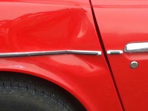

Redwing Posted November 6, 2015 Share #151 Posted November 6, 2015 Today was a very eventful day for RedBird. She drove wonderfully to Advance Auto. I did manage to get the alcohol fuel treatment, but she would not start when leaving. Starter fluid into the manifold had no effect. So we sat. Eventually she decided she had taken enough of my time, and started. I bought 3 gallons of gas, and we drove around a bit to mix the treatment in with the gas. Revving her as often as I could to keep those RPM's up. Went to the vet, parked away from the other cars like I always do. THEN someone who did not look at all, backed her van into RB. Cops called, information shared, thank God she is insured. It is not horrible, but anything hurts. I really almost lost it, makes me sad. After everything, now this. Jai 😇 🚘 Link to comment Share on other sites More sharing options...
S30Driver Posted November 6, 2015 Share #152 Posted November 6, 2015 What a sad thing to happen just as things were coming together for you and your car. Makes me sick. Have followed your thread for a while now,and just wanted to say I wish you the very best of luck Jai with the outcome.(at least the door does not appear to have any damage) 1 Link to comment Share on other sites More sharing options...
SteveJ Posted November 6, 2015 Author Share #153 Posted November 6, 2015 I'm sorry your car got hit, Jai. Vans do not like Z cars. My 240Z was hit by a van 18 years ago. My car was parked at a gas pump and the driver cut the corner too much. 1 Link to comment Share on other sites More sharing options...
