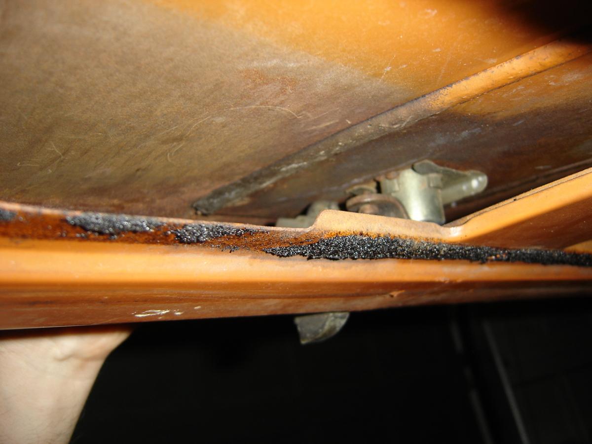

Patcon Posted September 4, 2015 Share #83 Posted September 4, 2015 That picture was perfect Cliff 1 Link to comment Share on other sites More sharing options...
