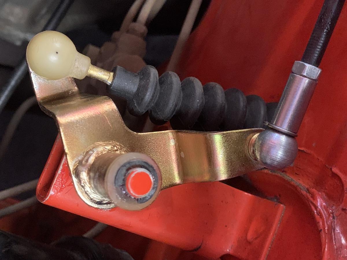

While replacing the throttle rod boot, I plated the bell crank and rod.  Not perfect, but almost there, and still learning.
This is the main reason I wanted to get a CopyCad system, so I can take a little extra time to make it look good as I'm working on a small area, without sending it off, and waiting, etc.   In this case I can get it all done in an hour or two instead of a week or two.  👍  Well, I should have let it dry at least overnight, and maybe bake it for awhile.
