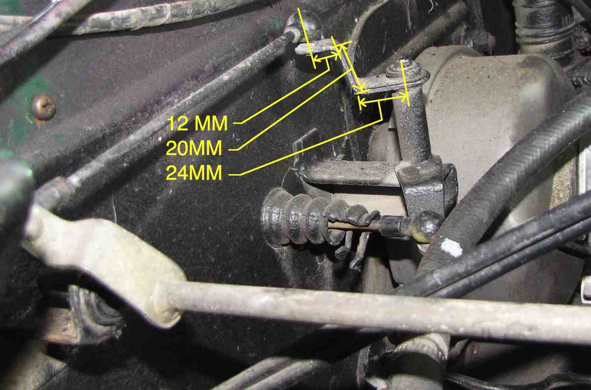

The common fix involves reducing the included angle of the two bell crank arms from ~90deg to ~50deg or so. There is a thread on here somewhere about this.
Just cut the mounting tube in half, rotate and re-weld. Change length of the upper rod end to match.
You could also convert to cable throttle, the best solution in my mind. Depends on whether original look or vastly improved functionality is your goal.

More info here:
Throttle jerk fix - Blogs - Classic Zcar Club

I do not find this to be a fault with the Z. My Z had this exact problem when I first bought it. It was quite bad actually. When I got the SU's rebuilt at Z therapy, It came back with new linkage rods on them. The cars problem were 100% gone. All of the parts were bone stock. Nothing was cut, bent, modified or any other creative bandaid. I am just saying that if the parts are in good non worn out condition, the throttle will be perfectly OEM.
I would recommend calling Z therapy and asking them how much it would be for a complete set of new push pull rods with new ends on them
I think if you get that, and remove all the slop, you will see your problem goes away.
Moral of the story, when the car was new it did not have a sticky throttle, so return it to new....
Or you can get a lokar cable, as it work very well just as Mike said.
I want to keep it Original, so cable is no option. I did the bell crank mod, and for a while that seemed to help but the problem is back. @ Kenobi : I was thinking the same way, the problem wasn't there when new ! It must be wear.. or a little sticky butterfly valves in the idle/lower part ?
