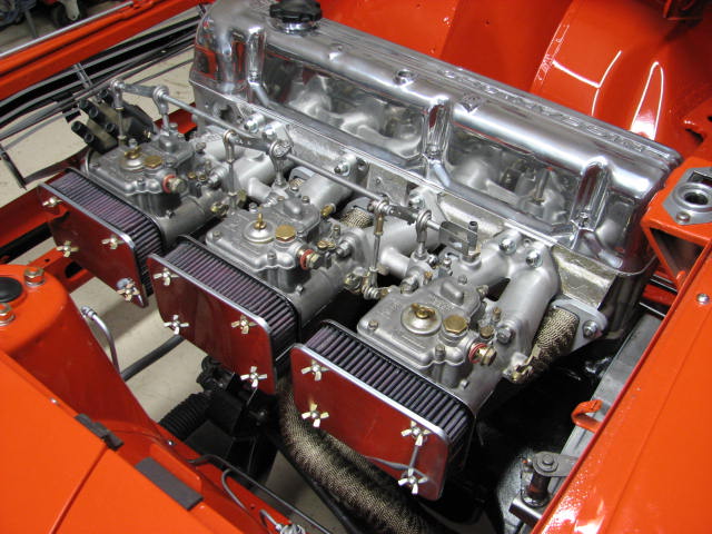

Hi all,
Just thought I'd post my recent Dyno numbers.. Below are the basics - used the basic set-up from The Datsun Garage . http://datsunzgarage.com/
2.8 - P90 Head shaved .080 - Triple Webers - 5-sp - 3:90 gears.
These are the numbers:
HP - 180.84 at the wheels
Torque - 187.02
Using the basic 20% drivetrain loss this gives about 220 at the flywheel, not bad..!!
Shaving .080" and using Webers adds 50 HP? There must be more to the story.
Not hiding anything, I'll try to post the dyno sheets for everyone to see. Check out the website above, I used the same WebCams grind "# 94a" grind with .430 lift, 230/230@.050" duration, no stroker crank or power adders.
That sounds about right for a well tuned machine.
Congrats!
Would like to hear more specifics as far as timing, type fuel, afr readings
First off, nice job. Looks like a clean and well-done setup.
Second of all (and don't let this burst your bubble), by themselves, dyno numbers are truly useless. What those numbers are good for, is comparison between cars and setups on the same dyno and preferably on the same day (for obvious reasons, this isn't always possible). It would be of more use to have dynoed the car before and after modifications, on the same dyno. For example, JustAFantaZ on HybridZ recently had his V8 Z dynoed on 2 different dynos. The difference in the results between the two dynos was 74hp (428hp vs. 502hp)! That's over 15% variation!
We have to realize what dyno numbers are. This will lead to less fuss and confusion. Power or torque is calculated based on the type of dyno. There are variances between dynos, no two are the same. It is not a hard, true number although some dynos are closer than others. Was this done on a inertial (Dynojet, Superflow, etc.) or brake dyno (Mustang, Dynomite, etc.)? Inertial dynos, like a Dynojet, produce more inflated numbers. In JustAFantaZ's experience, the Dynojet showed over 15% more horsepower than the Mustang dyno!

Very impressive. Post the sheet so we can see your torque curve!
