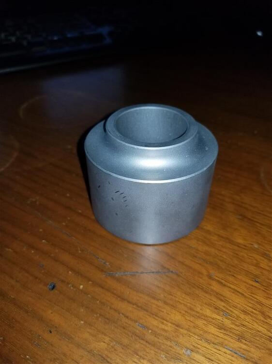

I don't know if this qualifies since I paid someone to produce it. It is a mustache bar bushing press tool. When used in a press, it folds the metal bushing sleeve tight at the original angle.

You're the brains behind it so you for sure qualify. :beer:
That is a great tool, back when you could get a hold of those bushings I had to cut the top lip into petals and fold them down in order to secure the bushing.
Here is a short video of the tool being used. I know others have had them made too .... which is how I got the idea. I want to say Mike has one but I could be mixed up.

Are the Nissan OE bushings NLA?
Yes, they have been NLA for a couple of years now.
You would think a substitute could be found if a bushing mfg catalog could be looked over. We still use this kind of bushing in all kinds of modern applications.

1 hour ago, grannyknot said:
I have one NOS mustache bar bushing on the self and hoping to find another one of these days.
I wonder how hard it would be to make a 3D printed mold and then match the durometer for pouring replacement bushings?
I have thought of this too. the washers would be another reburb thing that would be really nice to have
