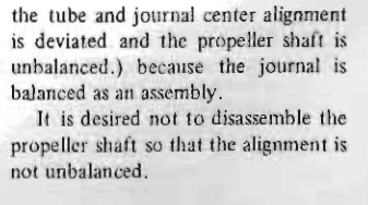

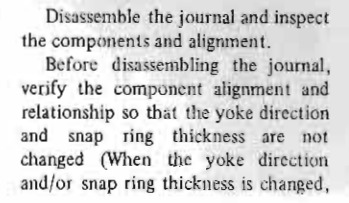

April 28, 20214 yr comment_620688 1 hour ago, AK260 said: a few of the half shaft nuts / bolts kept loosening I never had that.. you use the original bolts (they fit very snug) and nut with the spring ring? I always use the originals and never had that problem.. shaking yes but that's because my early 71 car has no diff arrester band.. not even the connecting stuf on the underbody.. they are not there.. at 200km/hr it shaking vigarously but.. oh i have to restore my 240z for the 3th in it's life haha.. maybe in 2 years or so.. 9 hours ago, Zed Head said: Look at that tiny number. The driveshaft is a important part that needs to be in balance, i would bring it to a specialist, remember it turns at a high rpm and if it breaks it could break your legs right slamming through the chassis thats how dangerous it can get. (It would be exeptional but it's not impossible.) Talking about 0,02 mm or 0,0008 Inch.. i worked with parts that had a max play of 0,001 mm or 0,00004 Inches... (Mechanical-Electronics) Link to comment https://www.classiczcars.com/forums/topic/65321-prop-shaft-and-half-shaft-phasing/?&page=2#findComment-620688 Share on other sites More sharing options...

April 30, 20214 yr Author comment_620834 I was not able to notice any play in the u-joints. I attempted to follow the service manual and some videos i found online. I just got the driveshaft back from Southbay drivelines, the gentleman there said it was 1/3oz out on the rear, and 2/3oz out on the front. Shall put it back together later tonight. @Captain Obvious so whats kind of force is generated by a 1oz out of balance driveshaft? Link to comment https://www.classiczcars.com/forums/topic/65321-prop-shaft-and-half-shaft-phasing/?&page=2#findComment-620834 Share on other sites More sharing options...
