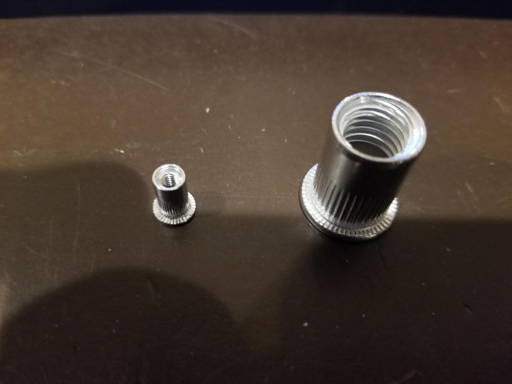

Riv-Nut goes by a number of other names: Rivet nut, nutsert, blind nut.  It is installed in a fashion similar to a common rivet.  It’s purpose is to provide a means of creating the equivalent of threads for a screw in thin metal, and it additionally works when you cannot get behind the material, for example in the middle of a panel where there is no access to the backside.  I could have used this countless times in the past.  Often times this problem is solved with a nut that is tac welded to the back of the material.  This does not work well for the DIYer.  Many have no experience or equipment to weld, sometimes you cant get to the back of an area, and in some cases the material does not accommodate a welding solution.  Of course, I have used sheet metal screws in the past.  I hate screwing anything with a point on it into a blind area, and sheet metal screws do not like to be unscrewed and refastened many times.  There is a fastener I don’t recall its name but you slide it over the edge of a hole.  It creates the equivalent of a thread to hold a sheet metal screw.  I have even used something similar with a captured nut embedded for a screw.  This however only works at an edge.  The Riv-nut is, in my opinion, an elegant solution – Thank you ZCARS.

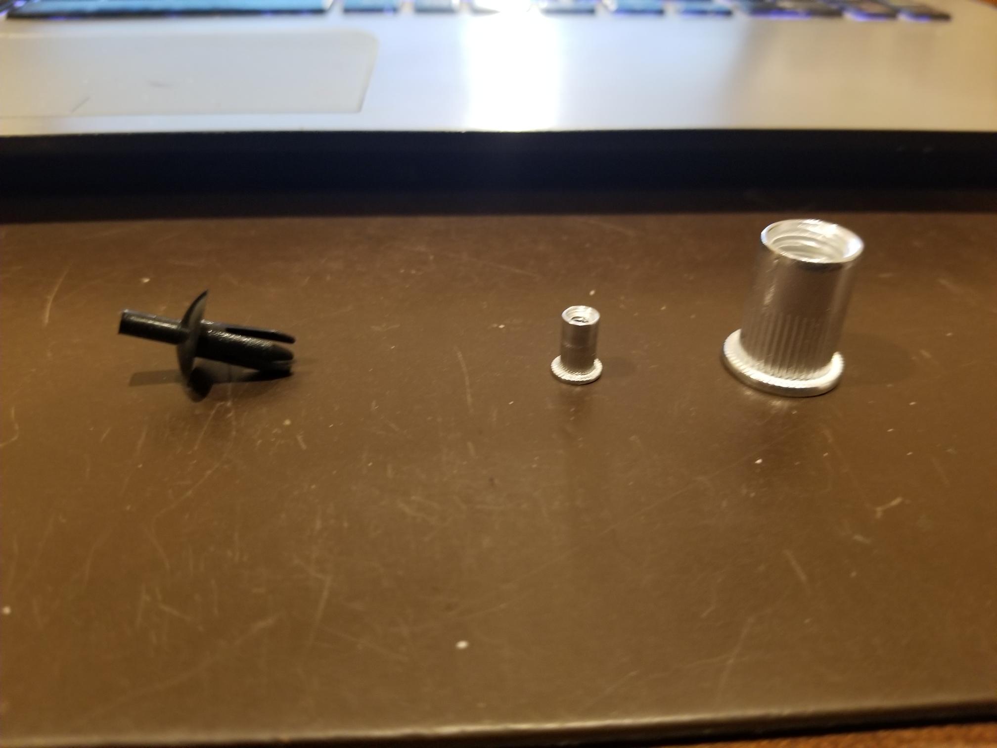

Here is a photo of a plastic rivet (on the left, and riv-nuts on the right #3, #10
Above image you can see the threads inside the riv-nut

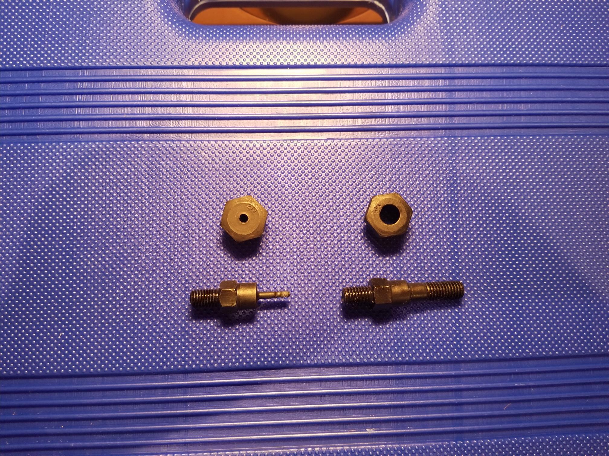

The tool has a main body with some sort of handle or arms to apply pressure.  There is a part called a mandrel which attaches to the tool.  The mandrel is specific to the size of the Riv-Nut involved.  The size of the hole is not the same size as the bolt or screw to be installed.
  1. Install the mandrel on the main body of the tool.  The end of the mandrel that is exposed is threaded.  Inside the riv-nut are threads.
  2. You screw the riv-nut onto the mandrel.

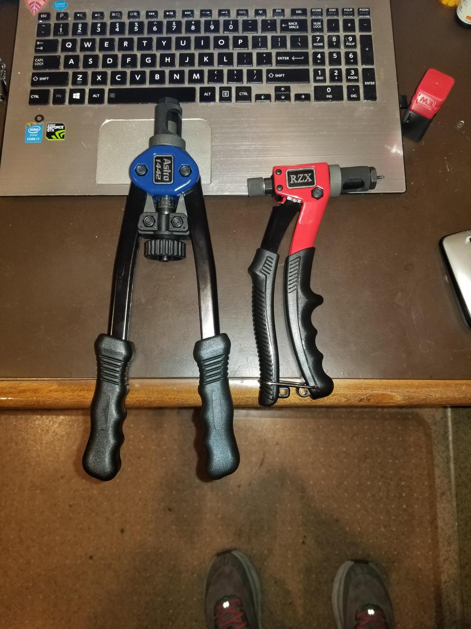

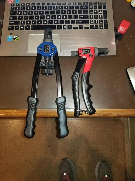

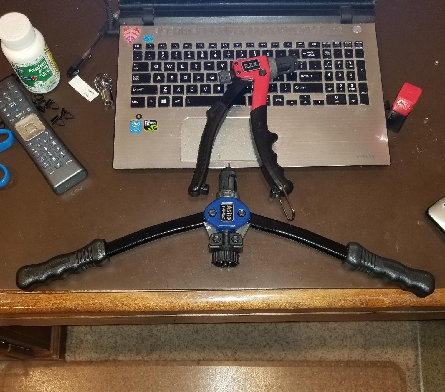

 There are a number of different tools to install riv-nuts.  They come in different sizes and shapes and of course at a range of price points, from $15 to many hundreds of dollars.  My research led me to buy an astro-pneumatic 1442.  It costs around $90.  It has many very good reviews.  It will accommodate a number of different size fasteners including metric (#5- #8) and a number of SAE screw sizes.  I believe this is a great long term choice for me.  Having said that Astro-Pneumatic does not offer a #3 or a #4 mandrel.  I called Astro and they confirmed that they do not offer smaller mandrels.  Most of the holes involved for these plastic panels are 5mm (diameter).  This requires a 3mm riv-nut.  Turns out most of the more robust tools do not offer a 3mm option.  You could drill the holes to accept a larger diameter fastener, I wanted to leave myself the option of going back to plastic rivets if necessary so I decided to invest in a second tool.   The 1442 requires two hands.  It is medium size 13 inch handles.  The handles open wide to give you more leverage.  Some of the places that you will want to install a 3mm riv-nut require a tool with a smaller profile.  A smaller tool will cost between $15-$30 approximately.  In fact if you are using aluminum riv-nuts that are small, then a small profile, inexpensive tool might be the smart choice.  Now here is an interesting data point.  It turns out that #3 and #4 mandrels that are part of some less expensive sets actually fit the astro 1442.  I actually bought a cheaper kit and used its mandrels on the astro 1442.  So, in retrospect I would still  buy the astro 1442 – it works very well, and it appears to be quite robust.  I think it handles small and large riv-nuts in aluminum or steel very well. I would then enhance its capability by purchasing a #3 and a #4 mandrel.  The smaller, one handed tool, is not a necessity, but I think it will help in tight places.  I think it will probably have a shorter lifespan, but I do not think that it will be utilized as often as the astro.
13 inch Astro 1442 (Left), RZX 8 inch (Right) both are in their closed position
Above:
Astro 1442 and RZX in Open position
 #3 mandrel (left), #8 mandrel (right)
Update 8/31/20
So it has only been a short while but I have installed a number of RiV-Nuts.  Most of them were 3mm and the remainder were 4mm.   All were Aluminum.  I can not comment on the performance of these tools using steel rivets.  I was very impressed with the performance of BOTH tools ( the Astro-Pneumatic 1442 ANd the RZX.  The RZX single handed tool worked much better than I exppected it would.  Some of the nut-serts have to be installed in the hatch area with the tool facing the sky.  Using a 2 handed tool would have been impossible there just isn't enough room, but the RZX performed excellently.  With the 1442 and a 3mm nut-sert some experience is required to know har far to close the handles.  Too much pressure and you snap the aluminum insert.  The RZX reliably worked when closing the hand grip all the way.  As I said I have no experience with the RZX and steel Riv-Nuts, but I believe both tools are good additions to my tool set.

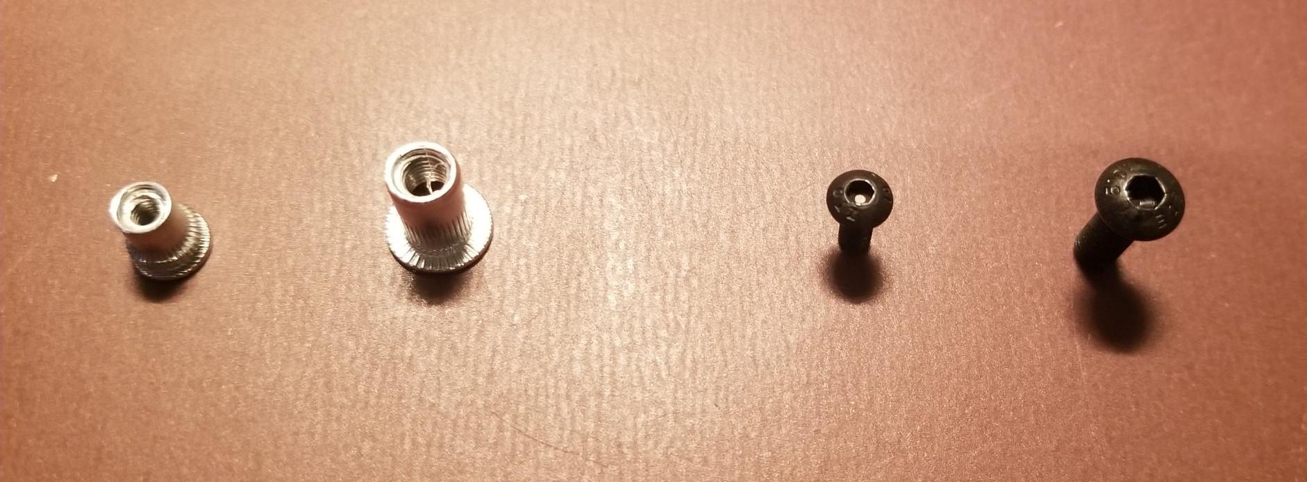

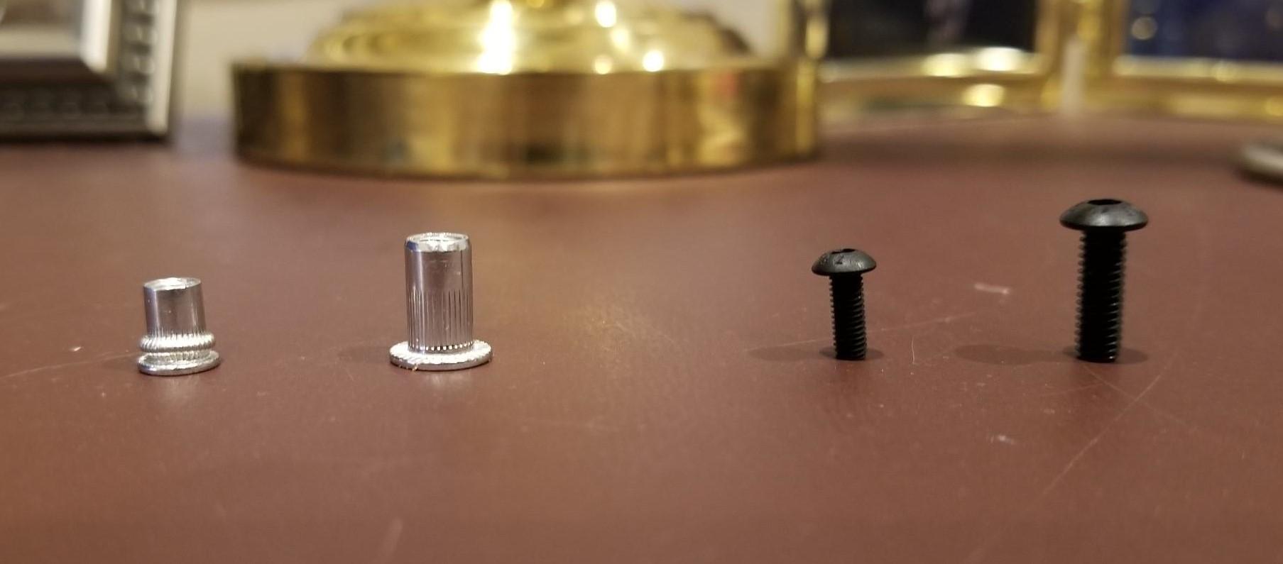

Patcon - Great question.  I am using a button head screw, with an allen head that has a black oxide finish.
Above right to left is a 4mm button head, and a 3mm button head
I thought the button head with an allen head would be the least conspicuous.  As you can see the 3mm screw is quite small.  A phillips head would be easier to install/remove, but I thought it would be more noticeable.  Unfortunately the 3mm head is too small for the hole in the plastic panel so I am also using a flat washer with a black  oxide finish.  I would be very interested if you have any other suggestions.
Also for anyone that is interested on the left side of the images above is an aluminum riv-nut.  In the center is a new (unmolested) 3mm rivnut.  On the left is a 3mm riv-nut after an install attempt.  You can see that it is crushed on the knurled portion of the riv-nut between its collar and its threads.

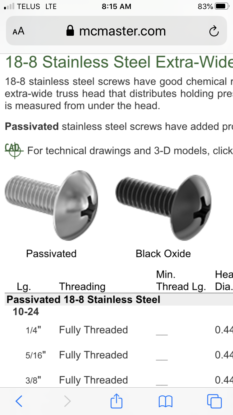

For reference, my rivnut upgrade to replace the stock interior rivets used 10-24 threaded rivnets and matching Truss head black anodized philips headed machine screws. Got them from McMaster Carr. Roughly a M5 equivalent size. They have a nice wide head. i'll see if I can find a part number

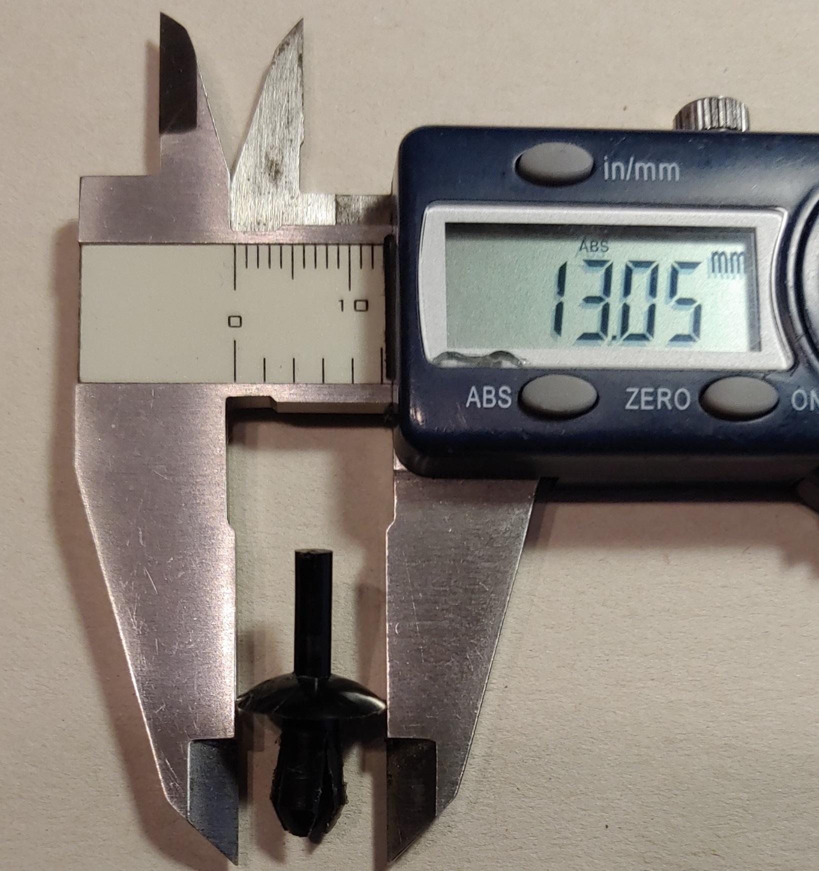

I love this idea!  I have used lots of riv-nuts for other stuff and I never considered swapping the frustrating and expensive plastic rivets with riv-nuts.  That would make pulling panels back off for future work so much easier.  I'll have to compare my M5 riv-nuts to the OE plastic rivets.  The bolt heads would certainly have to be pretty large to properly hold the panels without pulling through or cracking them.  Adding a washer wouldn't look very good IMHO.  Does anybody know the head diameter of the plastic OE rivets?  I'm guessing they are around 13mm.  I found some that are just under 10mm OD.  https://www.boltdepot.com/Product-Details.aspx?product=18952

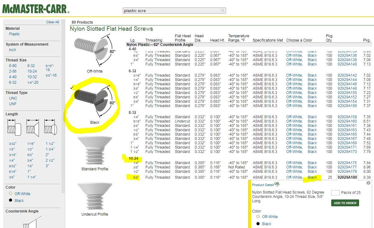

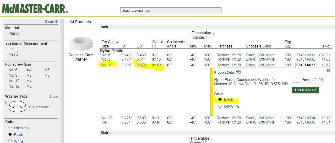

Here's another idea, black nylon flat head screws with round face countersunk washers, size 10-24. Metric 5mm is also available but the washer ht and OD is to big. Less risk of marring the plastic panels compared to steel.
https://www.mcmaster.com/plastic-screws/flat-head-screws/nylon-slotted-flat-head-screws-10/
https://www.mcmaster.com/plastic-washers/washer-type~countersunk/.
Good guess on the OD.....
LOL.  To be fair, I was off by 5 hundredths of a mm.  ?
