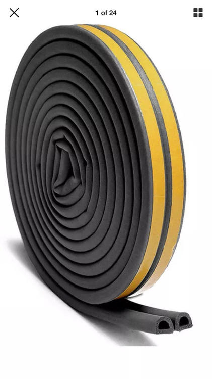

Rear hatch vinal panel: sealed with D shaped black draft excluder used in your home.

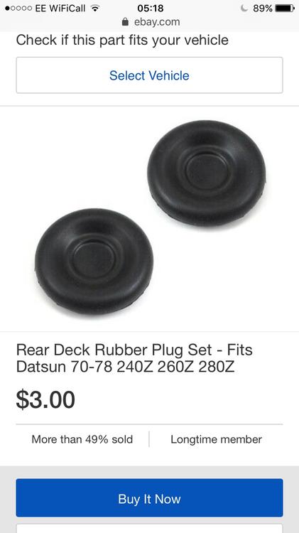

Missing rubber bungs at the bottom of the hatch. This one and the one above made a HUGE difference.
