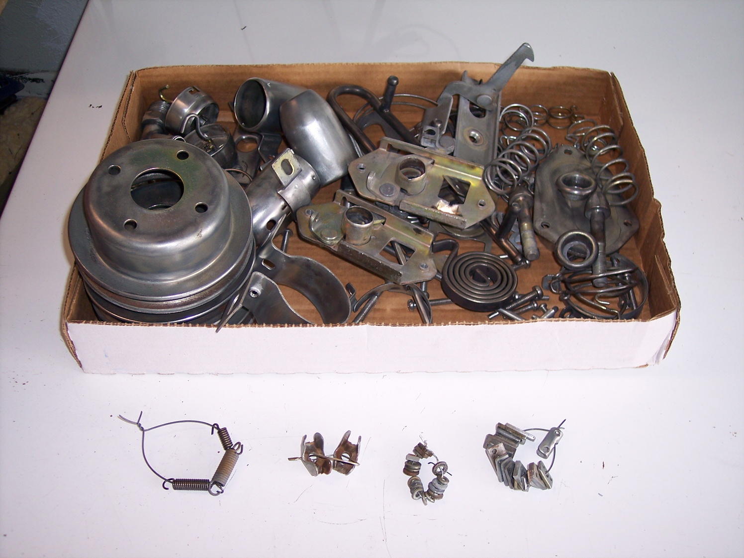

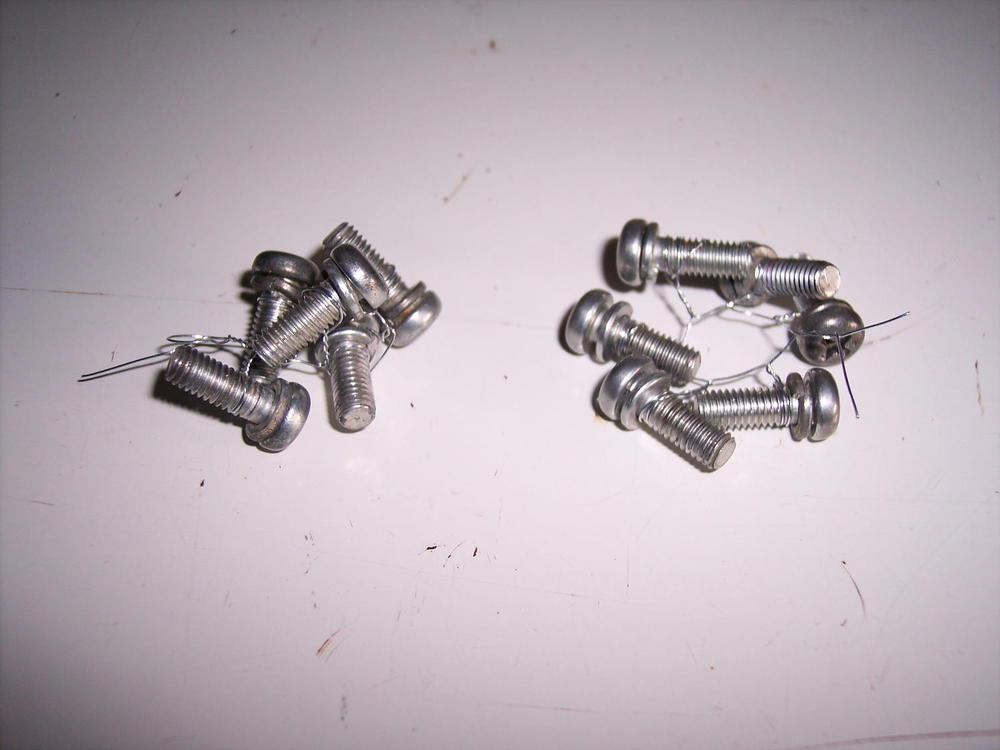

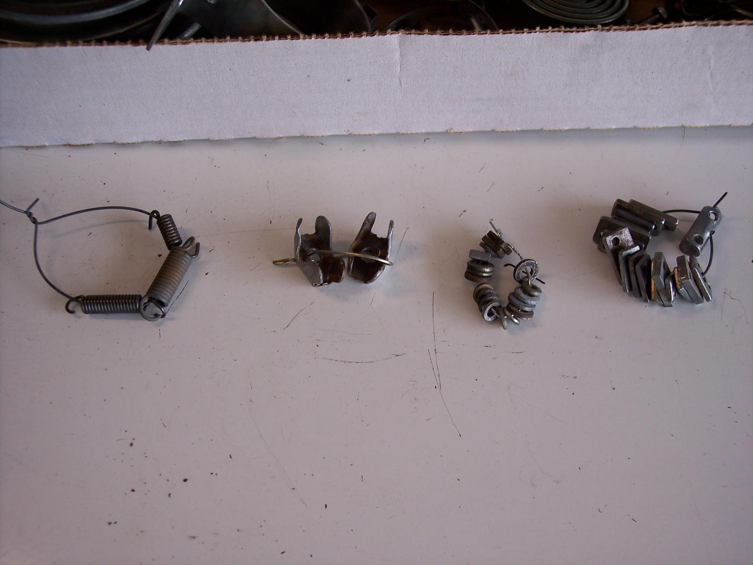

I get all my plating done locally - lucky to not have to deal with shipping.  My philosophy is that the results will be no better than the prep so everything is thoroughly stripped of paint, rust, scale, grease, ...etc. prior to delivery.  Get rid of scratches and rough edges.  Yes... small bits can and will get lost so I secure those pieces per the pics below - problem solved!  Anything with a spring, including spring steel, will need a bake cycle to drive out nitrogen (?) molecules. if not done, the piece will break.
Are you doing the post plating bake or the plater?
