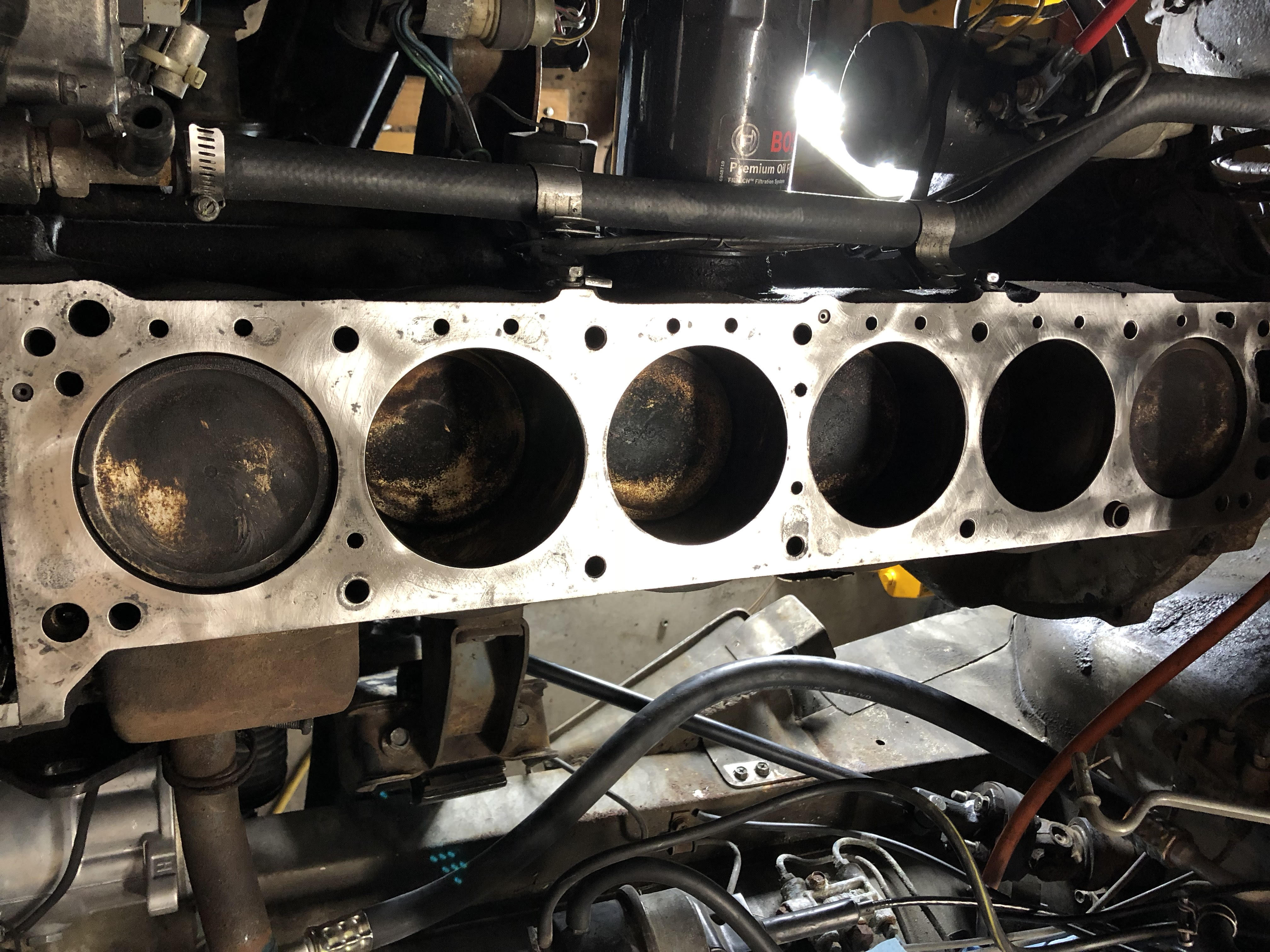

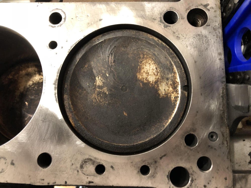

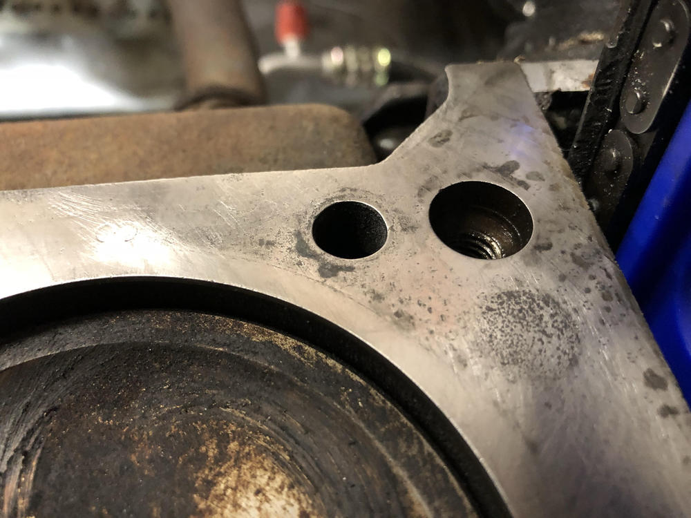

I need some help figuring out whether or not my engine block is cleaned enough for the head to be reinstalled back on the engine block. I tried pretty much what i can to prep the surface of the engine block and just need some help with those who already went through this install. So far i got most of the old gasket gunk off but there are some spots here and there that still remain. I have some acetone ready to use in hopes of removing some of the left over material. Any suggestions would be much appreciated.
Those just look like stains and won't affect the new HG, have you checked the block deck and cylinder head to be sure they are flat?
Yes, acetone with one of those green scotch-brite sponges.  Put paper towels in the cylinders so that you won't spill acetone down into the cylinders.  Use a Permatex gasket sealant like their copper gasket spray.  Get the two surfaces as clean as you can.
Remember to chase all of the bolt holes and clean them thoroughly.

Ok great responses, i did run a razor over the spots and did not catch  so it looks like it is discoloration. I also used a thread chaser to clean out the threads and went in and out smoothly with out any issues (might run it through a second time just to be safe). I recently got my head rebuilt so it is for sure flat according to the machine shop. As for the engine block i didn't check for flatness since it ran pretty good prior to the head rebuild and i just cleaned off the old gunk with a 3m white bristle roloc disc lightly. Ill update this thread as i go but looks like a promising step forward to getting it all assembled back again.
