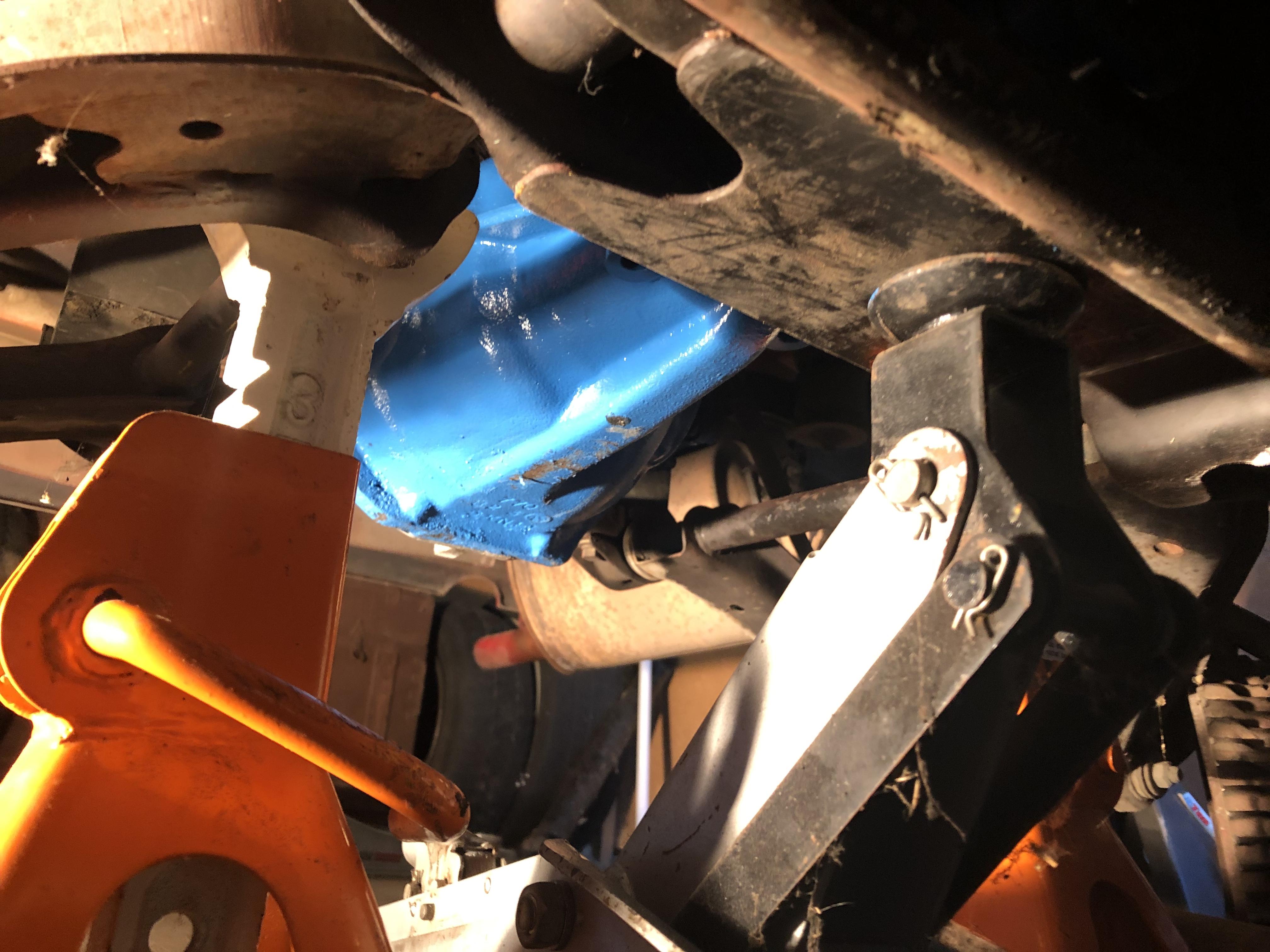

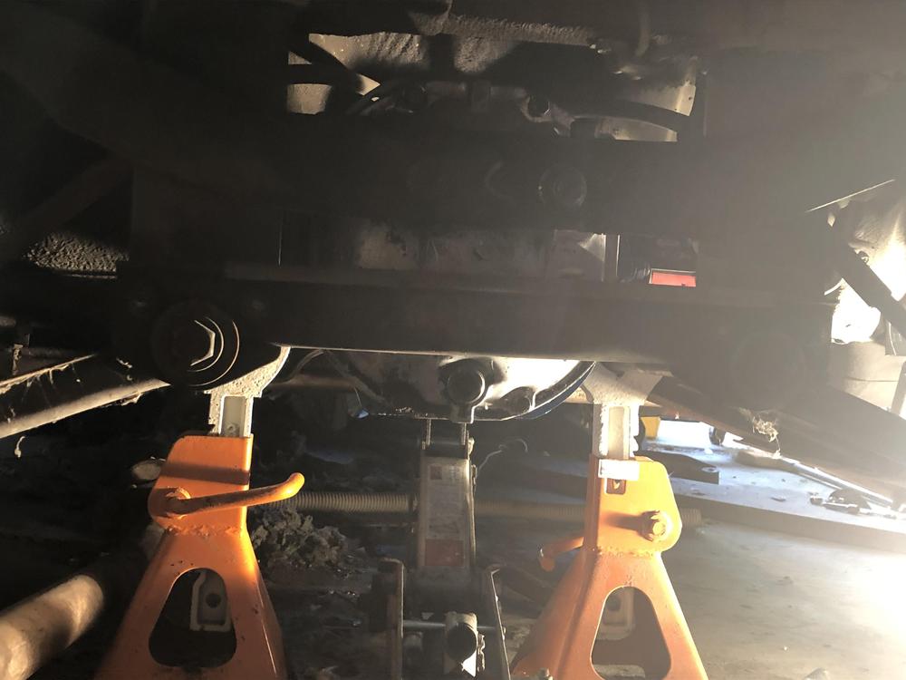

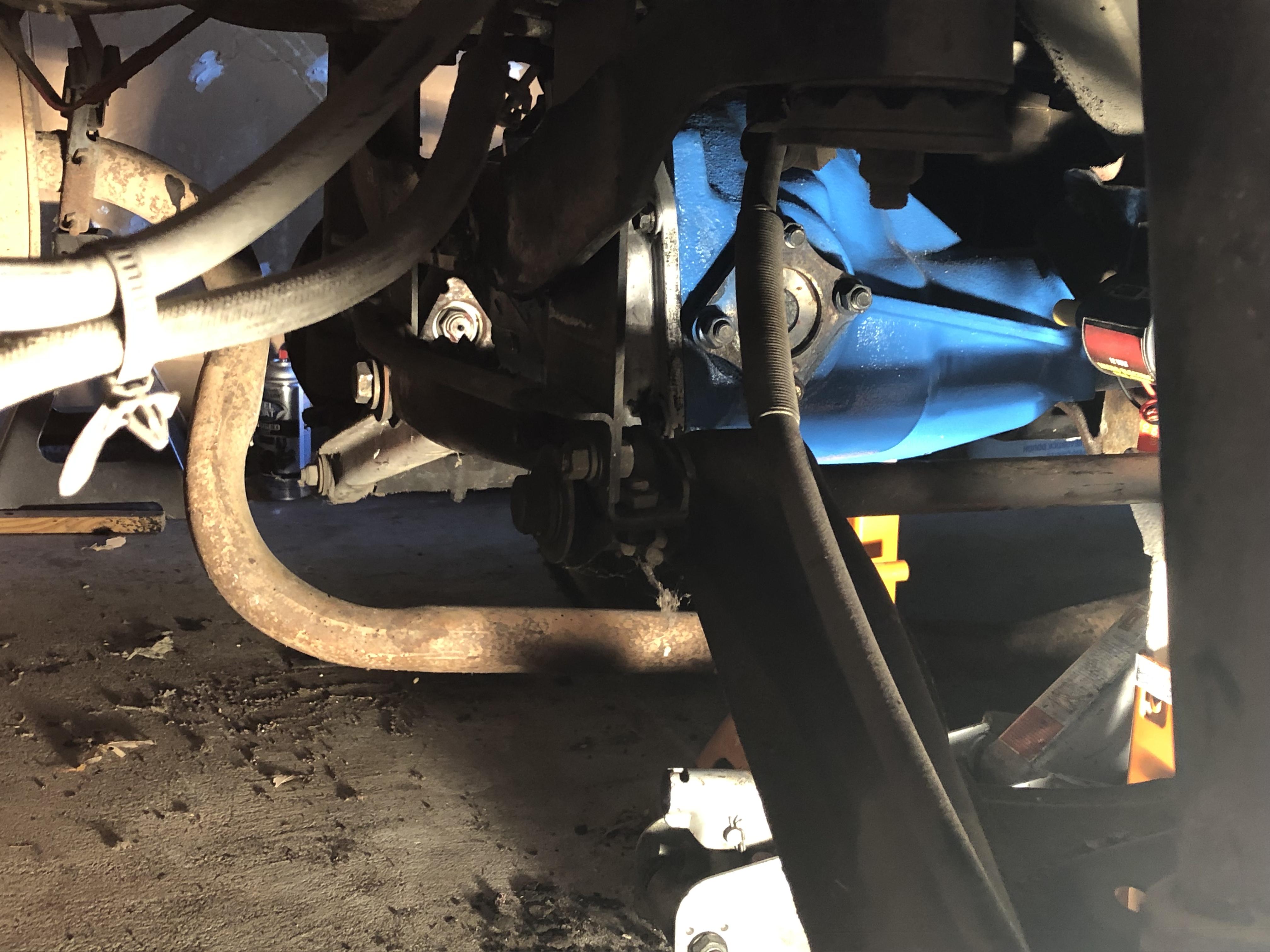

Ok I’ve been gone for a few months. Spring time means time to start working on the Z again.
good progress, I had the R200 rear end installed. Gas tank has been dropped off for cleaning.
