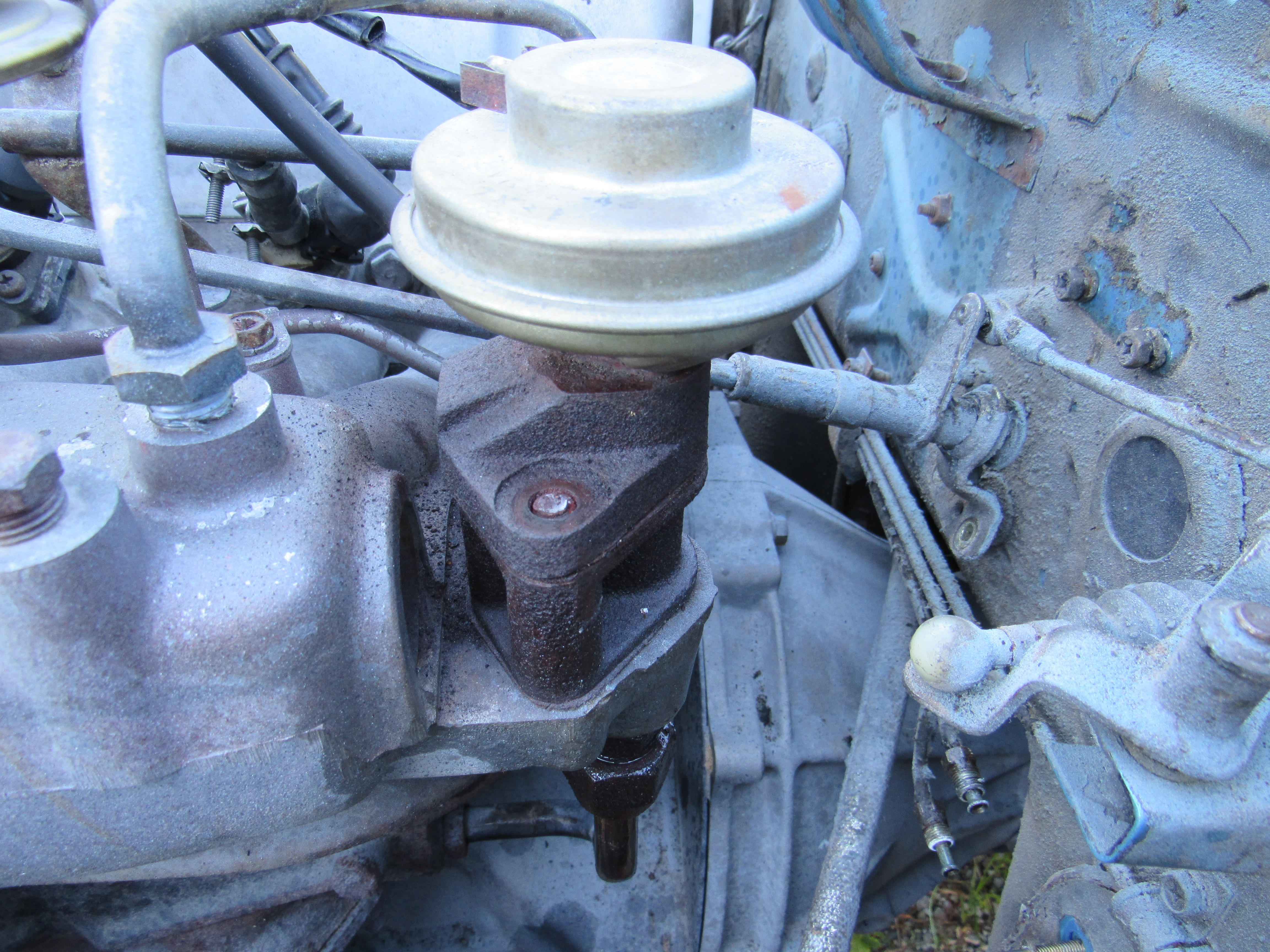

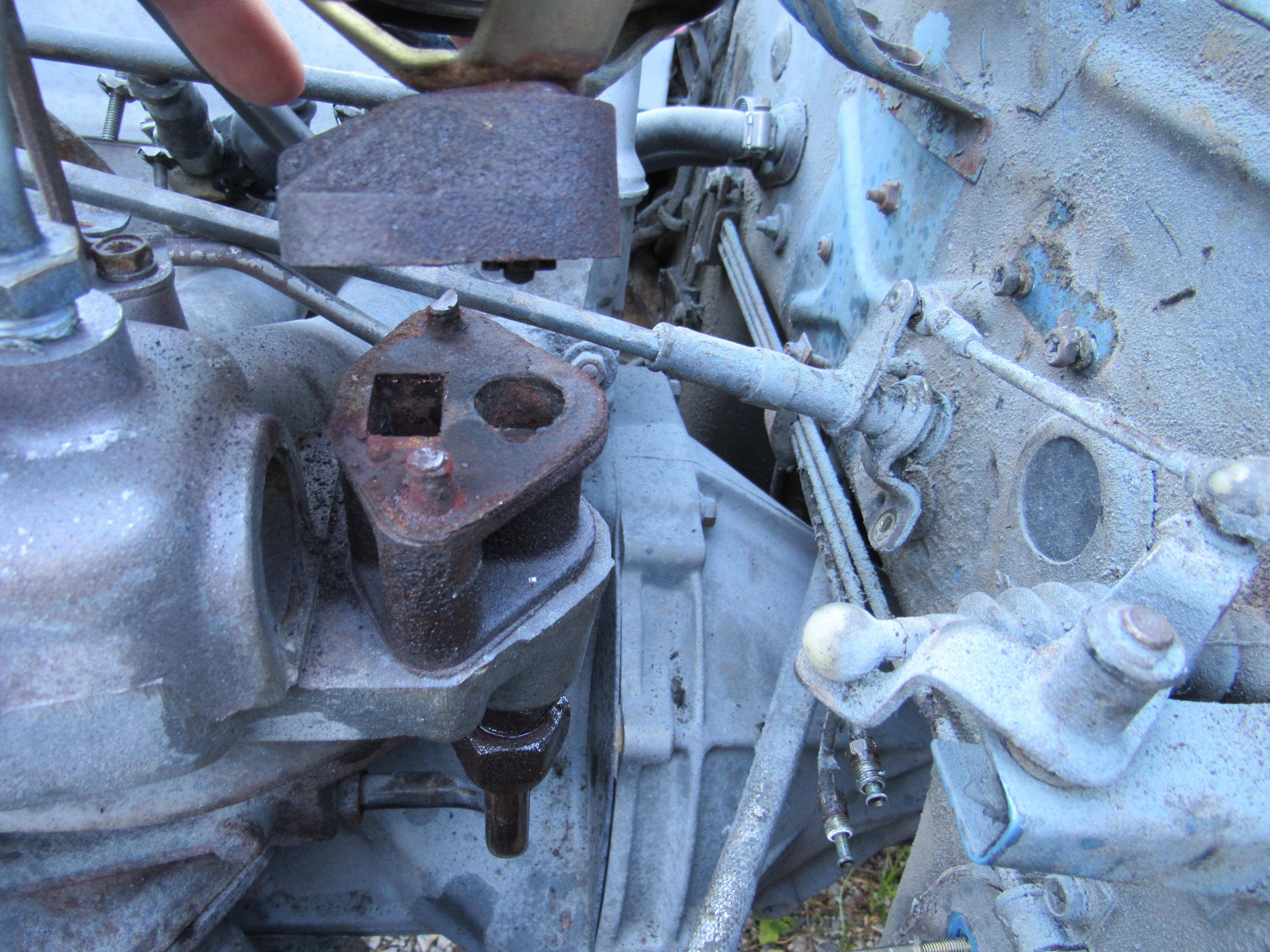

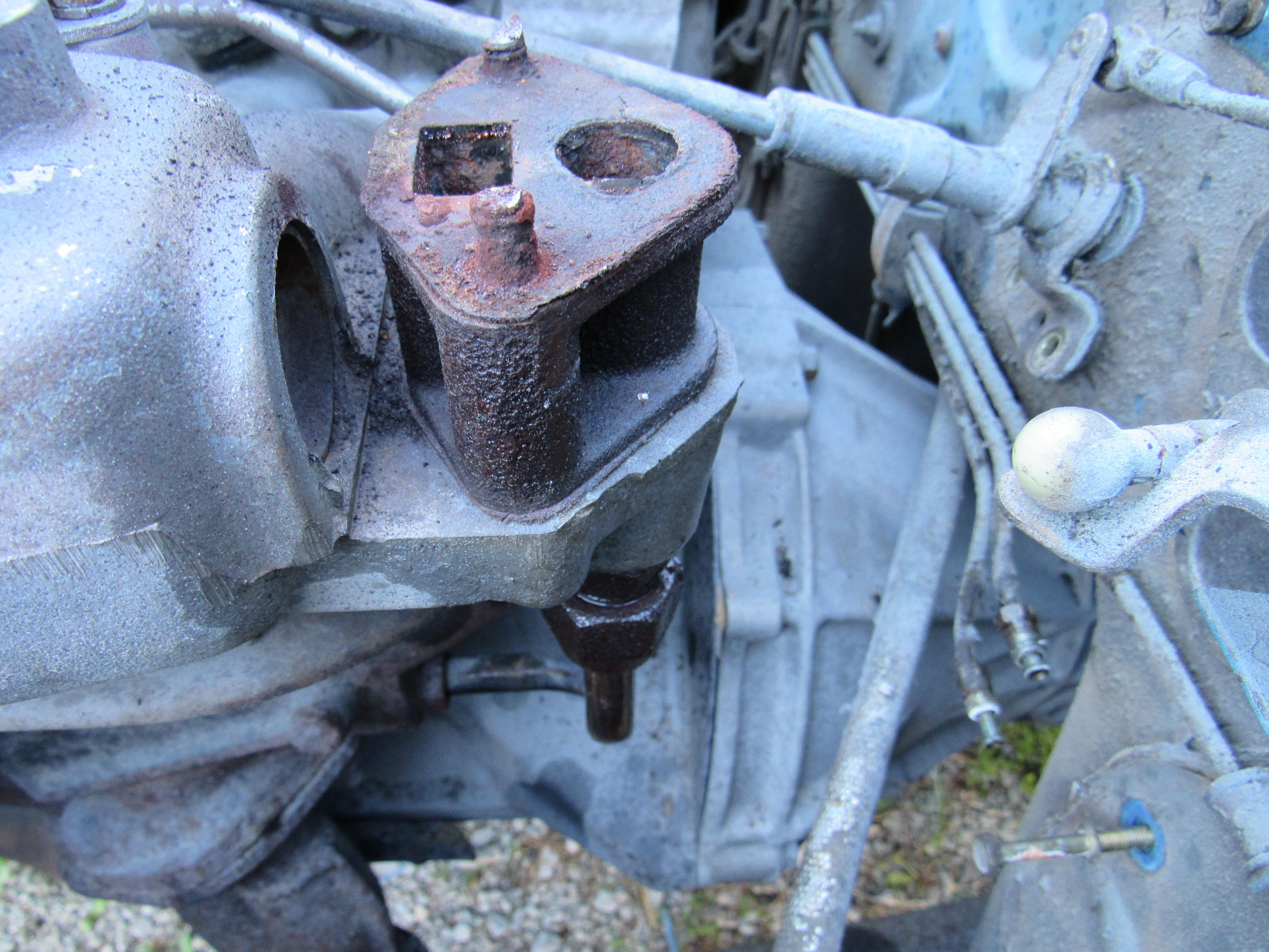

I did something really stupid today, it was working fine and I should have left it alone. So I snapped the rusted nuts off the rusted studs holding the EGR assembly to the intake manifold. Some how I have to get the EGR spacer off on the studs, get the corroded studs out of the aluminum manifold without destroying everything :facepalm:
BFH time!
PB  blaster needs to get to the threads somehow. Maybe wirebrush and some tapping with a hammer will loosen enough to get some penetrant in there
I can send the blocking plate from Blue.  It has no EGR.  I can get one from the z Barn if you need one.
Use propane torch to heat the aluminum. Repeat a few heat cycles with Liquid Wrench cooling.  A few taps on the top of the bolt helps break corrosion and works the solvent through.
that is exactly why I popped for the bolt buster induction heater. With out that I would try welding a nut on with a mig welder, that should get it hot enough break the corrosion bond. I am going to be fighting a broken bolt (front bolt that holds the FI metal hard lines in place) that happened before the bolt buster. Got a mig welder now so will try it out.
Sounds like my Sunday... Or was that Monday? Probably both!    LOL  You ever seen the problem solving flow-chart?
Good luck with the project. I don't remember... Do the stud holes go all the way through to the underside, or are they blind in from the top? If they're all the way through, you could potentially get some penetrant onto the threads from the underside.
Thanks guys, some good suggestions, spent a couple of hours on it today, BFH, heated multiple times with Map gas, cooled with wd40, little more BFH ,rinse repeat, so far it is not very impressed with my efforts. I'll keep it up for a few more days.
Phillip, that would be great, would appreciate that.
21 hours ago, madkaw said:
Or just cut it in half and slide it off - cut off wheel!
I may get to that yet.
This is the next step if the heating/cooling doesn't work.
Blind from the top.  I may just wait until I can pull the intake manifold and get easy access to both sides.

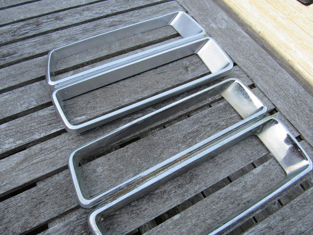

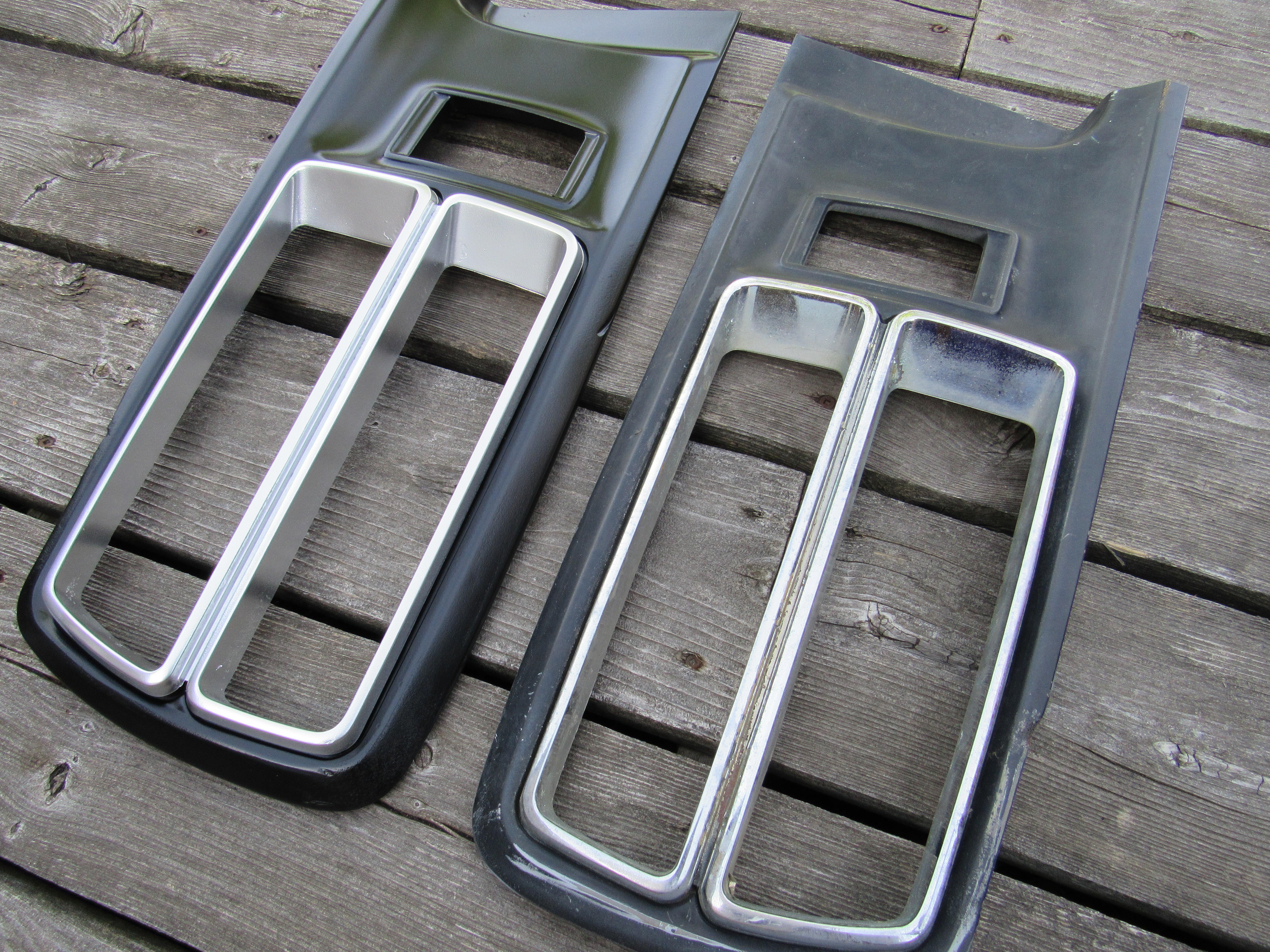

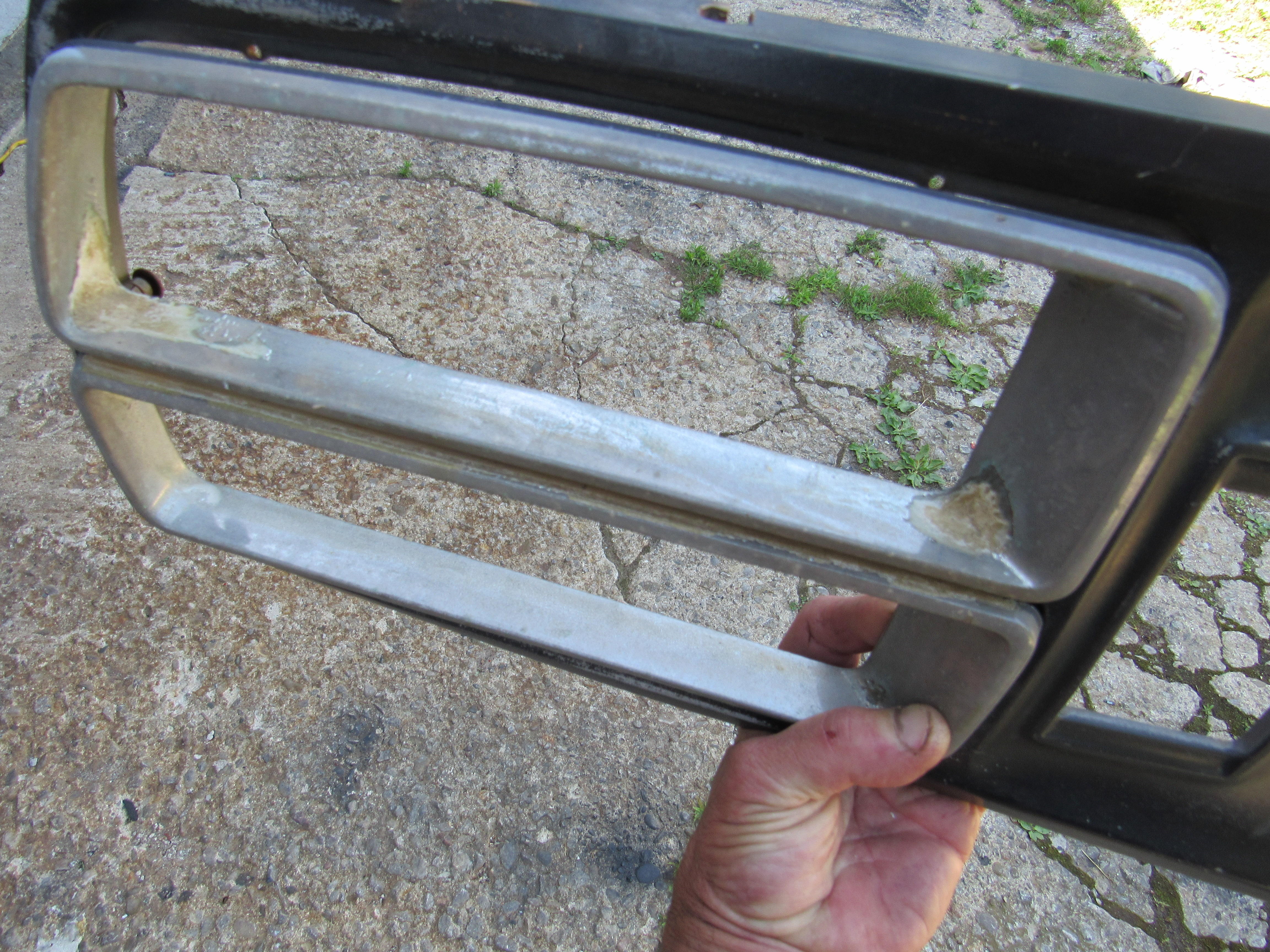

Started working on the tail lights, the chromed bezels are pretty trashed but he plastic base is solid. I tried a test using Duplicolor Chrome rattle can paint, well it is not going to fool anyone but it is presentable I think. Anyone have other ideas?  Plastic chrome plating is awfully expensive for such a small part but I'm open to ideas.
Do you think the plastic would hold up to powder coat temps? @wheee! had some pretty impressive results with the chrome powder coat.
https://www.classiczcars.com/forums/topic/50908-1976-280z-restoration-project/?page=66&tab=comments#comment-535792
And for the outer black portion... I was messing with one of them today as well. Not as impressed with the results as I had hoped, but I have two more things to try tomorrow. If I'm lucky, I may have a good option for you then?
