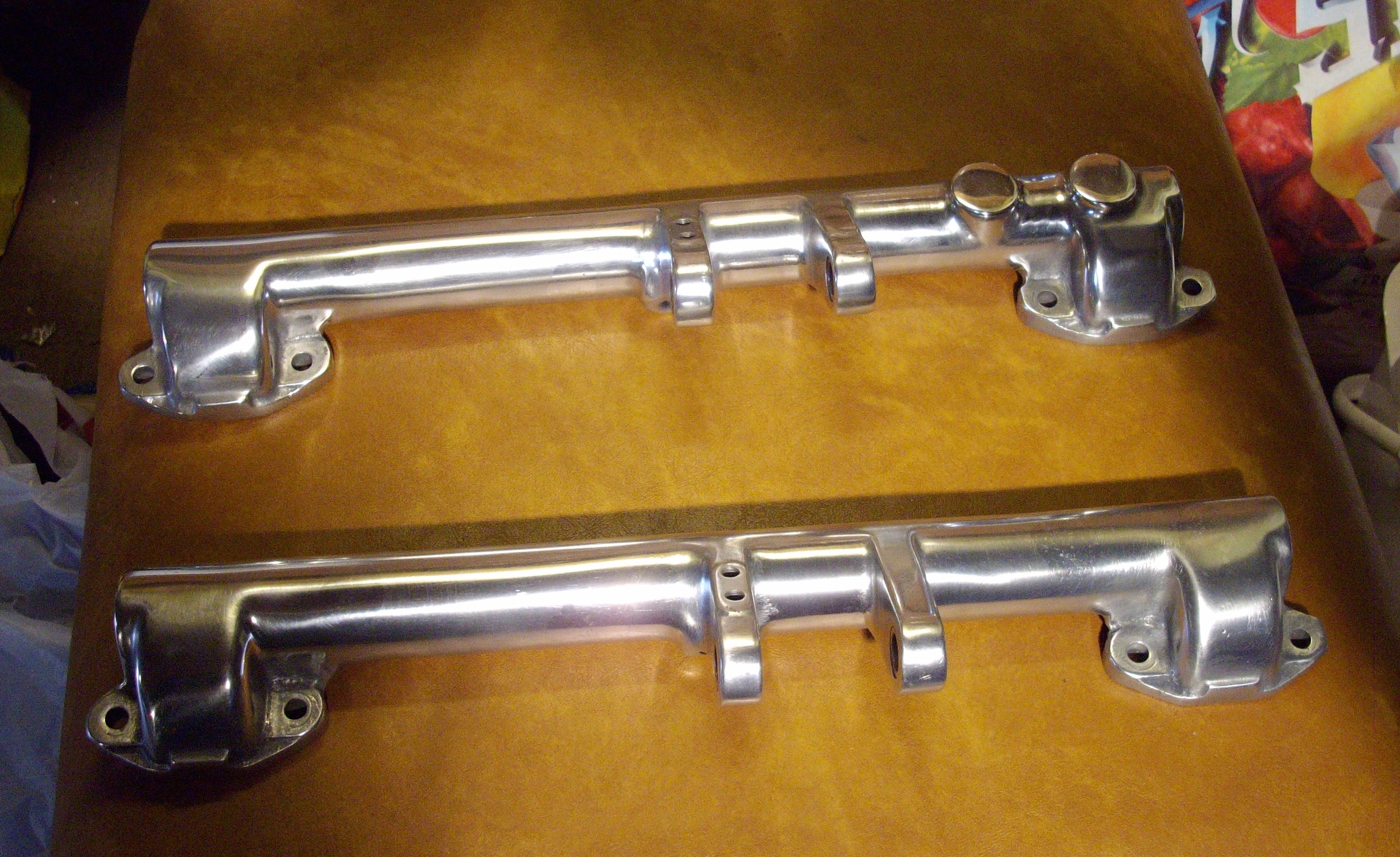

Found a couple of balance tubes in the carb bin. Thought I would try my hand a welding alum. They turned out OK, but if you look close you can see the fill area as the wire I used must be a different alloy than the original alum.
https://www.classiczcars.com/forums/topic/58637-balance-tube/
I'd be happy with that! Most folks won't notice the dissimilarity . I need to start practicing with my TIG . I want to weld in intakes myself !!

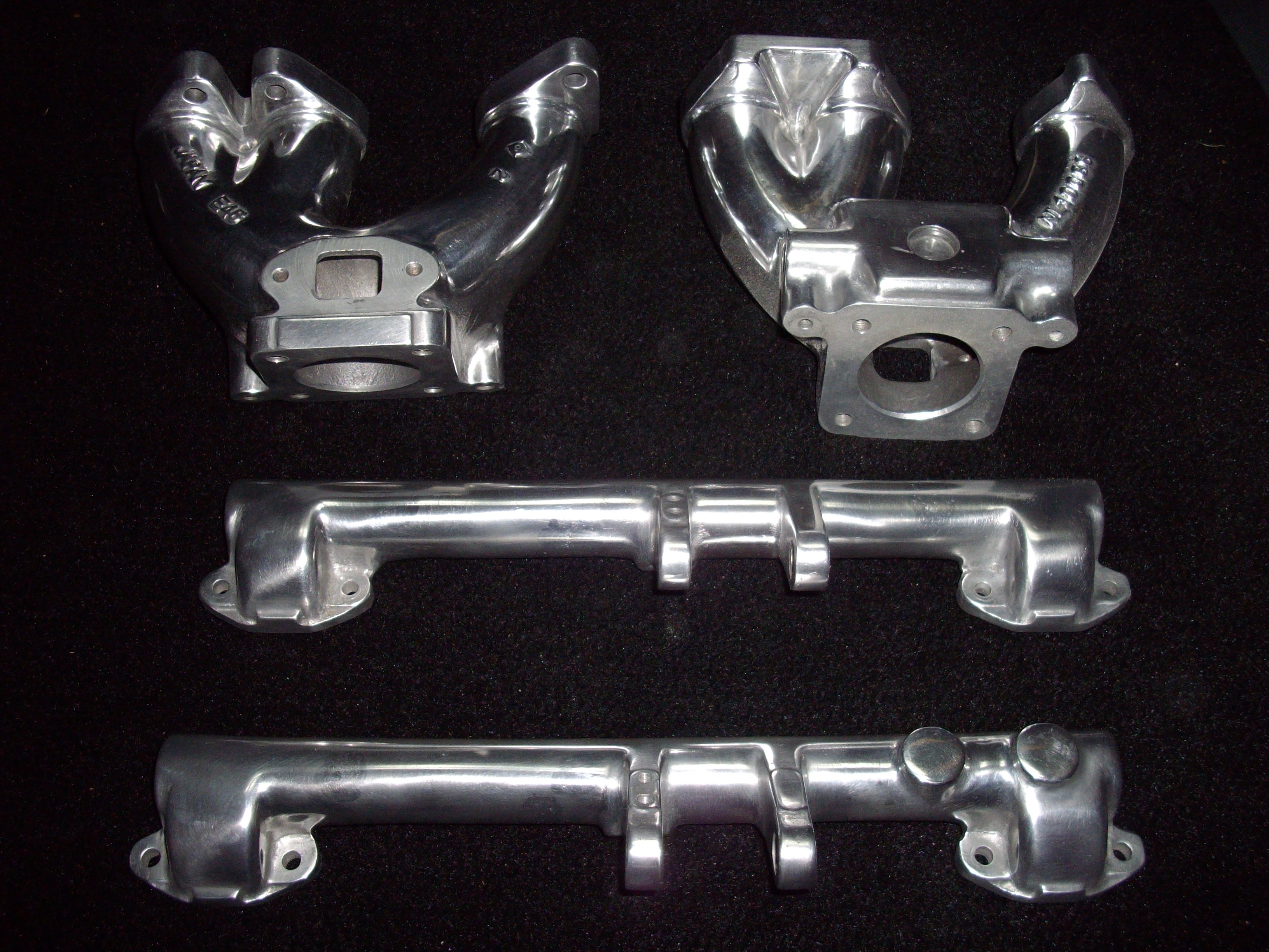

Now I see, I couldn't remember where the PVC opening was, here is a couple of balance tubes I did a few years ago, after all the grinding and sanding I couldn't bear the thought of polishing them too, kudos to you for going all the way.

I start with a large body file, than finer files until the shape is correct. Than on to sandpaper going from 80 down to 600. After than a couple of 3M super fine and micro fine sanding pads. Than on to the buffing wheel starting with the black and finishing with the red polishing compound. A clean with Mothers Alum polish to finish it off. It is quite a bit of work to get one done. The most aggravation comes from the files loading up with alum and causing deeper scratches than the file.
I heard that running the file over a bar of soap now and then keeps the file from clogging with aluminum.  Well, actually I heard this technique for grinding disks, but the theory should be the same.  Tube looks awesome...me, too lazy to attempt such a thing.  But, I am smack dab in the middle of polishing a vintage Airstream trailer.  The effort is messy, and tiring for sure...after a few hours, I turn black.
