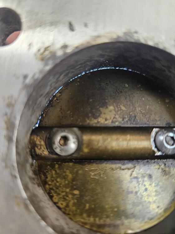

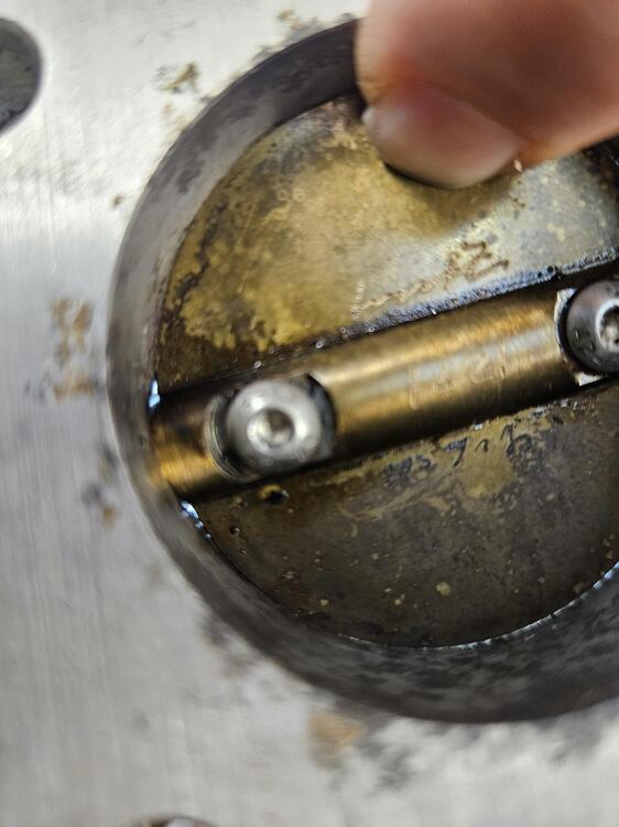

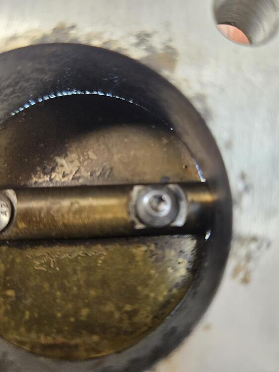

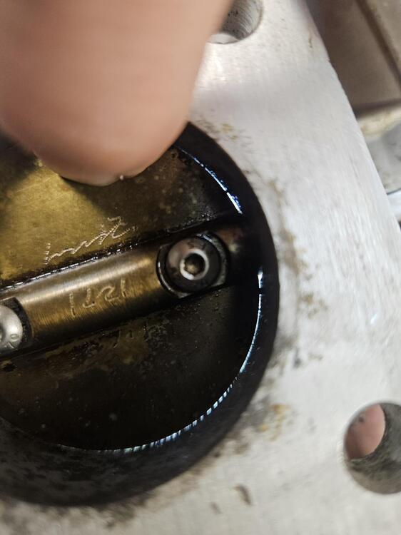

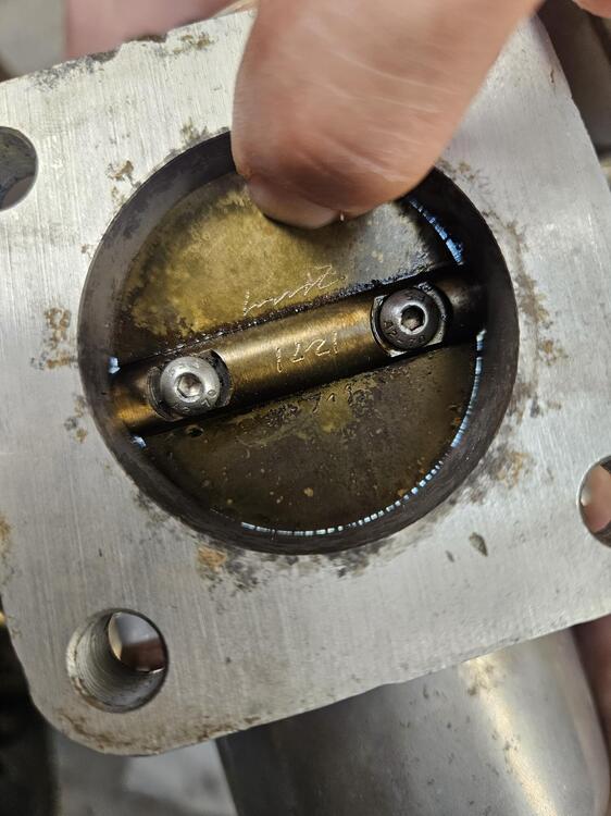

I pulled all of the carbs and intake today. This is what the butterfly looks like with a really bright light behind it. @Captain Obvious
We loosened the screws and reset the butterfly but it didn't really close up much. The gap is on the top of the bore
If you have the idle stop screws turned out far enough that they aren't making contact at all, then I would expect the butterflies to close down further than what I see in your pics. It takes a surprisingly small amount of gap to allow the engine to idle. Are you sure the stop screws aren't holding those carbs open at all? Are you sure there aren't carbon deposits on the butterfly edges or carb body throat preventing those from closing further?
