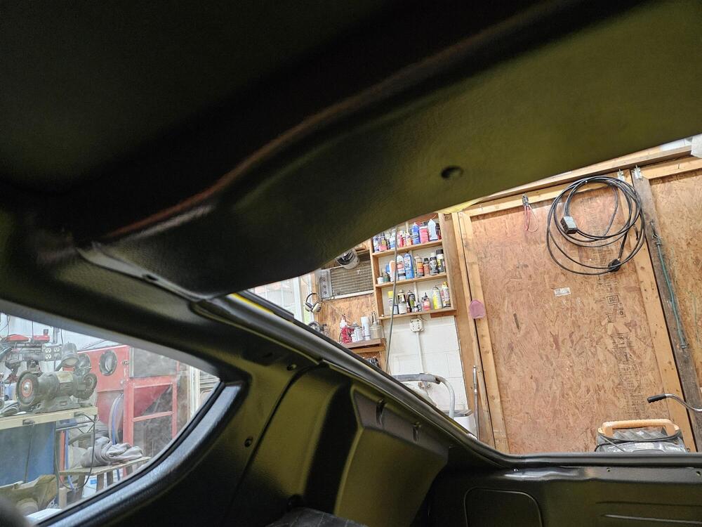

So I have been working on the interior hatch panels.
I have the Resurrected Classics kit for the Early cars

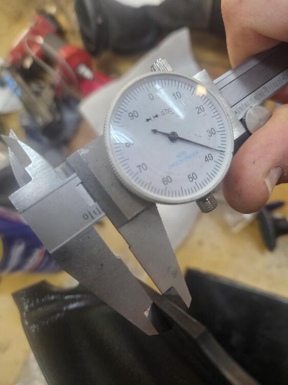

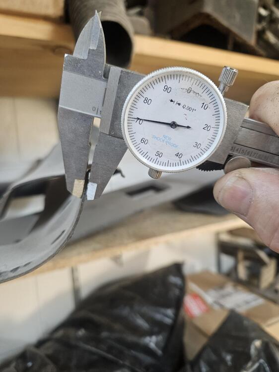

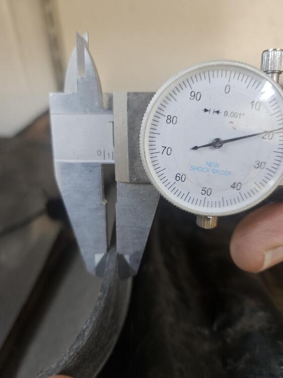

The panels look good and are solid but much thicker than stock. The new panels are softer than stock too. The original panels are very stiff and brittle
New panel thickness
Old panel thickness

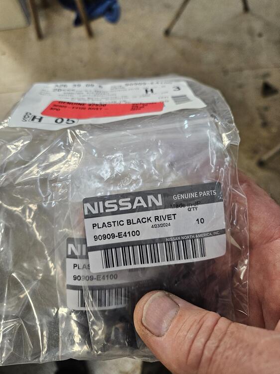

Panel pin part number

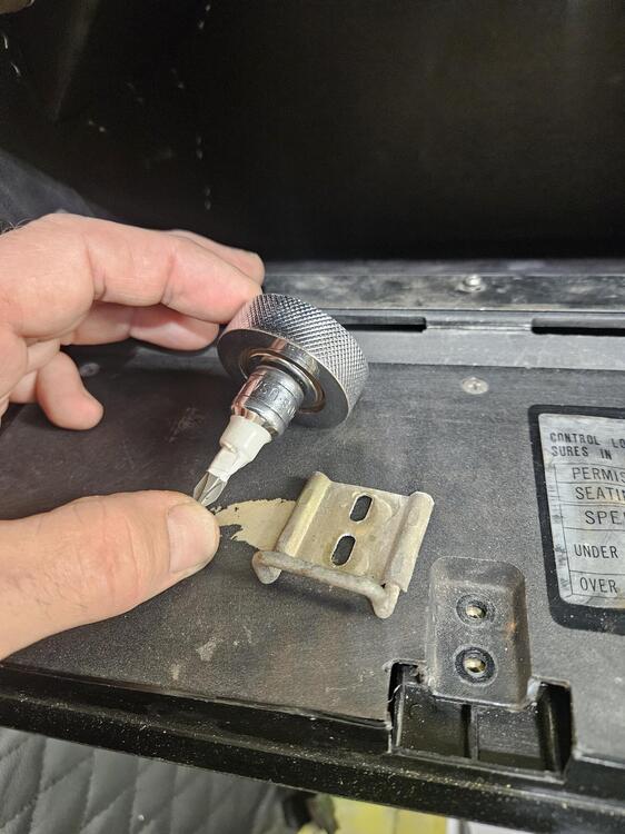

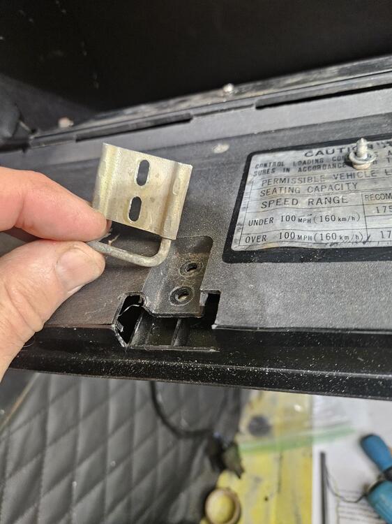

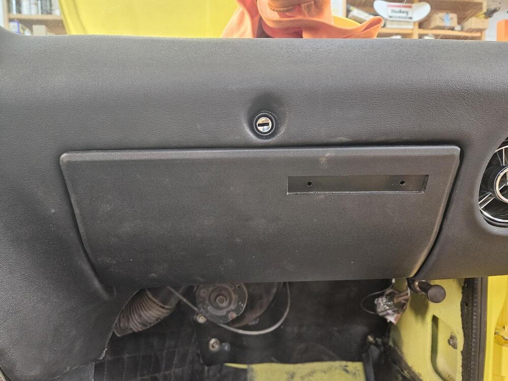

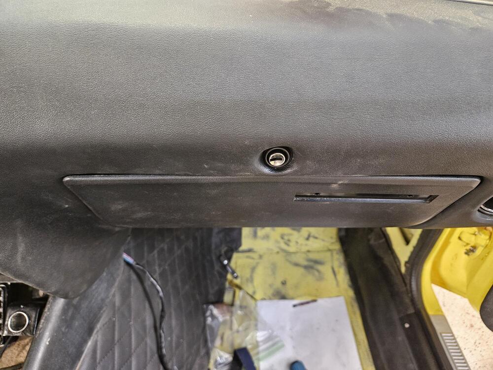

I also worked on the glove box some. I had to order some screws from BelMetric. I need to shim the lock down some and the stock screws are not long enough. I also needed some screws for the heater panel. I put a junky panel I had in it for now until I get a better one on hand. The strike on the glove box is slotted which makes it adjustable
A bit in a 1/4" socket and a thumb ratchet makes the work around the box much easier
  • Popular Post
Here is the glove box door installed. It has a chip in the upper corner and I will replace it in the future. It is also not exactly adjusted correctly. It would be nice to come up with a solution to keep these doors from warping from the glove box light. I have four all with the same warpage. Make a metal brace inside of the door?
I will restore the badge and install it later. For now I have a place for registration and the lug nut lock adapter

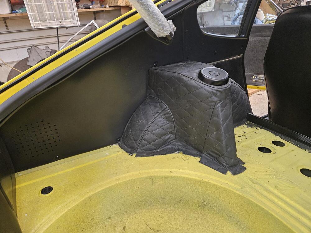

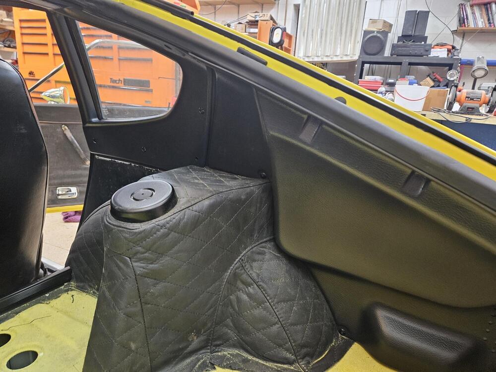

Rear interior panels
Because of the thickness of the panels some of the pins aren't long enough to hold. If I was going to do it again, I would probably thin the panels in selective areas. I used a die grinder with a 2 inch Rolok to trim them and I could have thinned them at the mounting points to make them fit a little better. It is nice the repops are available but I think a nice set of factory panels would actually be superior. They are stiffer and just fit more precisely overall. Although they are fragile. The leather on the strut towers also makes the panels a little tighter. The leather and padding is significantly thicker than the OE vinyl would have been. I ran out of pins, so not everything is installed. The interior pins are really kind of expensive. Especially if you have to push them out and lose the center pins...

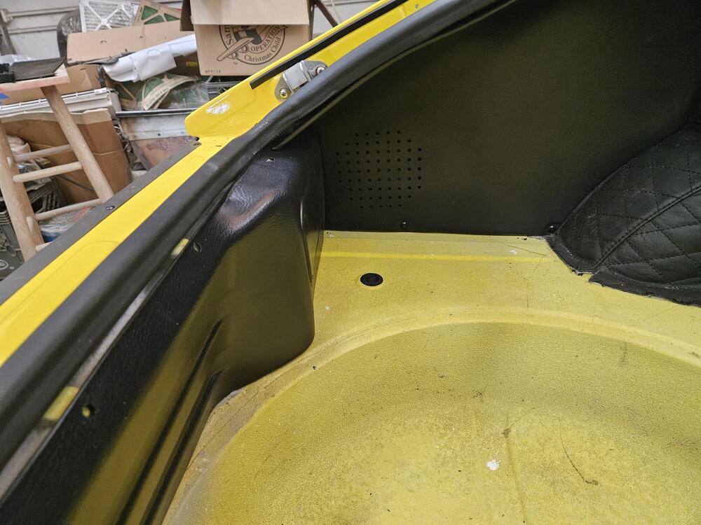

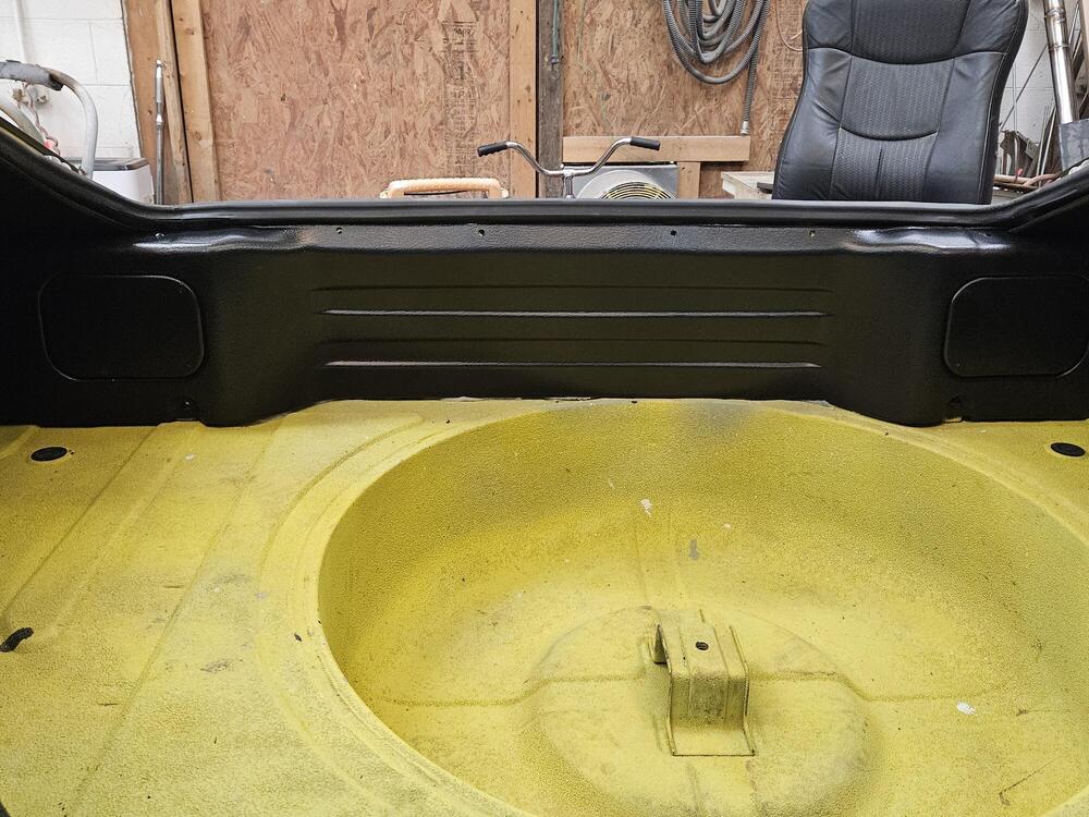

Threw a piece of carpet I had in the hatch and some floor mat pieces
Toe kick panels in place
Hatch panel waiting on pins

It's coming together nicely! Put a LED bulb in the glove box to reduce the heat that warps the door.
