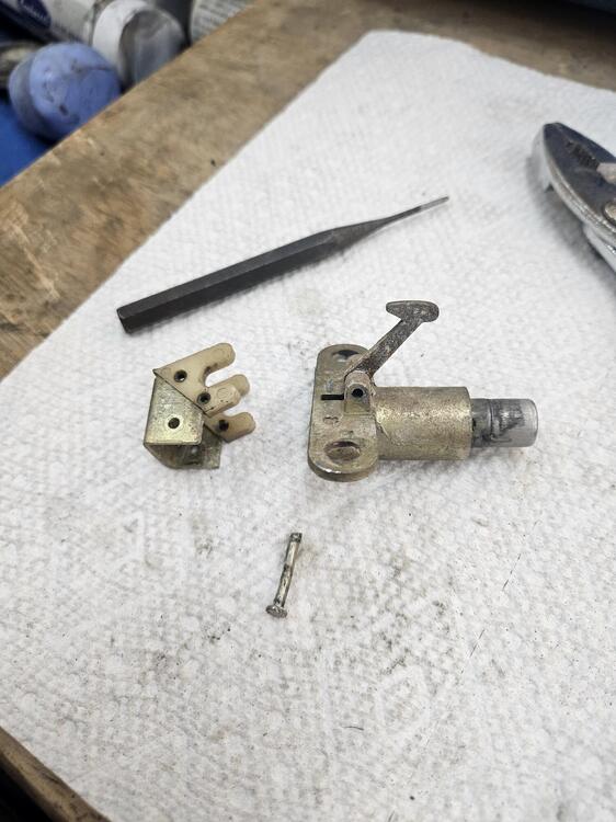

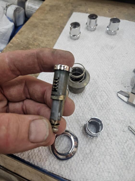

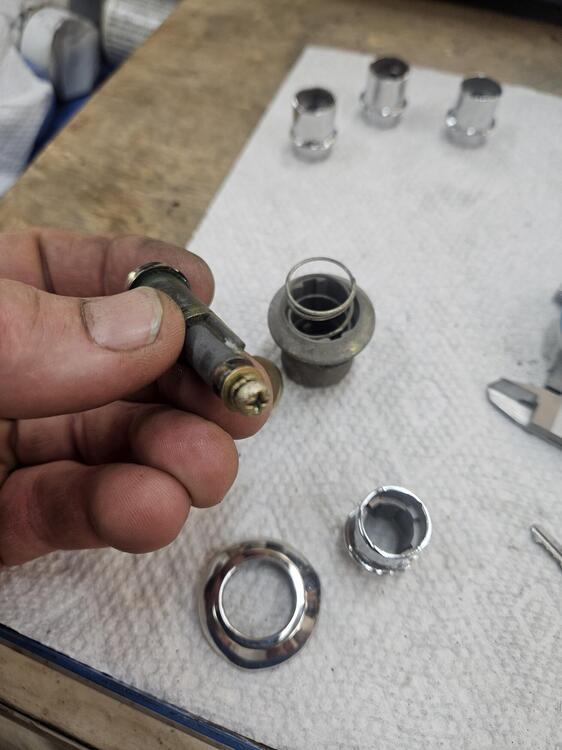

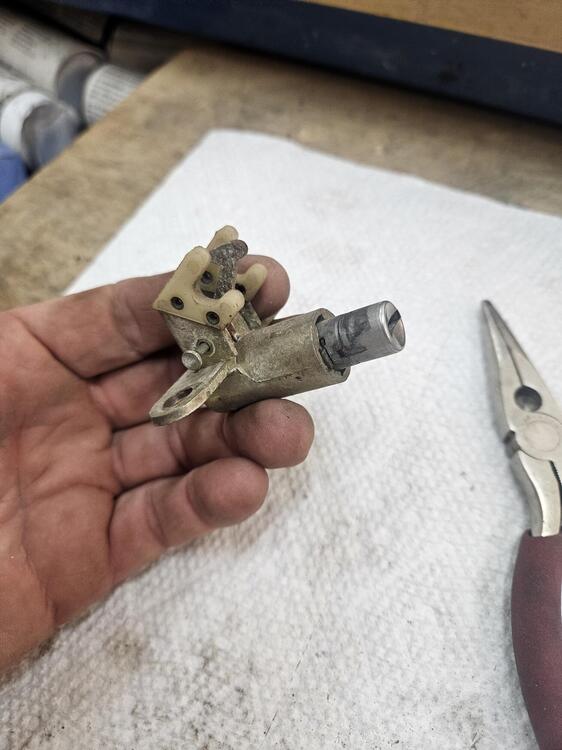

I assembled a hatch lock the other day. I had four thimbles chrome plated and I picked the best looking one.

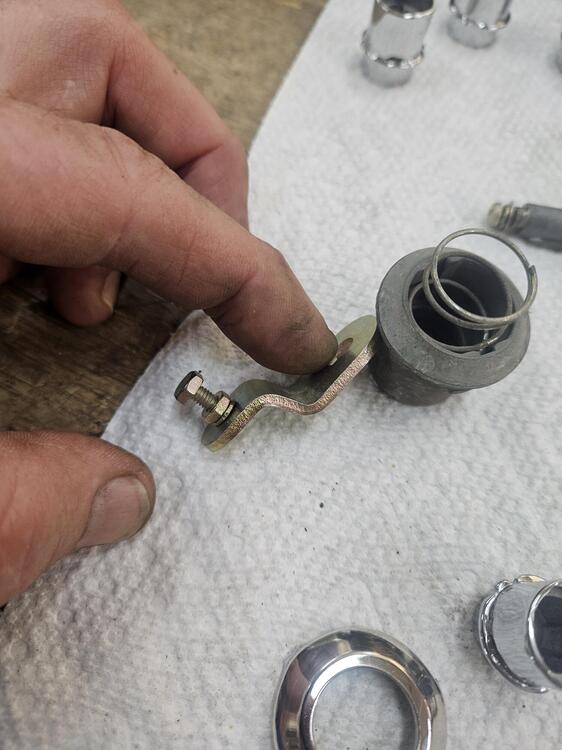

This arm is assembled incorrectly. I believe I had to move the bolt to the other side to work correctly
The larger chrome cover has ears that hold the assembly together

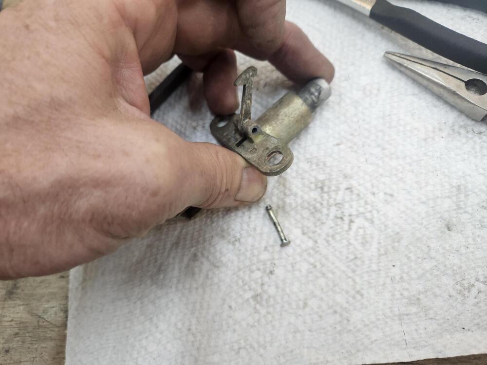

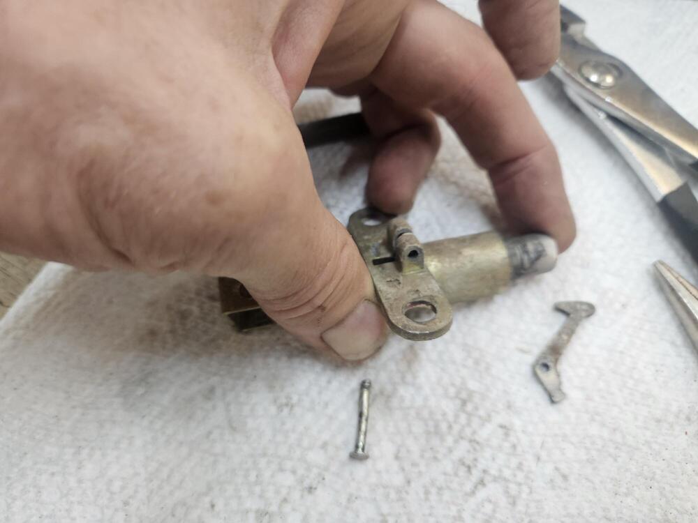

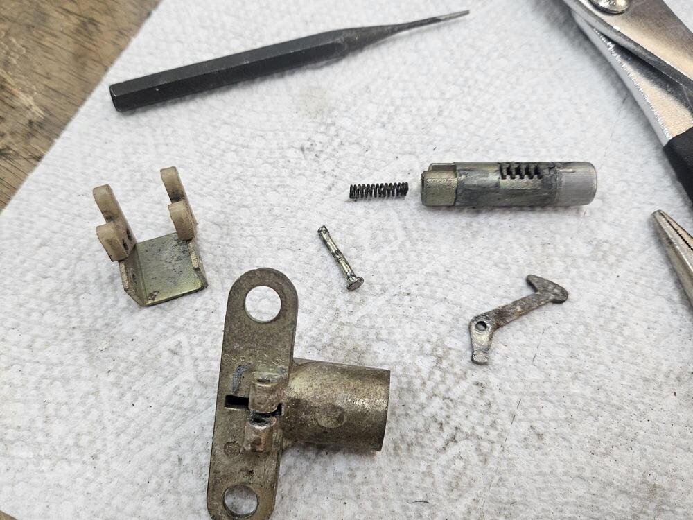

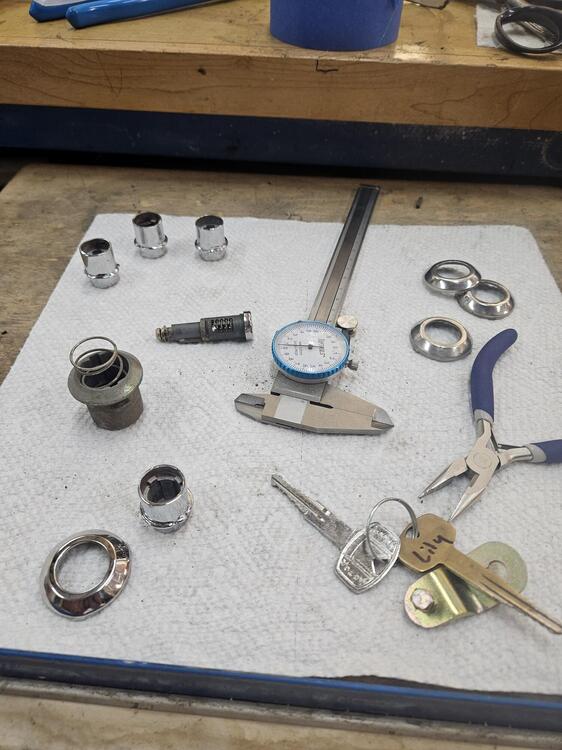

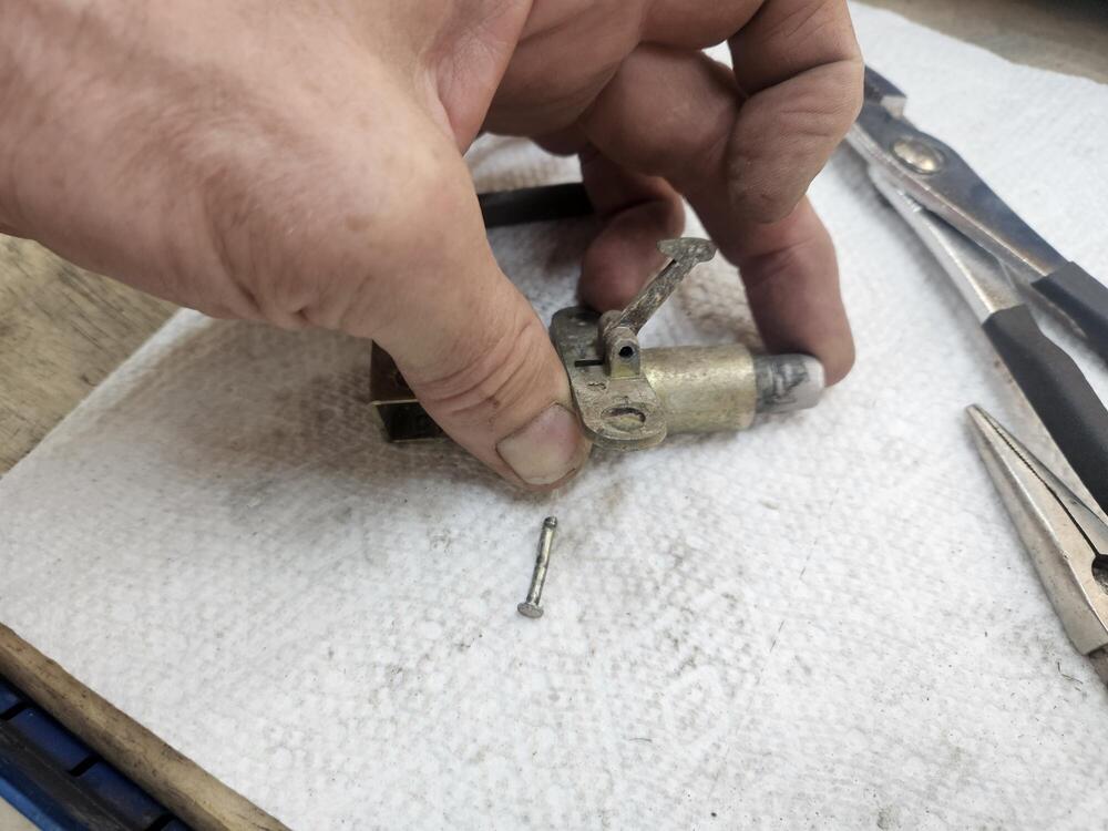

I rekeyed a glove box lock a while back but couldn't locate it. So I dug through my stuff and found another lock that would take the key I'm using and rekeyed it
Grind the end of the pin off and drive it out.
You have to press it in a little to get the hook out and the same for reassembly
Of course I found the first glove box lock in the car today... facepalm

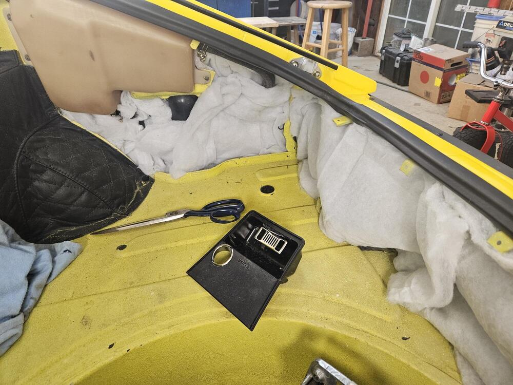

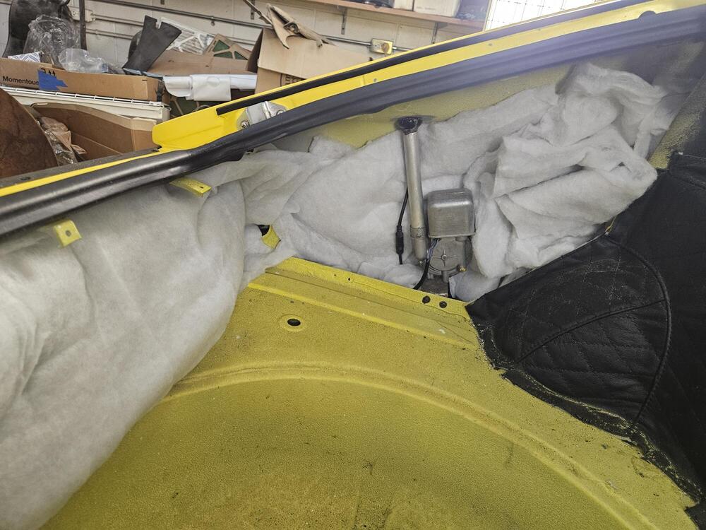

I added some sound batting in the back of the car behind the interior panels

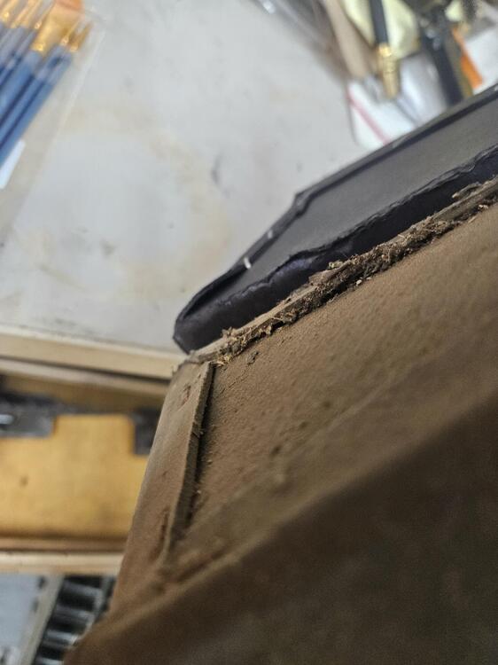

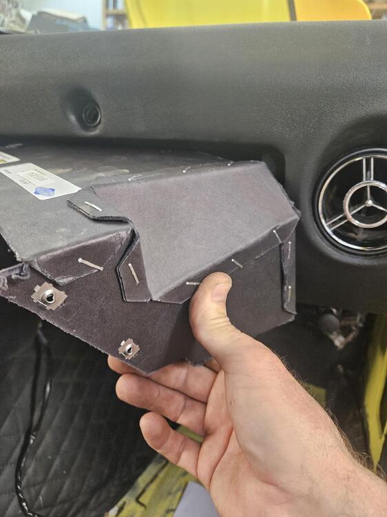

I also got the glove box in place today. I took the heater fan out but that wasn't going to work.
So the new glove box was a little larger than an old glove box I had.
That little extra doesn't help. So you sort of have to just shove it in and hope you don't destroy it. I put the left hand side into the dash opening and kept pushing it in and compressing it until the right hand side cleared the opening. I may revisit this in the future but it's in for now.

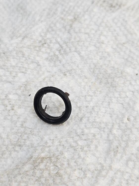

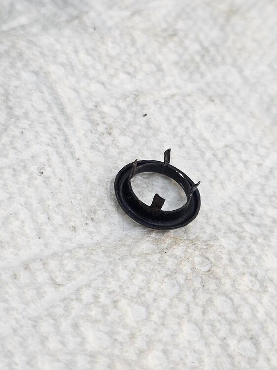

Also there is a little finial that goes around the button for the glove box lock. I've never noticed it before. I wonder if I threw the other one away with the old remnants of the cracked up dash...
I got this one off a spare dash
