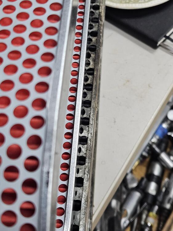

Garrett what did you ever do to resolve your air filter not being thick enough. I don't recall the solution and I have the same problem...
My air filter element is too thick 😁 So, the edge (around the circumference) of my air filter cover doesn't contact the rubber seal on the air filter back plate. Said replacement rubber seal was sourced (if I recall correctly) from Banzai in MD. Instead, the cover sandwiches the air filter element against the air filter back plate tightly. But again, the cover does not seat against the seal on the back plate.
There is a chance that the replacement rubber seal from Banzai is not as thick as the original seal. I have to investigate further. But since the air filter element is securely held and no air gaps are letting unfiltered air into the engine, I have this issue de-prioritized.
So... you have the opposite situation?
There is a difference in thickness of the air filter elements (and thus the air filter housings) across the years of the 240z. I am uncertain of the details.
I believe the narrower one is Zcardepot aftermarket. I bought a NOS air filter off Ebay that should be correct when I get it
