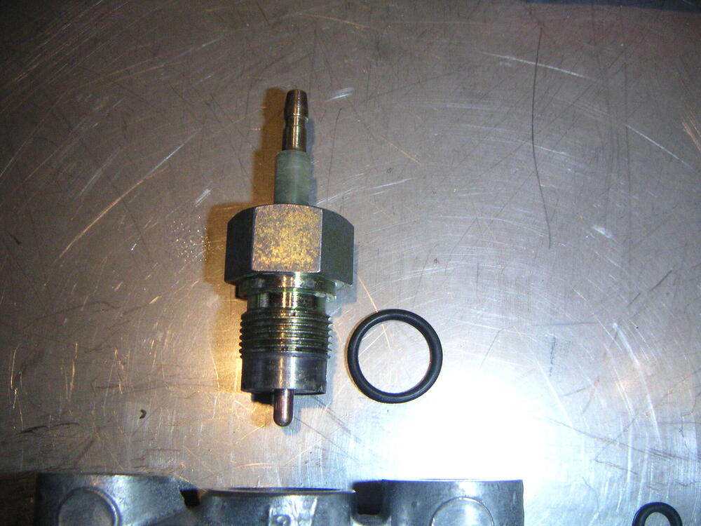

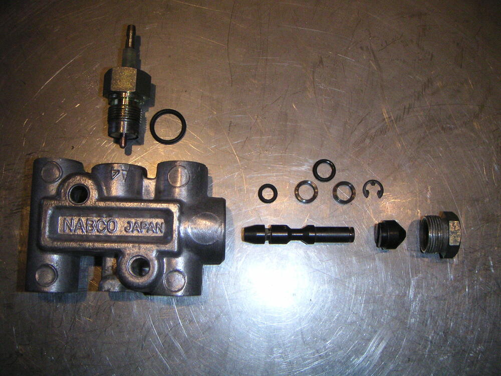

My brake light was always on unless I pulled the signal wire off the safety brake failure switch. The parking brake wouldn't light up the brake light either.

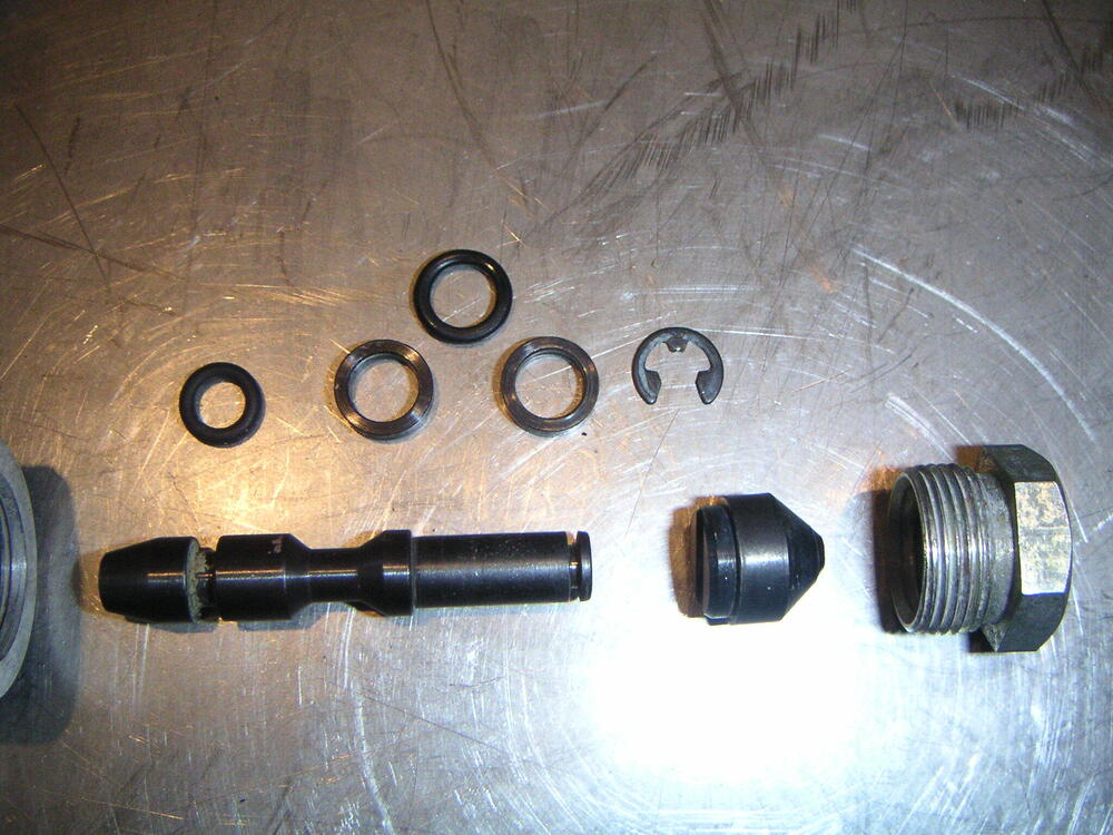

After pulling the sensor and exploring some and stealing a switch off the brown Z and opening it up some Cody could see it. We determined the sensor threaded in too far.
I rebuilt this in Jan 20, 2018. I used a small viton o ring instead of the black ring on the end of the sensor. It should probably be a small hydraulic D ring instead. If it threads in a hair too far it will close the ground circuit all the time. We took the black ring out of our stolen switch and that fixed the always on brake light.
The parking brake switch had to be wire wheeled to make it work but we still didn't have a ground path. So that meant we had to pull the bolts out of the parking brake mechanism and clean off some paint so that we had continuity. Then the parking brake switch lights the brake light as it should. :)

" I rebuilt this in Jan 20, 2018. I used a small viton o ring instead of the black ring on the end of the sensor"
Charles. When doing brake systems, you should use EPDM rubber. Preferably, choose peroxide-cured EPDM, as it offers better resistance and holds its form longer than the sulfur-cured material. Viton (FKM) is not suitable for brake applications, as it will eventually degrade when exposed to brake fluid.
I have successfully used O-rings on that switch before. It is unusual that yours travels too far and makes contact with the shuttle.
I have the sizes somewhere if you want them.

Drawing with o-rings
Chas,
That's for the direction on Oring material
My switch is different than the one you posted. I wonder if any of the Orings are the same?
