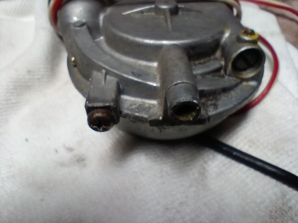

I'll try my best to describe the mounting process. You will need a "L" shaped bracket strip to secure the foot/motor of the antenna to the body. The small leg of the "L" attaches to the antenna via the screw near the drain port - see the pic, screw on the left. The long leg of the bracket attaches to the car body just inside the fender well cavity. Feel along inside and below the pinch weld and locate a threaded stub bolt shank. That is the mount for the bracket. The factory used a wingnut to secure the bracket to the stub bolt. This is the ground point for the motor so it is important that the threads on the stub bolt are clean. Run the drain tube thru a grommet in the hole at the bottom of the cavity. Hope this helps.

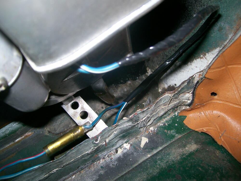

The metal strap just keeps the base of the antenna body from moving fore-aft or side-to-side. It doesn't support any of the weight. Instead, the weight of the antenna body is supported entirely by the fender mount (where the mast pokes through fender). In the picture below, the strap is obvious, but the body-mounted stud is hidden. If you look closely, you'll also see the drain tube and the point where it exits through the grommet at the bottom of the body cavity (this is also the place where the little centre pins for the interior panel plastic rivets go to die).
