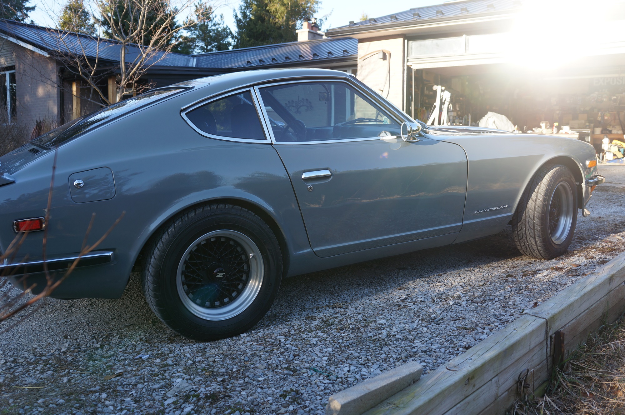

I thought I would post some pics here and a description of what has been done to the car and see what you guys think, I know you will be brutally honest and that is a good thing, don't pull your punches. It's hard for me to objective about this car because I have put so much of myself in it.
I have owned this early 1970 numbers matching Datsun 240Z, HLS30U01955 03/70 since 2002, in that time the car has under gone a complete rotisserie restoration. I have a new Z project in the planning stage so I need to move this one along to make room.
The odometer reads 58,000 miles, that could be 158,000 but I have no way of knowing for sure, the original engine may have been rebuilt at some time in the past 46 years as the compression is excellent and runs very well.

An absolutely beautiful car!

 I see quality Zs in the 15K-25K all the time. Some of those are 280s. The excellent restoration and the early build date should make this one more valuable than those. I'd be surprised if you couldn't get at least 25K for it. Possibly a lot more if you find a buyer, with a fat wallet, (top 1%) that has been trying to find a good one. You might contact Jay Leno. This car is soooo good he may be interested in it. And what a great home to send it to.

That is a beautiful car -well done!  You did not share the VIN or build date with us but the carb snorkel suggests early to mid 1970.  You build list is impressive to say the least.  Hagerty is showing 1970 cars in condition 1 Concours at $55.5k, condition 2 at $34.2K.  Your car certainly exceeds condition 2 so I would suggest your price will be in the range of $40k or more.  As to shipping etc. - leave that to the buyer to arrange, FOB your driveway!  As to money handling, talk to your bank about verified funds transfer options.  No Nigerian Prince deals!!!

I agree with Jim probably $40k or so. I think his estimation on condition is very good also. If I were gonna put it on Ebay I would list it on Ebay UK also. I have sold cars out of the country, they can load them on the truck when the funds are secure in my account. The seller took car of his own shipping arrangements. Take pictures of the car and the mileage prior to loading and forward them to the buyer. Buelller !!!? If you want, open a separate account for the money transfer so they don't have an account number where you keep your regular money. The car looks great, I don't know if the color will work against you or not. Is it close to a factory color?

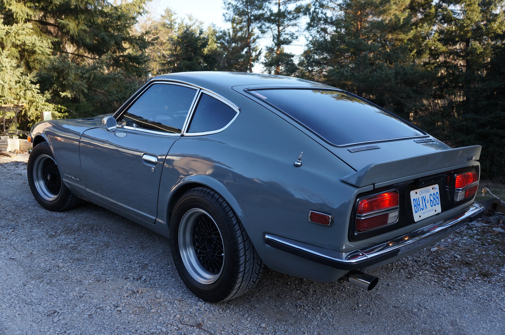

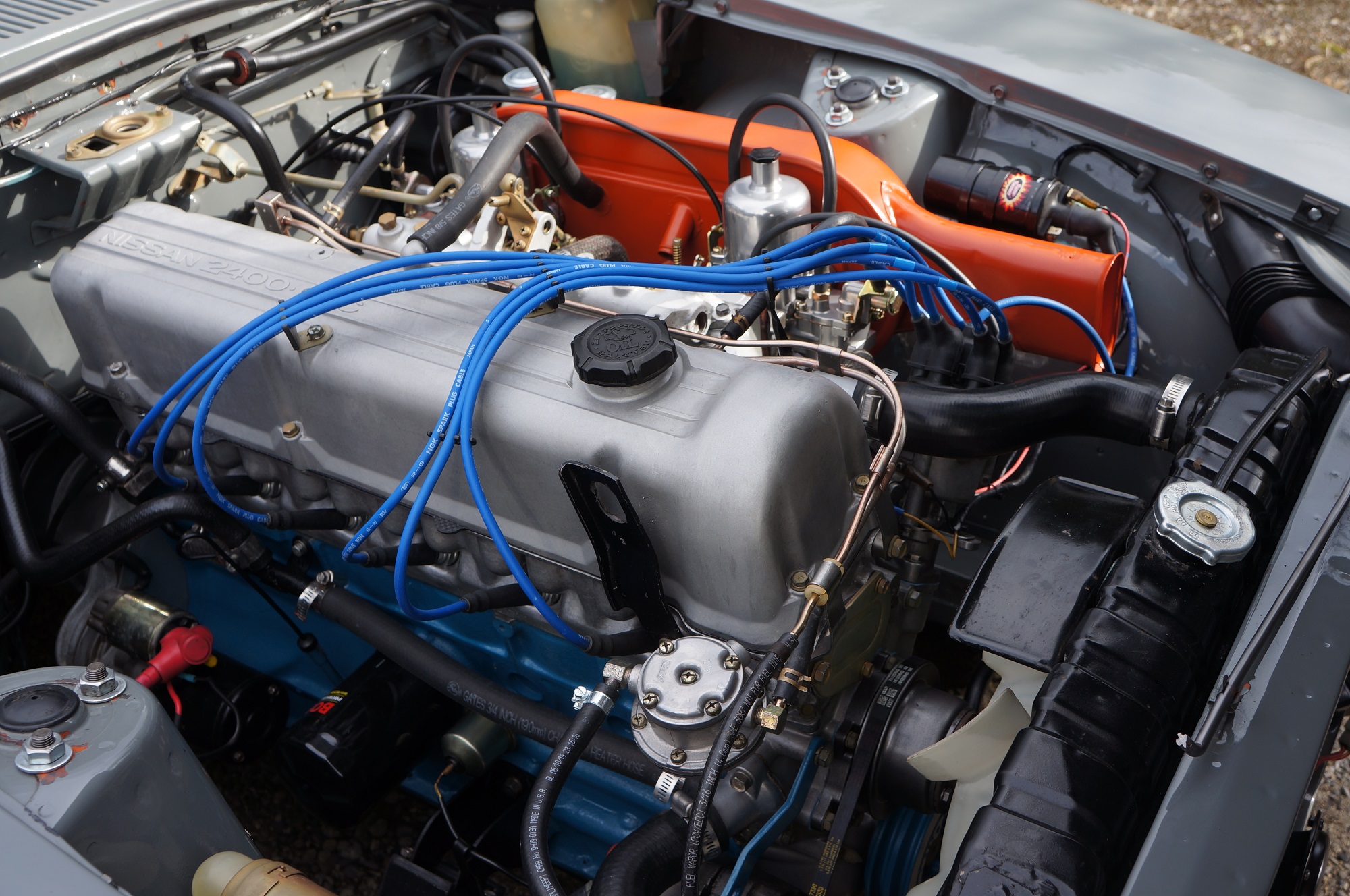

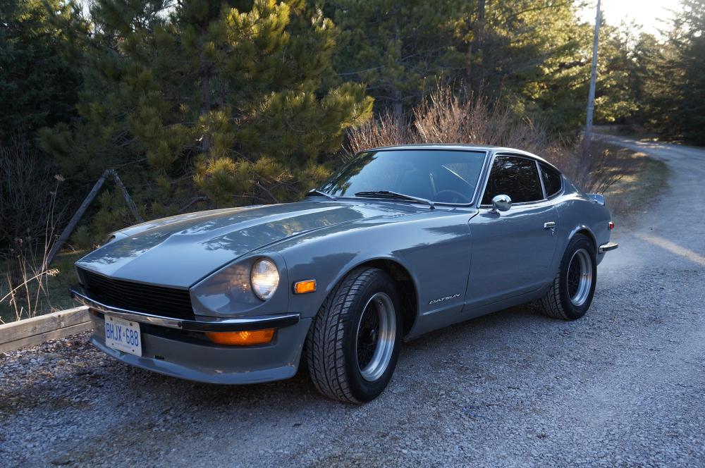

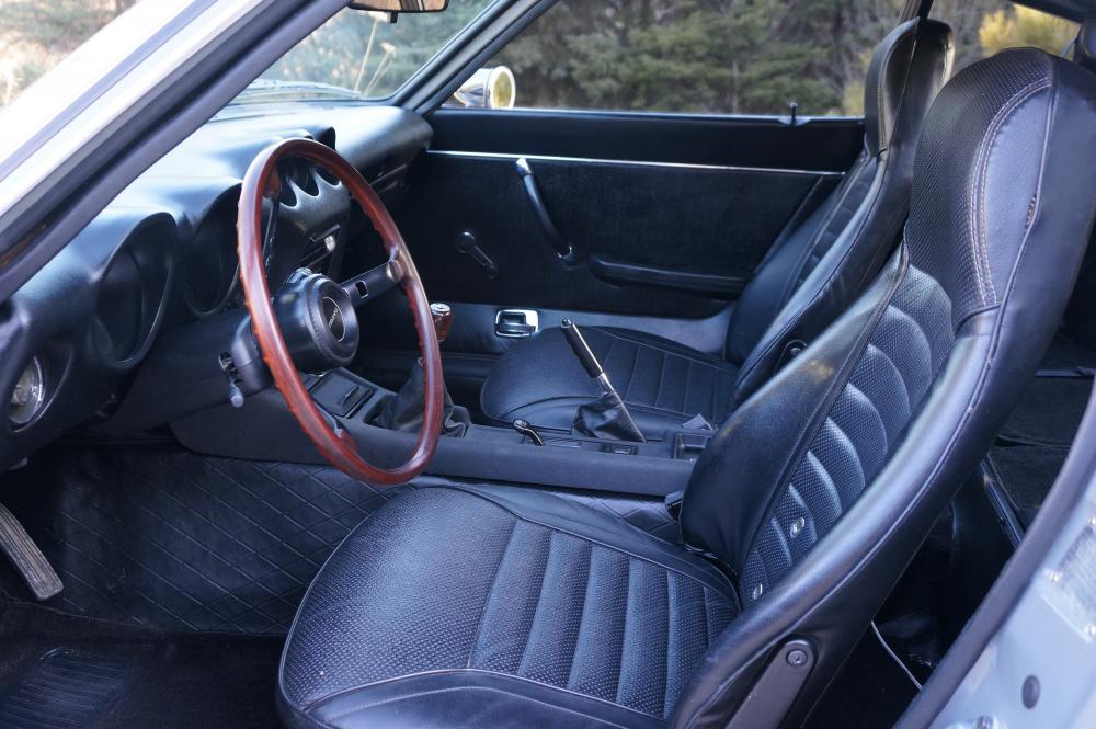

You might want to touch up the paint by the nuts for the front strut mounts. Maybe add a hood emblem. Can you grind down some of the welds where the new floor was patched in? A little grinding, some filler and undercoating would go a long way.Those welds really pop out to me. Maybe add a shim to the left door upper hinge. It appears to set in from the fender in the first pic. Some of the pics have too much sunlight and others had odd reflections that make it hard to see the body lines. If I'm buying a car from far away I want to see as much as I can in the pictures. It might help to paint the grill and tail light panels the original gun metal gray. Or it might not. It's hard to say what the buyers will like. Try to get the wrinkles out of the carpet for the picture. The engine would look cleaner if you removed the black engine hook by the fuel pump. I know that I'm nit picking on most of this stuff but it's a really nice car that can bring some really nice money!

You asked for advice.  I suggest starting out with positives in your description.  Not "One of the wheel caps is missing"!
I'd list all of the Series One, early 240Z bona fides first.  That's going to be your type of buyer, probably.  Hit them with the Serial number right off the click.
I'd attach a video link of the engine running also.  Maybe even a moving shot.
