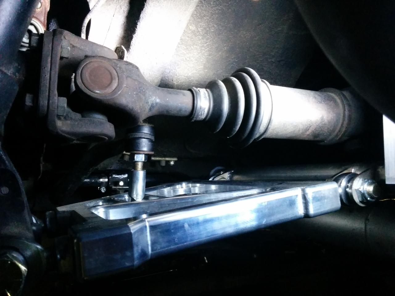

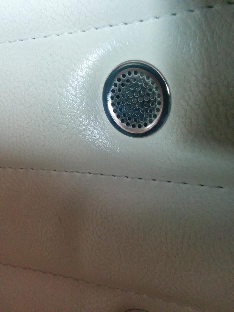

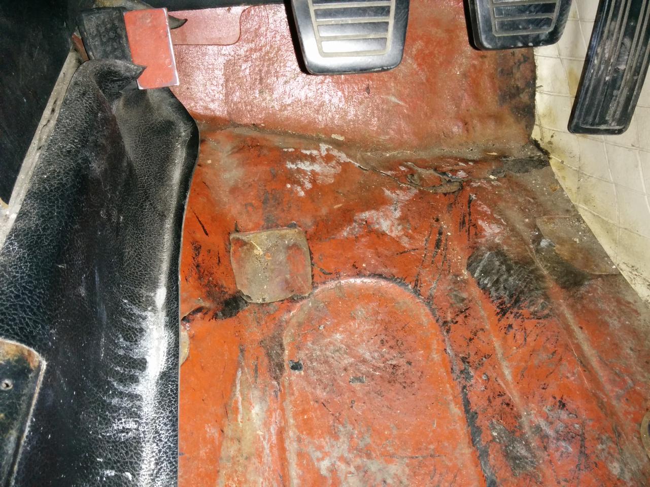

gacksen Posted October 19, 2014 Author Share #21 Posted October 19, 2014 got some time today and fitted in the rear sway bar again. mounts differ and the bar had not been supposed to work with the ACZ parts. made some changes widend some polybushes from another car and finally got it in. more work as expected as the whole suspension and exhaust had to be taken off again. doorcards and the whole intererior except seats consonsole dash headliner is out the car. with the headliner will wait until the new windscreen will arrive. anything elese get´s covered in black leather. floorboards will be cleaned and painted. further some dynamats will come in. does anybody know where to get those seat back vents of the original seats ? Link to comment Share on other sites More sharing options...
