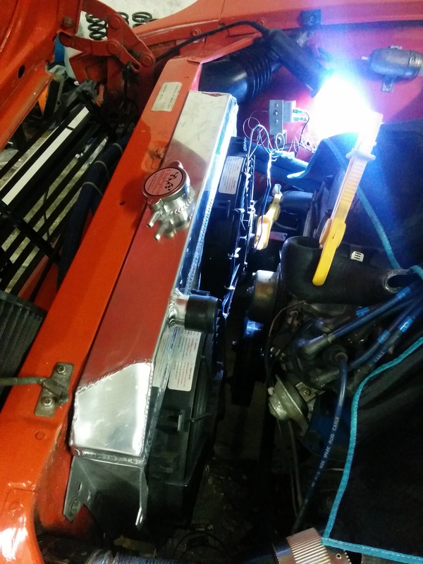

Put in ally 3 row rad ---> done

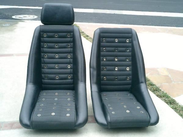

have already all the outer ruber and interior parts except for the carpet set doorcards and the new seats. will throw out the original seats and get in some
sparco sprint as with the original ones if you go raound corners fast i am sliding on the seat. will get them redone in this style

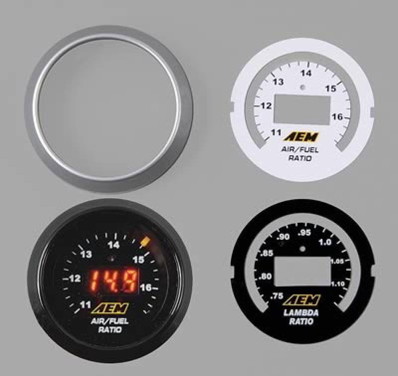

Also on the table is already the AEM wideband lambda just for piece of mind

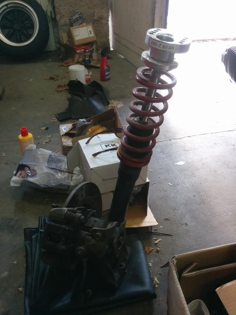

Suspension also needs some attention as the eibach rates that are currently used are 275F and 250R.
Springs in combination with the coilover conversion are to stiff and to short. I think will order some longer
ones with 225F and 200R as if to soft the illuminas could be made harder if needed. currently running them on
setting one but the car does not feel right.

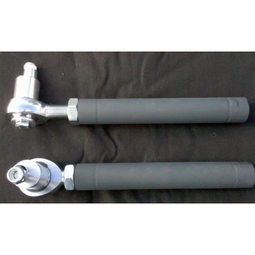

Maybe sombody knows where i can source this kind of tie rod ends except from japan ?

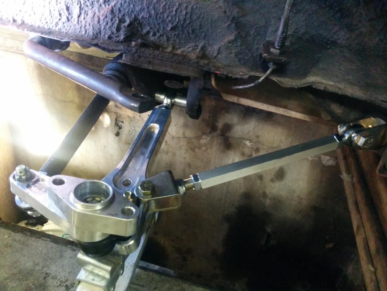

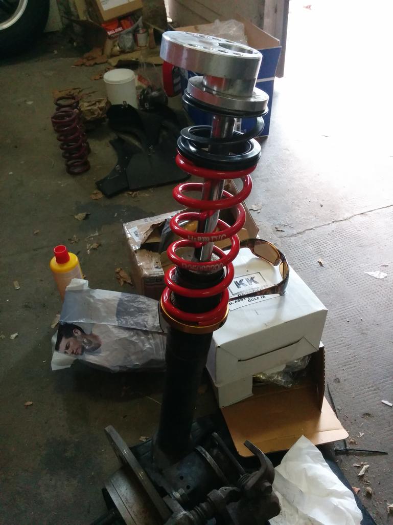

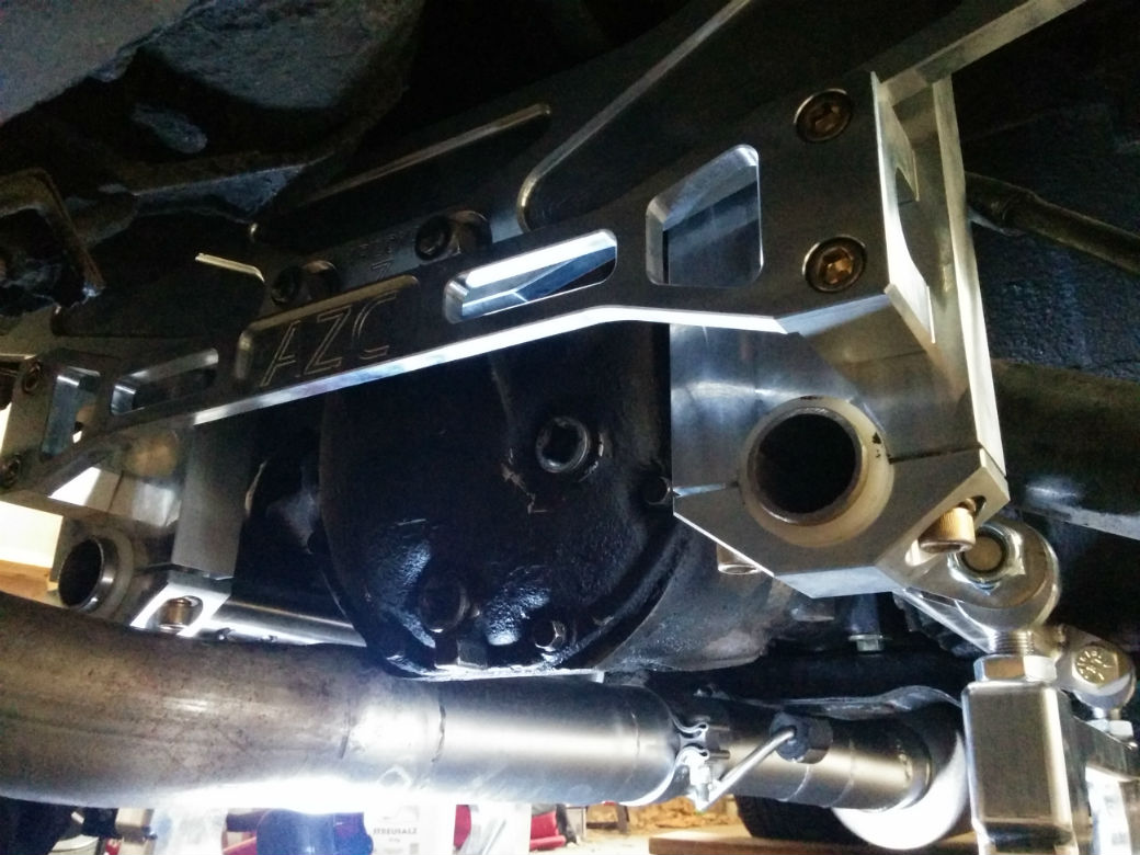

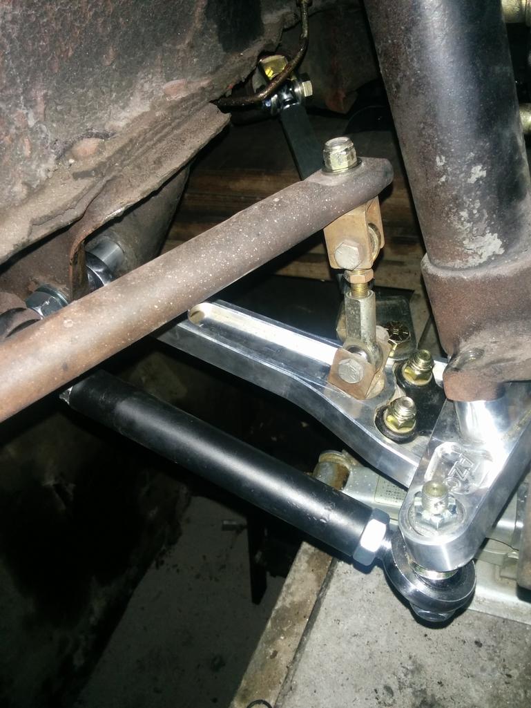

as the front is currently done and revised with H&R race springs as the eibachs had been to stiff started to work
on the rear end with some goodies :D
now with the correct spring setup ;)
