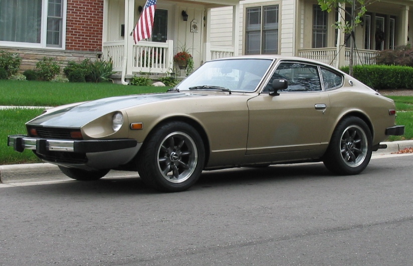

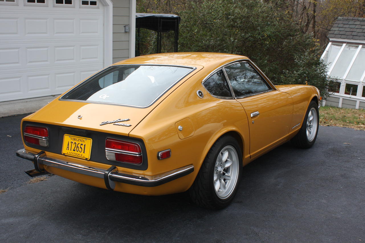

Diseazd Posted January 19, 2014 Share #10 Posted January 19, 2014 205 55 16 tires with +6 Panasports.....no problems! :bulb: Link to comment Share on other sites More sharing options...
Diseazd Posted January 19, 2014 Share #11 Posted January 19, 2014 205 55 16 with 0 Panasports.......no problems! :bulb: Link to comment Share on other sites More sharing options...

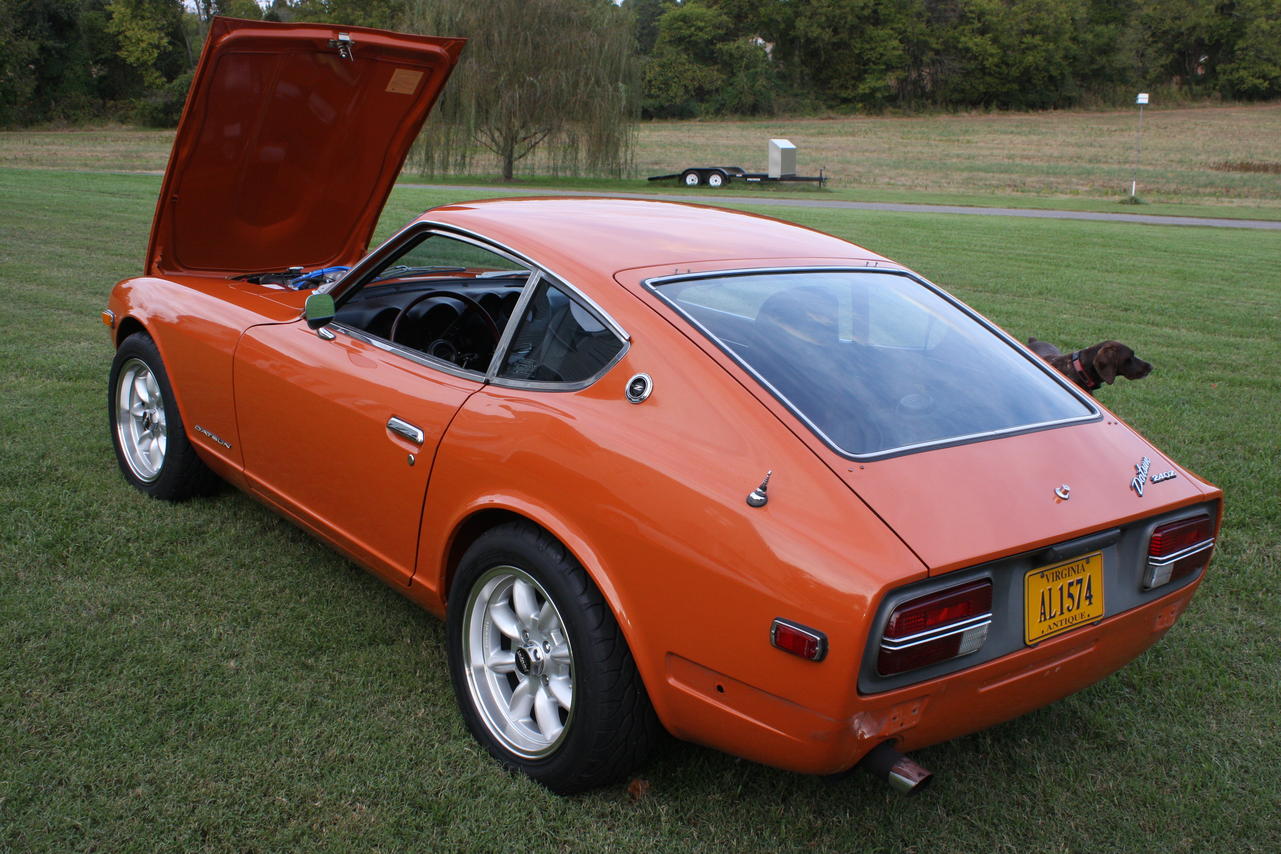

Diseazd Posted January 19, 2014 Share #12 Posted January 19, 2014 (edited) 225 50 16"s with 0 offset Panasports...... This car would rub until I installed coilovers and tucked them under the fenders with camber adjustment. If I change tires, I'm going to install 205 55 16's........best tire IMHO....good wheel well fill with no rub issues. :classic: Edited January 19, 2014 by Diseazd Link to comment Share on other sites More sharing options...
