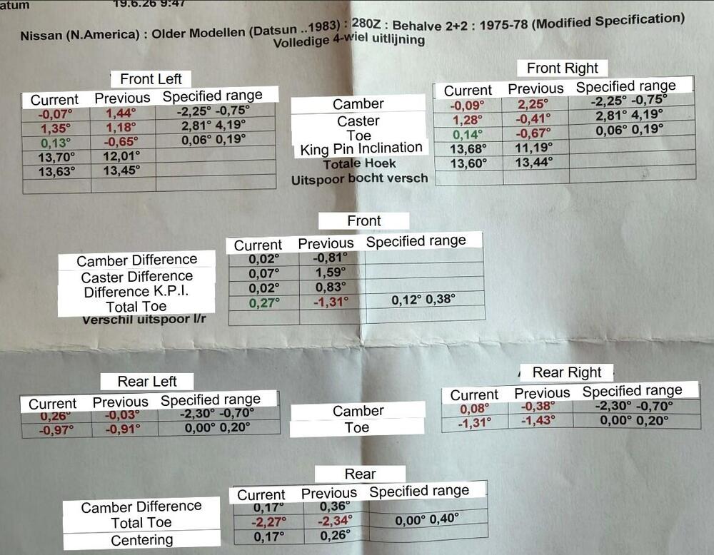

After getting my 1977 280z past it’s last inspection ever and back on the road, for the first time since owning it, I took it to work to see how she drives. And man the engine feels great and incredibly healthy. Unfortunately the alignment was incredibly bad. I had her aligned during the inspection and the guy said het put everything to zero as a baseline but the car was all over the place and was very hard to turn to the right.
I took it to a tire shop very close to work since I know they also do custom suspension and alignments for high performance racecars. And my god the previous guy messed up bad. The alignment wasn’t even close. Below I’ll add the alignment sheet with the terms translated to English, please note that a -0.67 degree toe means a toe out of 0.286 inches which is massive for the front wheels.

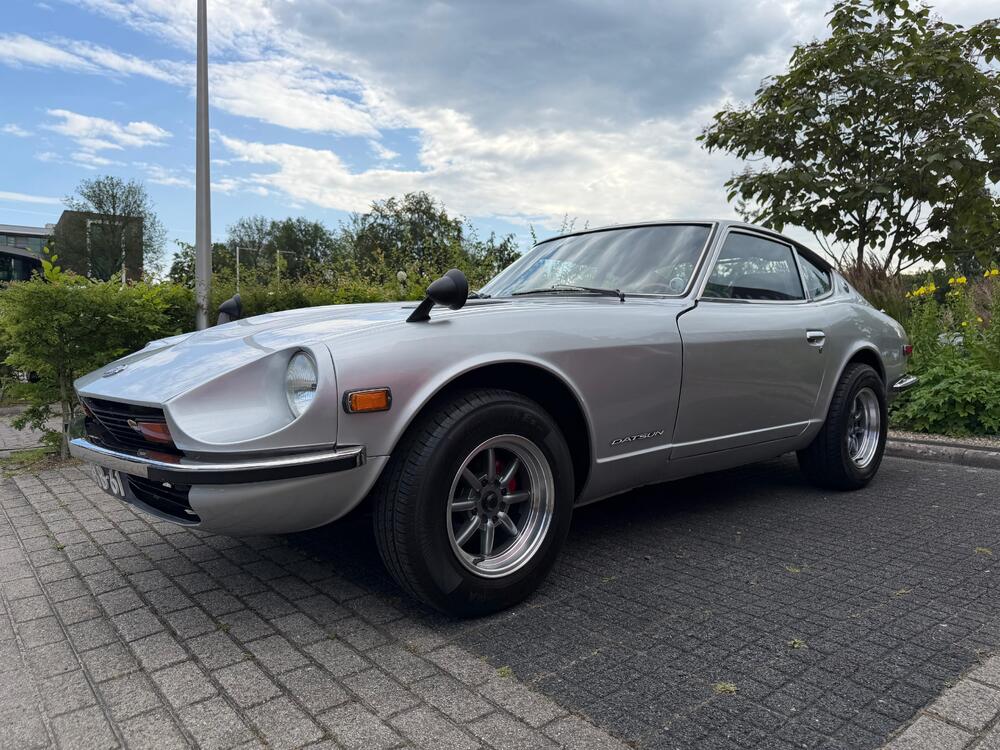

The car drives a lot better now even though the rear is still off. The front office didn’t quite get what kind of car I was bringing in and just how custom the suspension (full Apex Engineered control arms and front crossmember) was and thus only scheduled a standard half hour alignment. I’ll be adjusting the rear trackwidth myself so I’ll unlock more rear toe adjustment and then pop back into the shop for a final alignment. After that I’ll be saving up to refurbish the shock absorbers as the rear once are totally gone. Eather that or a set of Intrax or KW coilovers.
But the most important thing is that I can finally enjoy this beauty!
