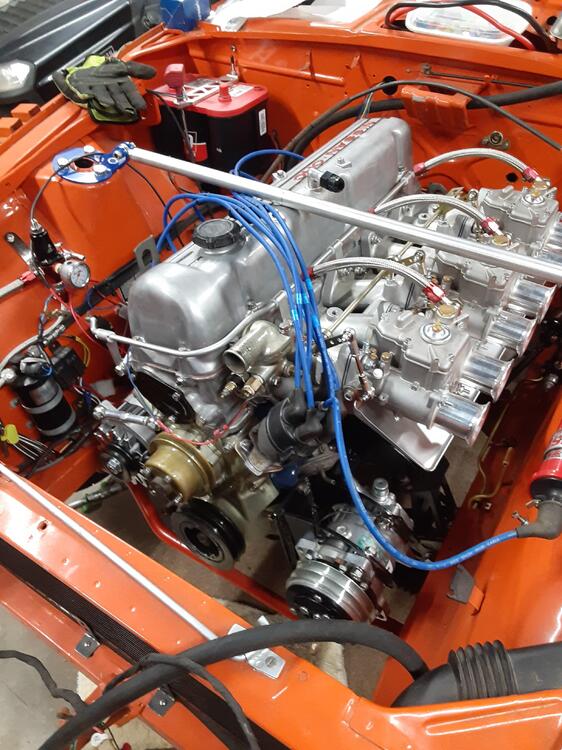

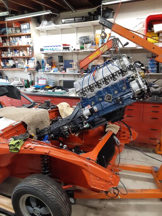

With a helper, I got my engine/tranny assembly into the car. Now I can (1) add that 1.5 L of Redline MT90 to the tranny, (2) fabricate and/or attach all the various remaining fuel, coolant, vapor and A/C hoses that are needed and (3) begin all the electrical hookups.
