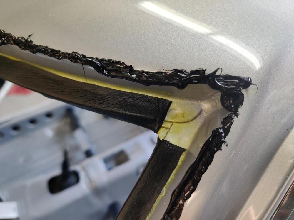

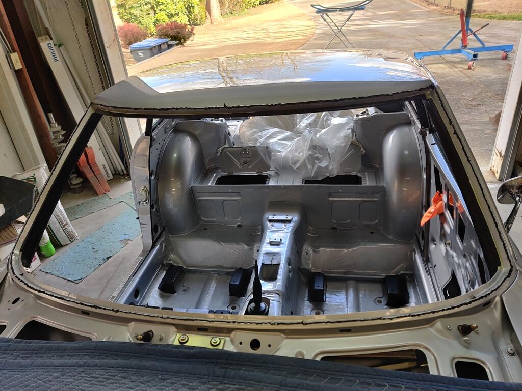

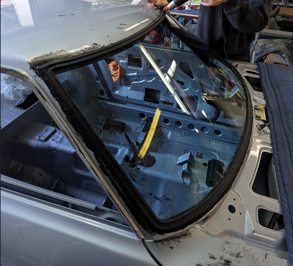

I installed my windshield just days ago.  If you look closely at the picture in the factory workshop manual to see where sealant is supposed to be applied, it is on edge of the downward turn from the outside surface of the car body, not on the pinch weld.  In theory, when the weather strip seats, adhesive flows to both sides of that corner.
A couple of pictures from my install, and yes, it was a complete mess, but only on the outside, and everywhere that any that got on my gloves migrated to as well.  I used this 3M adhesive.  This 3M adhesive remover removes it easily without hurting the vinyl or paint.
The 3M website says "Fast-curing formula offers a 10 to 20 minute working time".  I found that it starts hardening that quickly, but I would call the working time more like double that.
