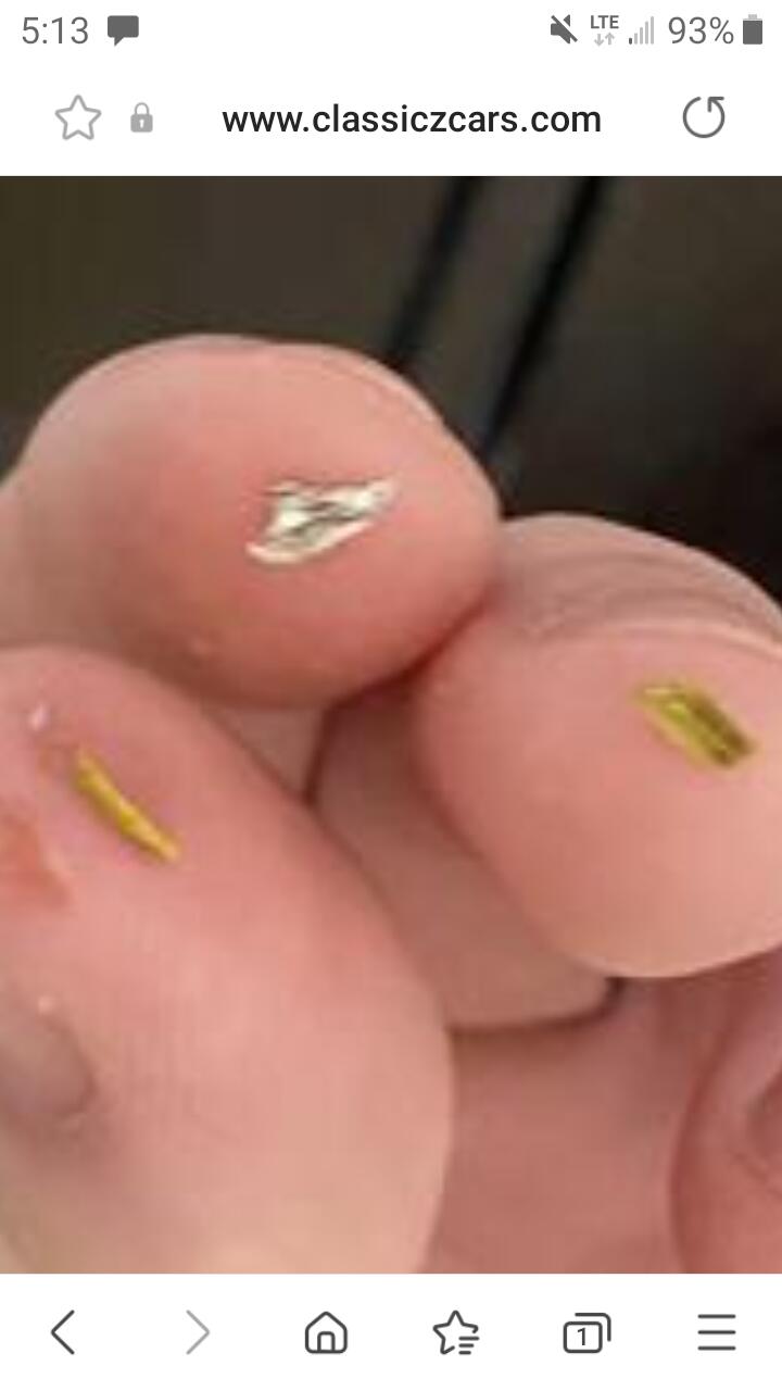

Hi, first time poster here, I found copper flakes in my oil last week, despite having no rod knock. Car seemed to be running fine when I did the oil change. I was wondering if because I found out my bearing was going bad before it had "spun", should I try and attempt to just replace the bearing, whether it was main or rod, and move on? or should I just be looking for a new engine entirely. I took it to a shop for them to look it, and they quoted me at like 6500 at the high-end for repairs. I'm assuming that that's if the damage is extremely bad and pistons/block need to be resurfaced? I don't know where to go from here, so any advice is welcome. Thank you!

Can you post a picture of the copper flakes? Might just be from the washer on the drain plug.
IMG_0121.jpgCar has a N42 Fuel injected L28 with around 136000 miles on it. It was the previous owners first car in highschool, and he bought it from some guy in nevada. I'm assuming he kinda beated on it in HS because there was a lot of shitty electrical work done to it when I got it. Car had some tick but I know these are pretty noisy engines so i never really worried about it too much.
Could be rotting radiator or some type radiator repair flakes.
I'd flush all the coolant out from the block up and through the radiator. Then change oil and filter with cheap Walmart oil and see what comes out after a little driving.
Looks like a rotten radiator to me.

Looks like the silver foil from the top of a gallon jug of oil.  ?
If it is a bearing failing you will hear it eventually.  Measuring cylinder pressures, examining cam lobes, checking timing chain wear...those are the typical things you'd do to determine engine wear.  136,000 miles is not a huge number for these engines.
You're right Zed Head, it does look like foil and my comments on the radiator were knee jerk reaction after seeing them. The radiator doesn't mix with the motor oil. Sorry
I wonder if the front crank gear could cause those brass looking slivers?
