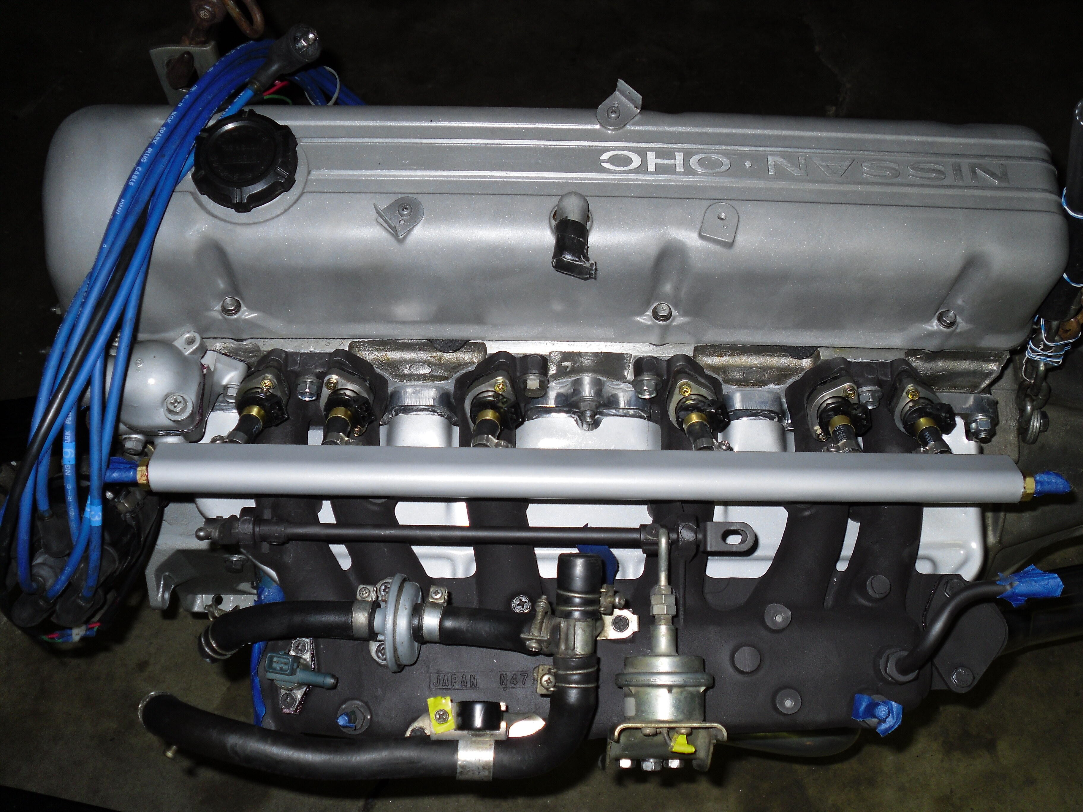

2 minutes ago, siteunseen said:
What's your point?
Thats what i thought!  i can't see any problem in your last topic about your 280z.. we let you do your thing.. helped where we could..

I too removed nearly all of the emissions and "extra" items on my 280. EGR, Cold Start Valve, BCCD, Carbon Canister, PCV system (filters instead), AAR, and also the water temp sensor. I have alot of extra wiring now, but I planned on redoing my harness soon so I just tied them out of the way. I found a good thread on hybridz that listed the majority of the items:
