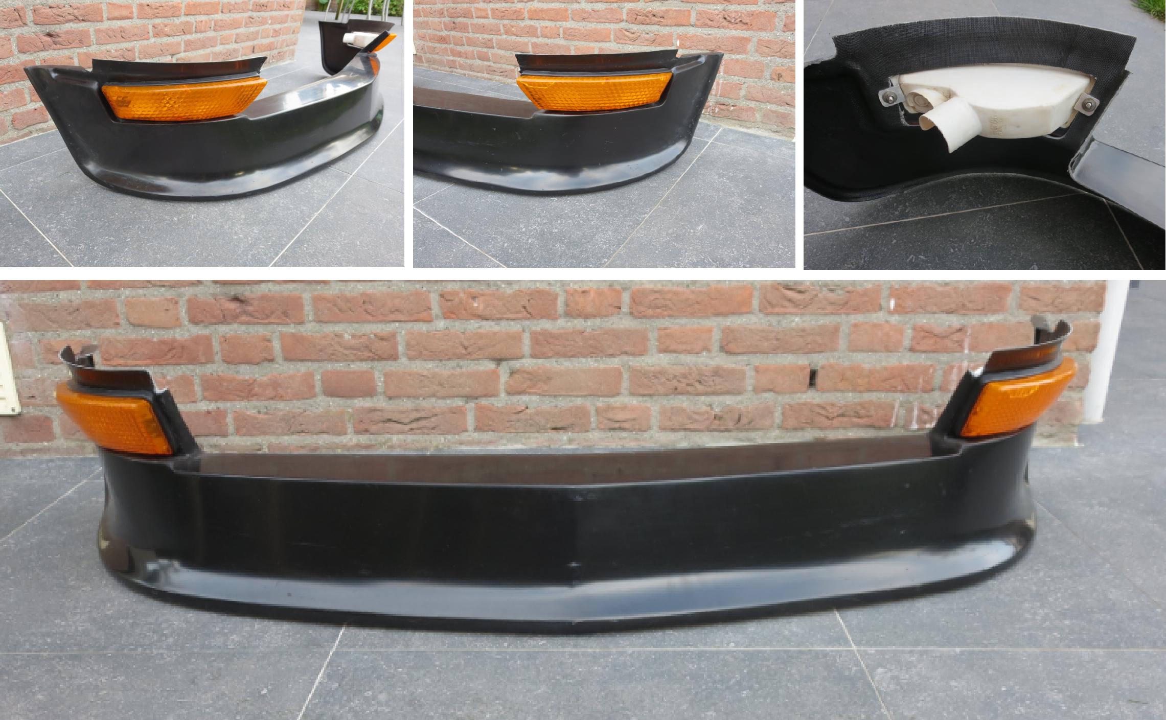

I can't imagine anything but the urethane air dam being able to bend like that without breaking, so I'm assuming that's the urethane air dam. You need to just lay it out in the sun, since they're flexible they tend to fold them up to ship them.

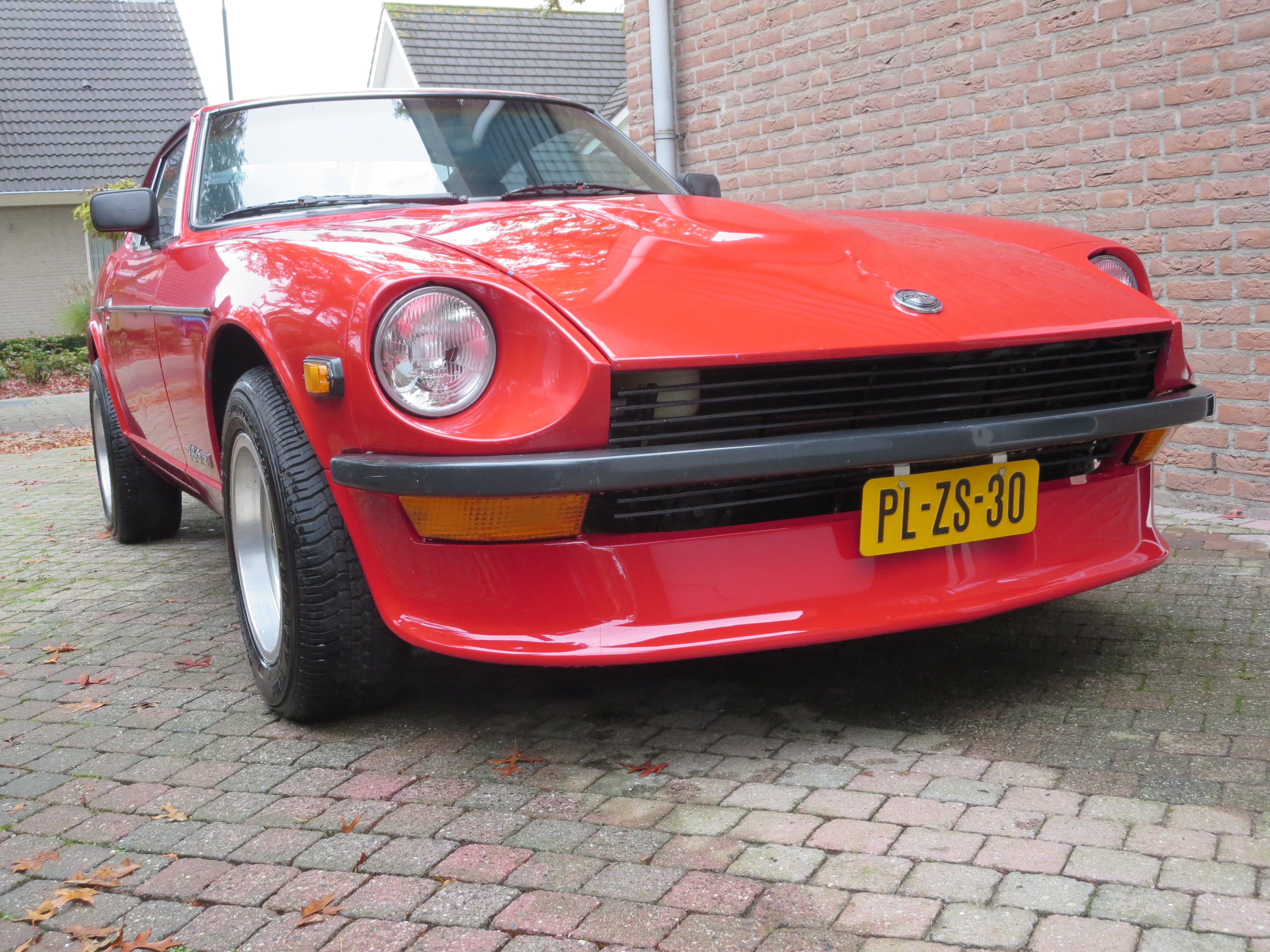

I was all over the place when I started. First tried a 240Z valence, but it is way to high and does not clear the 280Z frame under the larger radiator. Ended up going with the 240Z fibreglas air dam because it is stiffer and self supporting at high speeds. The Xeon PU air dams tend to fold up under the bumper at high wind speeds. You can solve that problem by adding brackets to support the lower edge of the air dam.

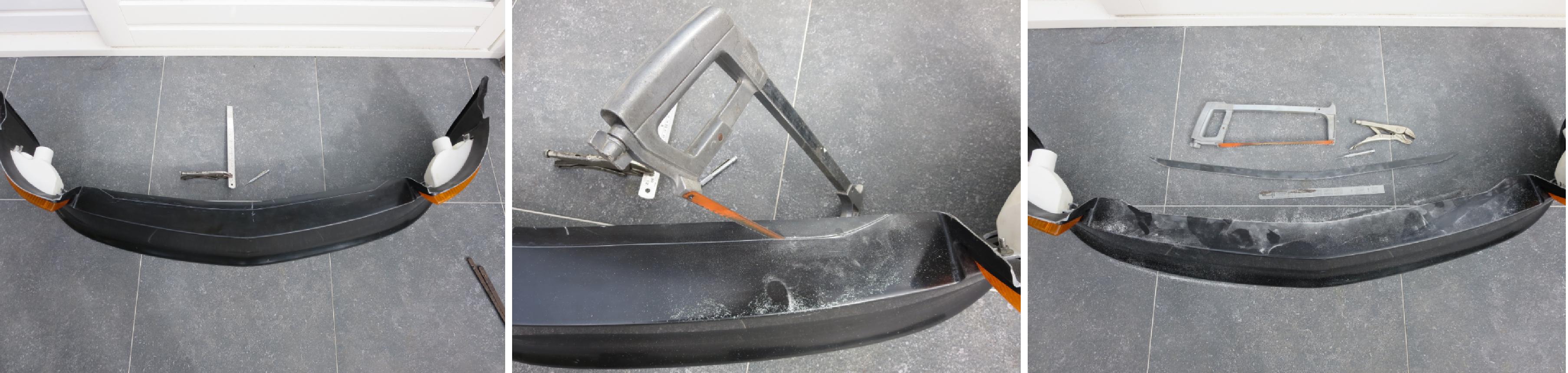

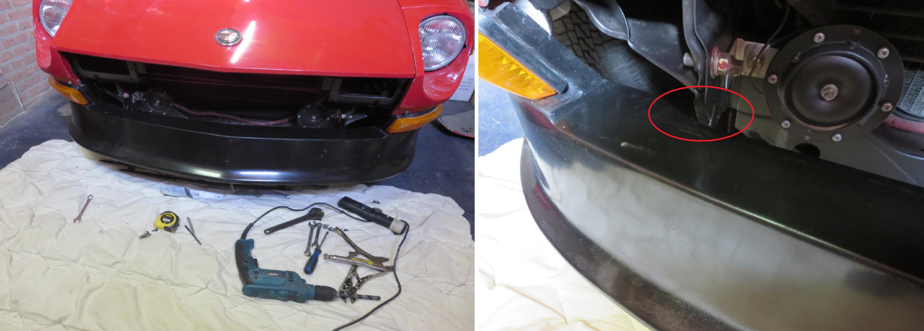

The 240Z version which will need some trimming to fit the 280Z. No big deal and easy to do at home. See Airdam-2 & 3.
The grill is a modified 240Z / 280Z combination with 9 bars instead of the original 240Z 7 bar version.

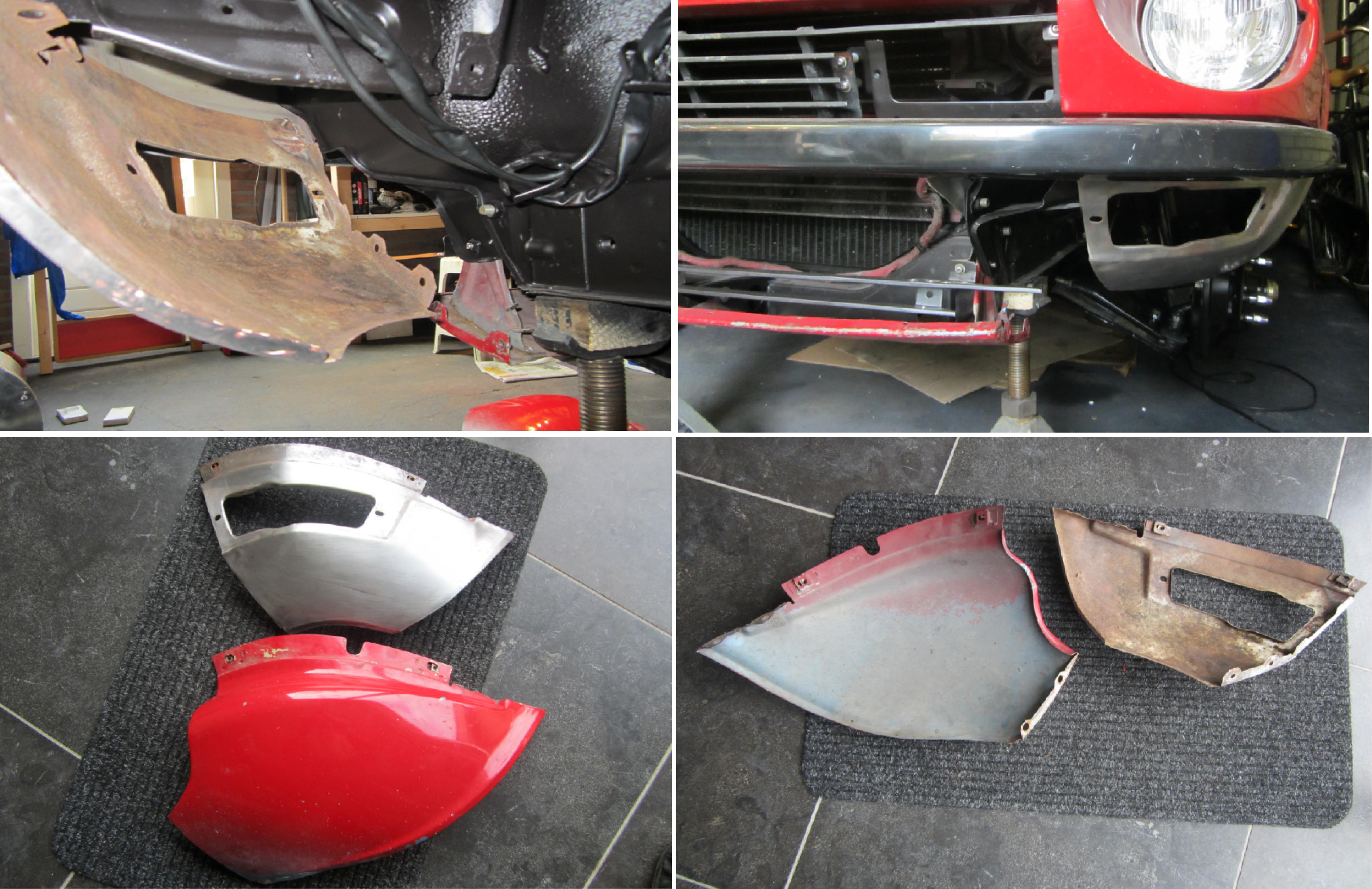

Hi John,
Just reading your remarks on the 240Z valence. The outer sections of the 240Z valence bolts up no problems. The problem is the frame under the radiator. The frame protudes about 25mm under the 240Z valence center section because the 280Z has a larger radiator.
To make it more challenging, the valence normally goes under the support. I played with the idea of cutting out the section of the valence panel around the frame and buying a BRE spoiler and fitting that to hide the frame. In the end I went with the 240Z spoiler, because it had a smaller gap under the bumper and had a little extra ground clearance.

I took the bottom lip thing off before installing the xenon spoiler. Got on the road, ran it up to about 100mph and heard this awful clunking noise. It was the air dam with no support underneath flopping up and down. I put the OE bottom piece back on for support. Worked out great. Now when I go fast my damn wipers start lifting off the windshield. I can live with that though, time to let up before I get a ticket. LOL
Chas, thanks for the information, sounds like it might not be worth it to try the 240z valance. I put the Xenon out in the sun all day and it did unroll but it still looks really sloppy. I just can imagine it looking good. I’m going to see if Xenon will taking it back but I predict they won’t.
