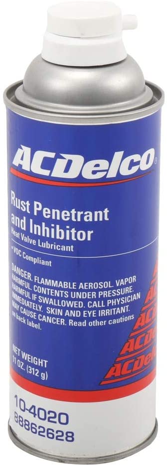

I like this one:
but also get great results with PB Blaster.
