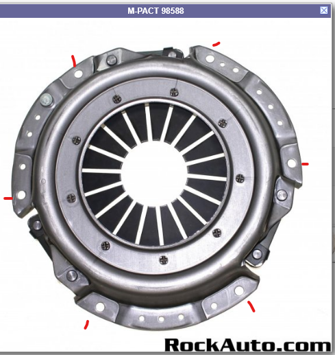

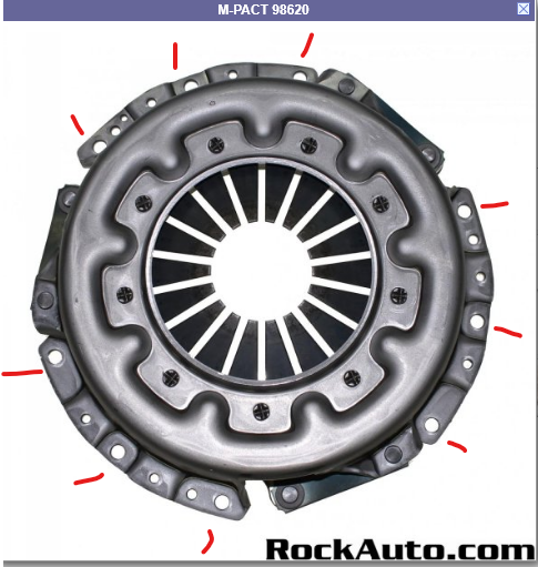

The bolt patterns are different between 225 and 240 clutches.  I think that the Fidanza flywheel might be drilled for either, but if you go with a Nissan flywheel you need to use the pressure plate that matches the flywheel.
p.s. the 225 mm flywheels are almost impossible to find on the aftermarket.  Everybody has gone to 240 mm only.  You can get the clutch kits but not the flywheels.  Something to consider if you find a problem with your flywheel.

Didn’t see it mentioned in the threads above. There are 3 extra bolt locations on the 240mm pressure plate. I had extrasffor my install. Not sure if they are NLA.

Pressure plate. 225mm has 6 IIRC. 240mm has 9. Someone please correct me if I’m mistaken.

No, the patterns are different.  The 240 mm is three sets of three holes, and the 225 is six evenly spaced holes.  You can see it in the pressure plates.  You can't use a 225 plate on a 240 flywheel, or vice-versa.  Edit - this statement might not be correct.  CREATE DO LOOP -
225 (8 7/8")
240 (9 1/2")
240 (9 1/2")
If you are using a Fidnaza flywheel it wont make any difference which pressure plate you use. Both the 225mm and 240mm will fit the Fidnaza flywheel. The 240mm pressure plate has 9 bolts, but I have heard only 6 are used on the Fidnaza flywheel.
