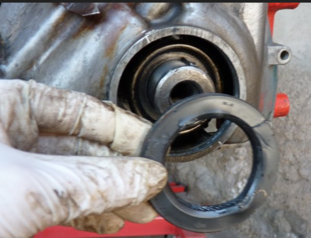

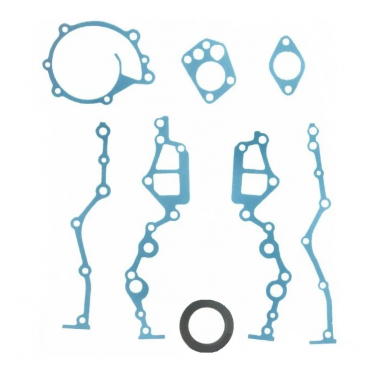

Wally Posted March 2, 2021 Author Share #14 Posted March 2, 2021 I got the cover back on but i cant seem to see where the black O ring goes.... Please tell me its for use only on the 260 or 280. Link to comment Share on other sites More sharing options...
Dave WM Posted March 2, 2021 Share #15 Posted March 2, 2021 that is the front main seal, installs where the crankshaft exits the timing cover. Link to comment Share on other sites More sharing options...
Wally Posted March 2, 2021 Author Share #16 Posted March 2, 2021 gotya. thanks. so i am thinking if gently tap it in here then put on crank wheel with O ring already in? Link to comment Share on other sites More sharing options...
siteunseen Posted March 2, 2021 Share #17 Posted March 2, 2021 Check and see if the gear will fit through the seal. I remember tapping it on the cover then putting the cover on last. After the oil slinger and gear drive. Try some grease or lube on that rubber too. You don't want to tear it. Link to comment Share on other sites More sharing options...
siteunseen Posted March 2, 2021 Share #18 Posted March 2, 2021 Wait a second! You can put the gear drive on then the seal. Is that your motor above? Link to comment Share on other sites More sharing options...
Wally Posted March 2, 2021 Author Share #19 Posted March 2, 2021 ok. thanks. no that was a stock image i found on the internet 1 Link to comment Share on other sites More sharing options...

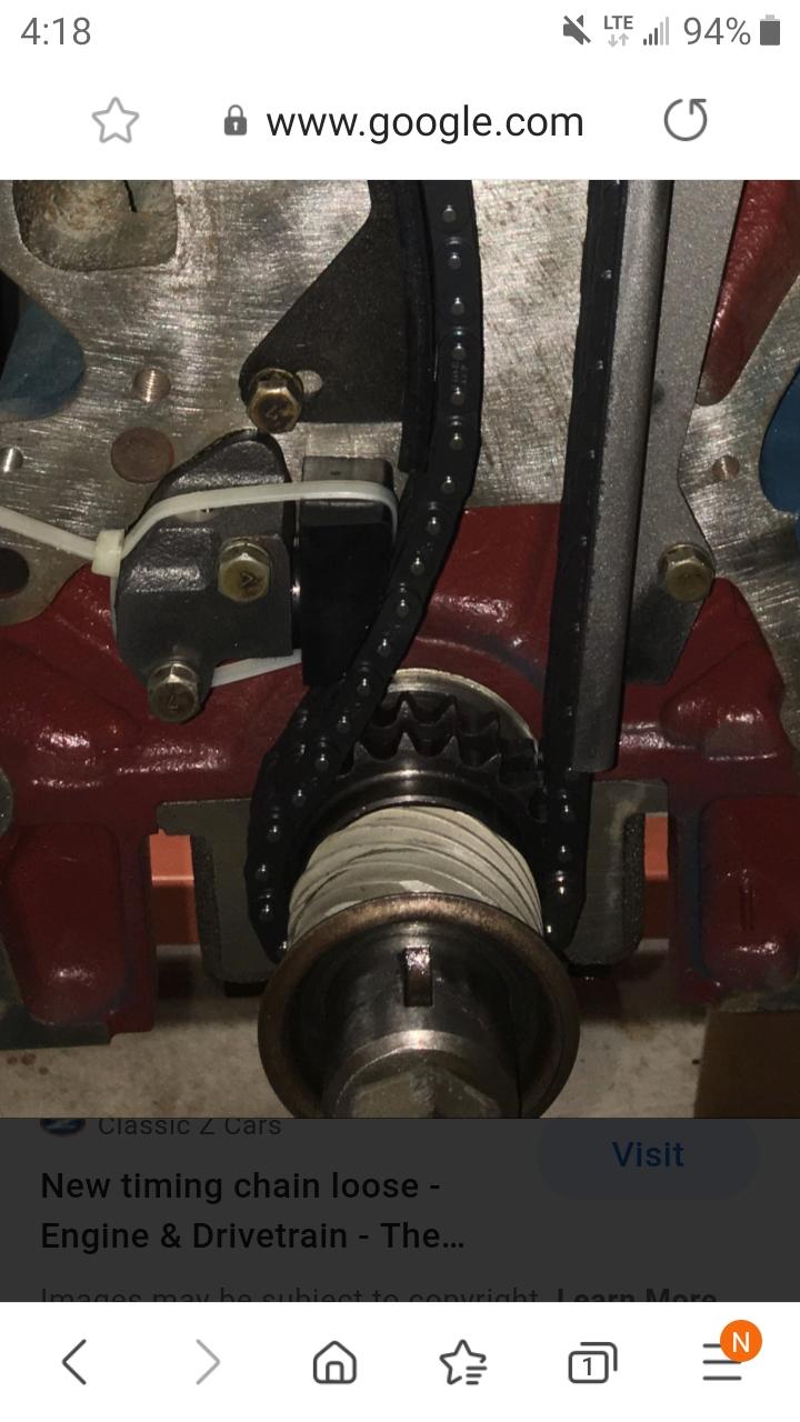

siteunseen Posted March 2, 2021 Share #20 Posted March 2, 2021 I got confused on crank wheel. Here's a web pic too. This is what you should have before the cover with the seal goes on. Sorry for any confusion. Link to comment Share on other sites More sharing options...

Dave WM Posted March 3, 2021 Share #22 Posted March 3, 2021 you keep saying "o ring" there is no "o ring". the timing cover has gaskets and a crank shaft seal. Link to comment Share on other sites More sharing options...

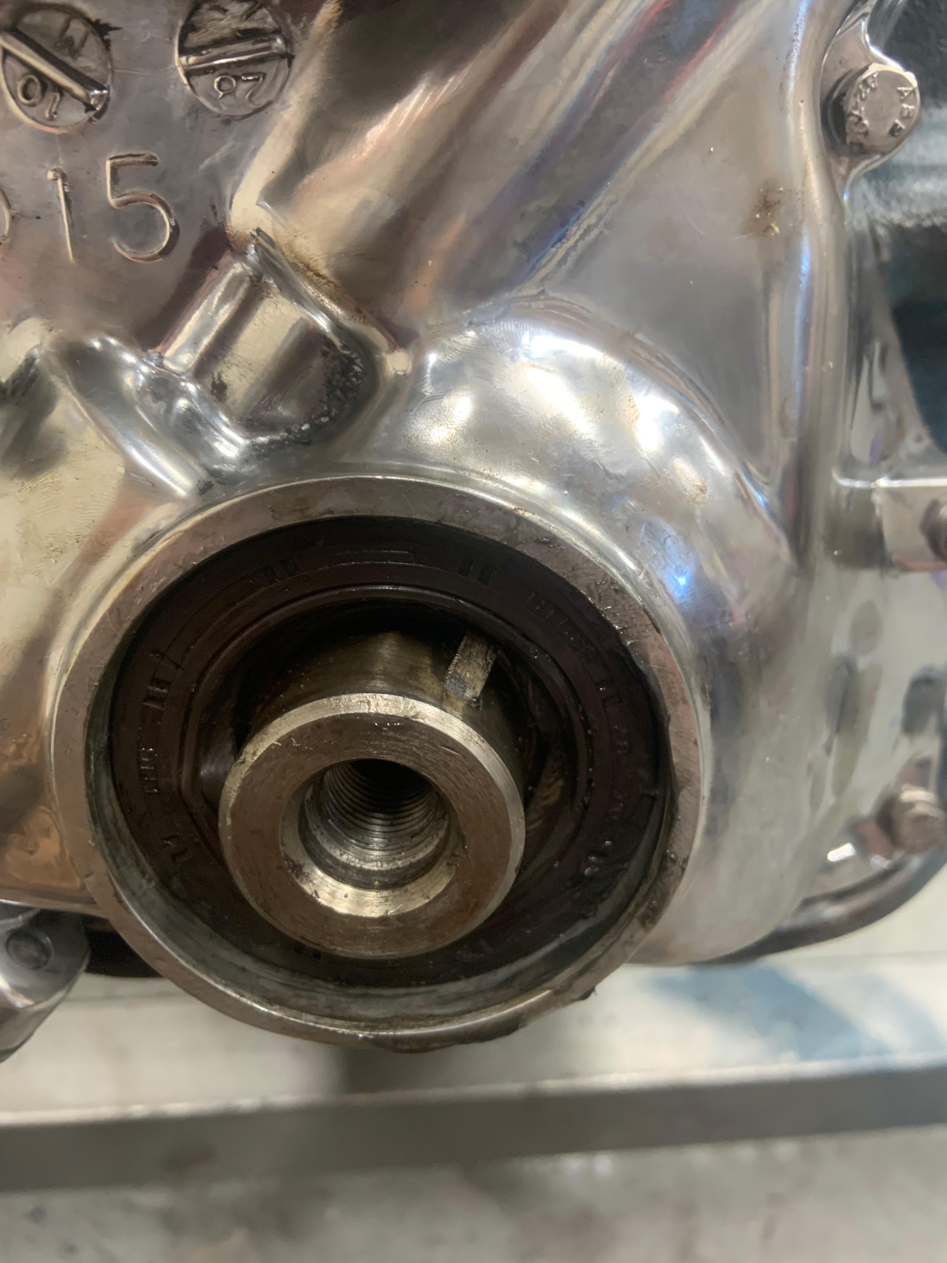

Wally Posted March 3, 2021 Author Share #24 Posted March 3, 2021 heres an image of my work so far. does this look right? The rubber doesnt quite look right to me. I really dont want to take the timing cover and everything back off again.... Link to comment Share on other sites More sharing options...
